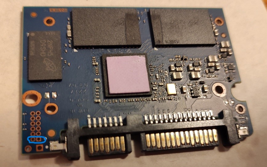

I have a Crucial MX500 2TB SSD that has an SM2259H controller ( silicon motion, from what I could research). I'm not an expert at all , i would say that I'm new to all of this.
The problem is that I had an accident where windows erased all my important and personal files instead of only erasing temporary files. Which i never authorized to disc cleanup just decided to destroy all files in my user folder.
So I need to find a way, without using any fancy electronic adapters, expensive PC3000 or pro electronics knowledge,
how I can stop the SSD controller from erasing information that was accidentally deleted.
I started investigating about ROM MODE, SAFE MODE , FACTORY ACCESS MODE, TECHNOMODE, but the topic is really obscure even on the internet. Little information or hard to find at least by common means.
What i did was, i soon as i realized the disaster I shut down the system and unplugged the SSD say 10 minutes after the incident and never plugged it back into power.
I also think i figured out how to short this drive into ROM mode (I uploaded a photo from here that shows the pin).Image .
what I really need to know is how to force the controller to stop wiping data via garbage collection, trimming and relocation and actually put it into a READ-ONLY STATE state from which rendering or recovery programs can be run.
Is there any software/tool ​​that can help me with this task?. i Started to investigate about MP tools. Should I keep the ssd in factory mode/ rom mode/ techno mode/ during the entire imaging process? is it just about keeping the short in there while doing to imaging or is there something else i have to do?. In other words, how do you make sure that all background processes associated with trimming or garbage collection/redistribution of cells will be stopped when cloning or restoring from disk? Do I need to change the SSD firmware to stop this, if so how do I do it?

Best way to assure it does no background tasks like garbage collection is by disconnecting the drive from power.
AFAIK, any kind of techno or factory mode wil prevent you from imaging the drive, you will not have access to the NAND.
MPtools should be avoided IMO, they're more likely to destroy your data.
To have a fighting chance, you'll need PC3000 AFAIK.

I'm not aware of any DIY solution for your controller, but here is a solution for an SM2258XT SSD:
https://www.hddoracle.com/viewtopic.php?f=106&t=3238
It won't be of any use to you, but it does give you an idea of what needs to be done.
BTW, I believe that the ROM mode shorting points are the two larger pads immediately below the ones you have circled.
