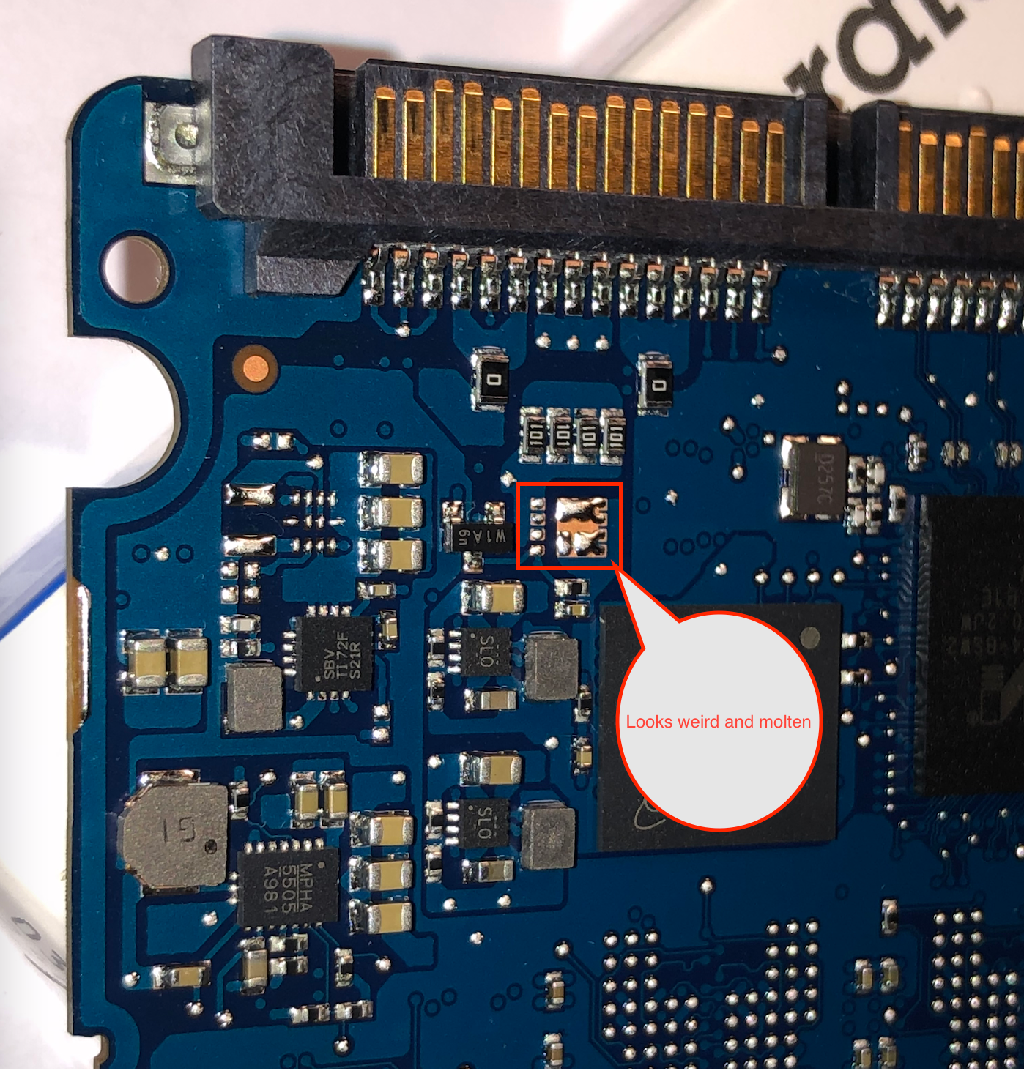

I inspected the PCB but everything looked fine (beside once again I'm a noob, the circuits are shiny, no sign of oxydation) and I read the [Crucial MX300 - No SATA connection] topic from outbreak198x and fzabkar. [https://forum.hddguru.com/viewtopic.php?f=10&t=42258&hilit=mx300]
And today I realized that the "MOSFETLoadSwitch" of my PCB looked pretty melted comparing with the ones on fzabkar pictures.
I tried to find good resolution pictures of the MX300 250gb PCB and datasheets but I just found blurry ones.
So this is what it looks like on mine :

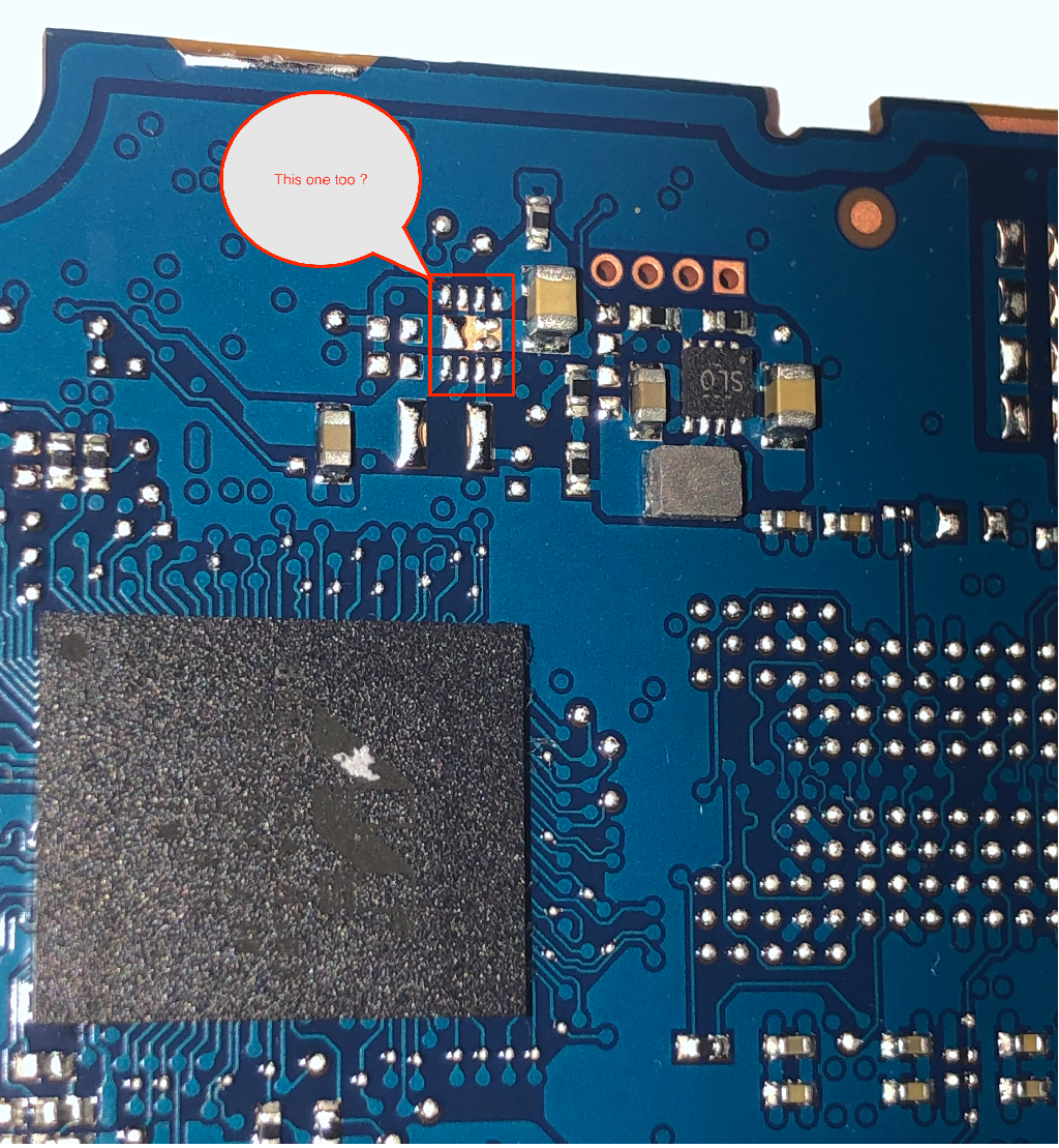

And by inspecting it closely I found this other MOSFET soldering (i think) to be suspicious :

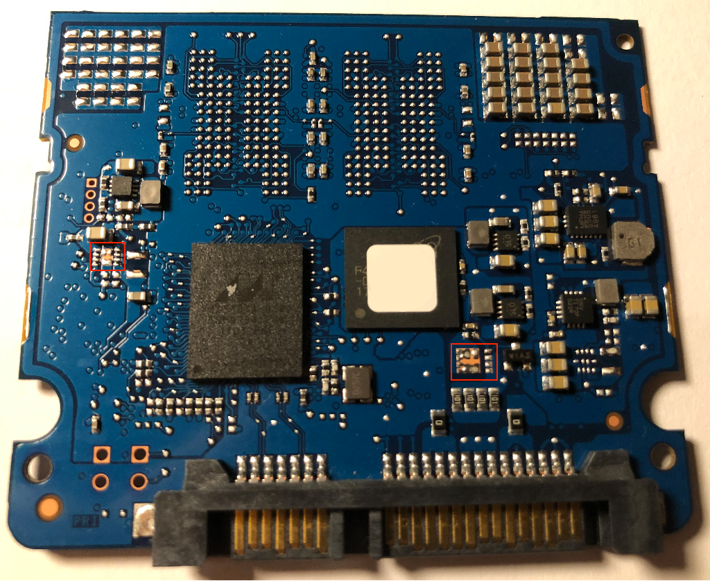

These are the top and bottom of the PCB :
Top : Image
-> I'm not sure which components could be involved and I didn't found the SSD datasheet on the web, outbreak198x and fzabkar topic is the most detailled thing I got into :)
Bottom : Image

the so called molten parts are just fine, they weren't fit by the factory, so those are not the ones you need to worry about.
Check the 0 ohm resistors near the power connector and the buck converters for their output (one terminal of the inductors is supposed to be connected to filter caps near it, that's the output). Check the supply lines for shorts (at the filter caps, without applying power), then for supply voltages at the same places with attaching sata power.

Often a PCB designer will implement optional components. These may be left unpopulated depending on the application or client. The first unpopulated "load switch" has a MOSFET bridging those same connections on the other side of the board.
