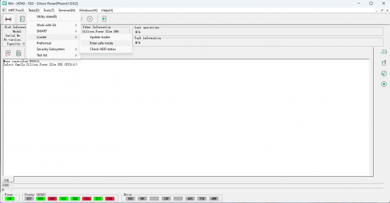

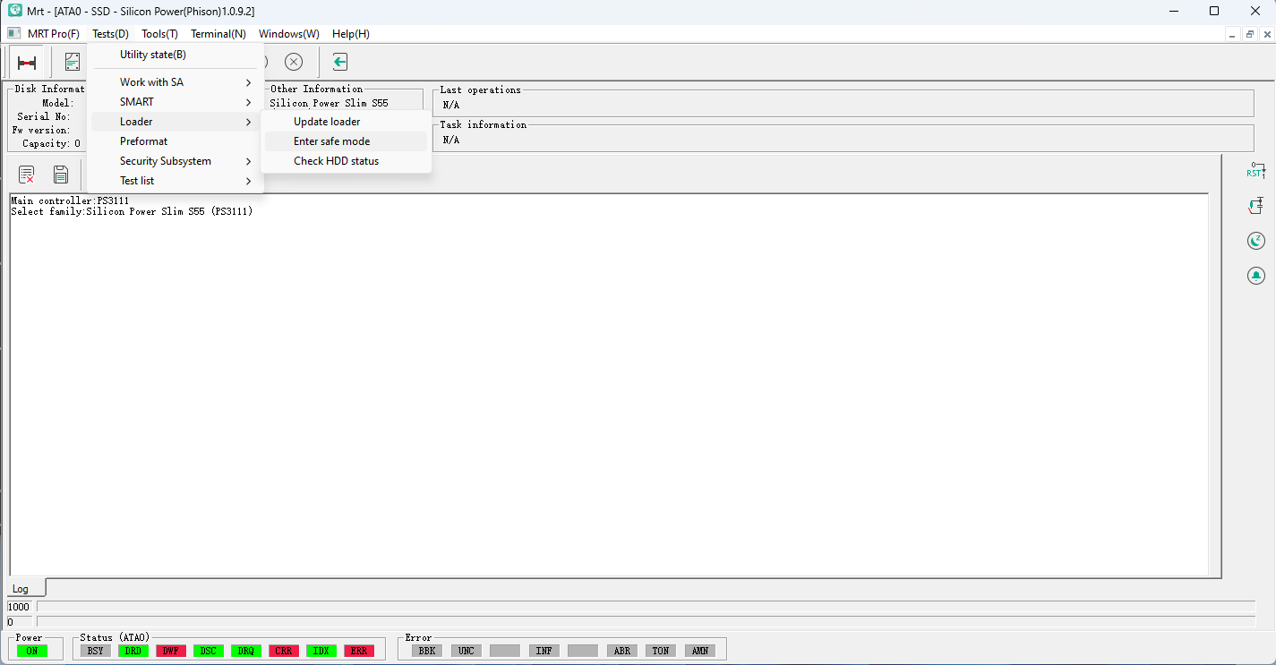

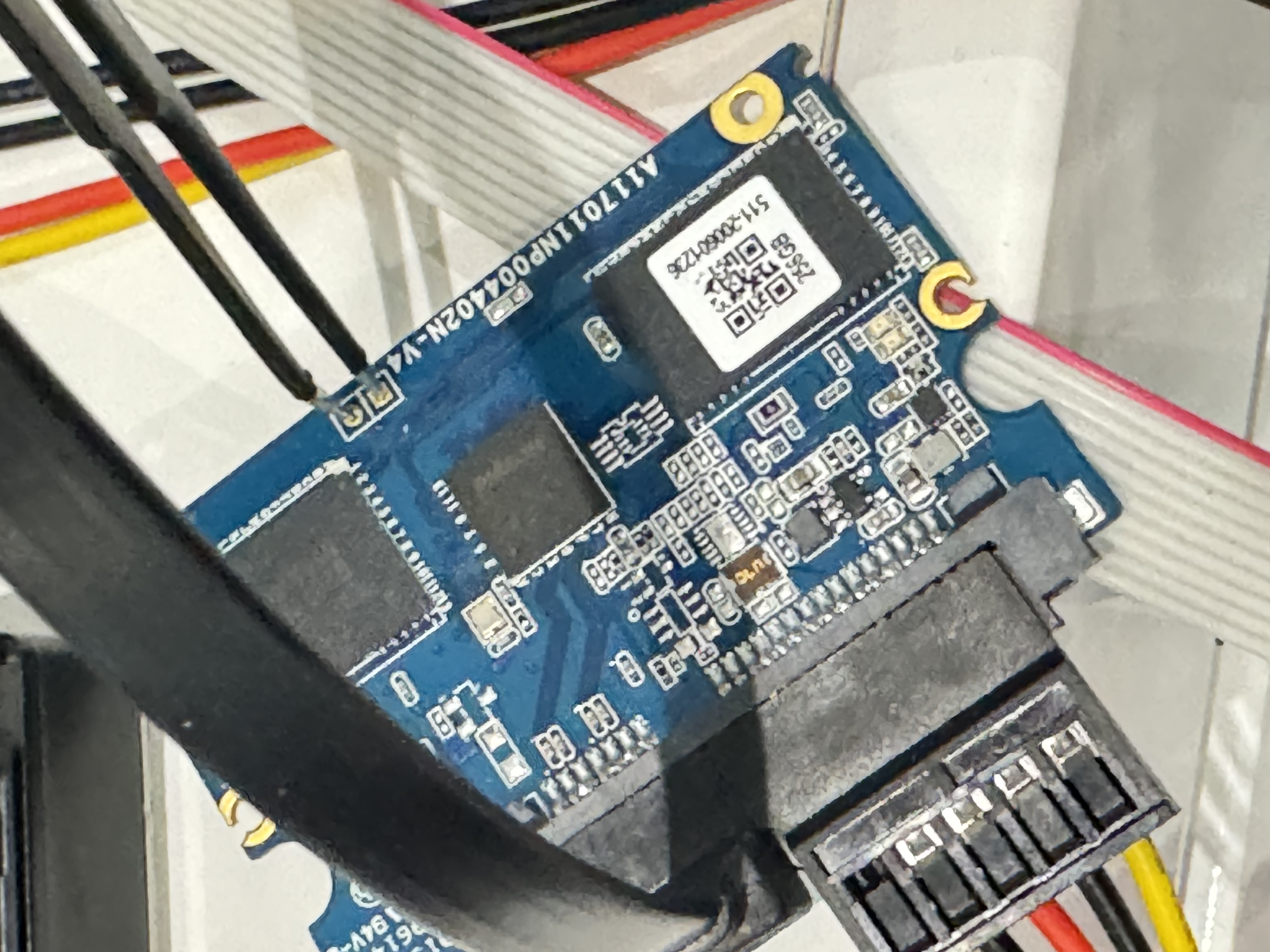

Hi i have Silicon Power S55 with SATAFIRM S11 Error
im trying to boot this drive in save mode via MRT (short two pins on PCB) but disk is not ready
what am I doing wrong ?

Try to not short anything, power on the drive and enter the utility...does it work? Or it goes to BSY state?

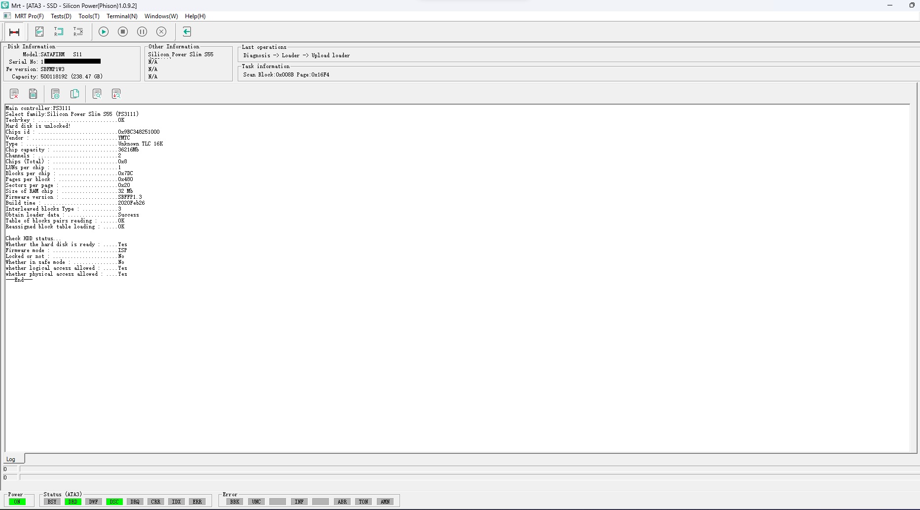

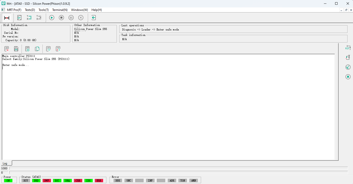

pins not shorted
and nothing more, unfortunately
 Post subject: Re: SP S55 - SATAFIRM S11
PostPosted: May 29th, 2024, 4:11
Posts: 17215
Check the 3 supply voltages. Perhaps a missing NAND Vcc supply might produce the same symptom???

Ok. Show us the same screenshots but this time with pins shorted.

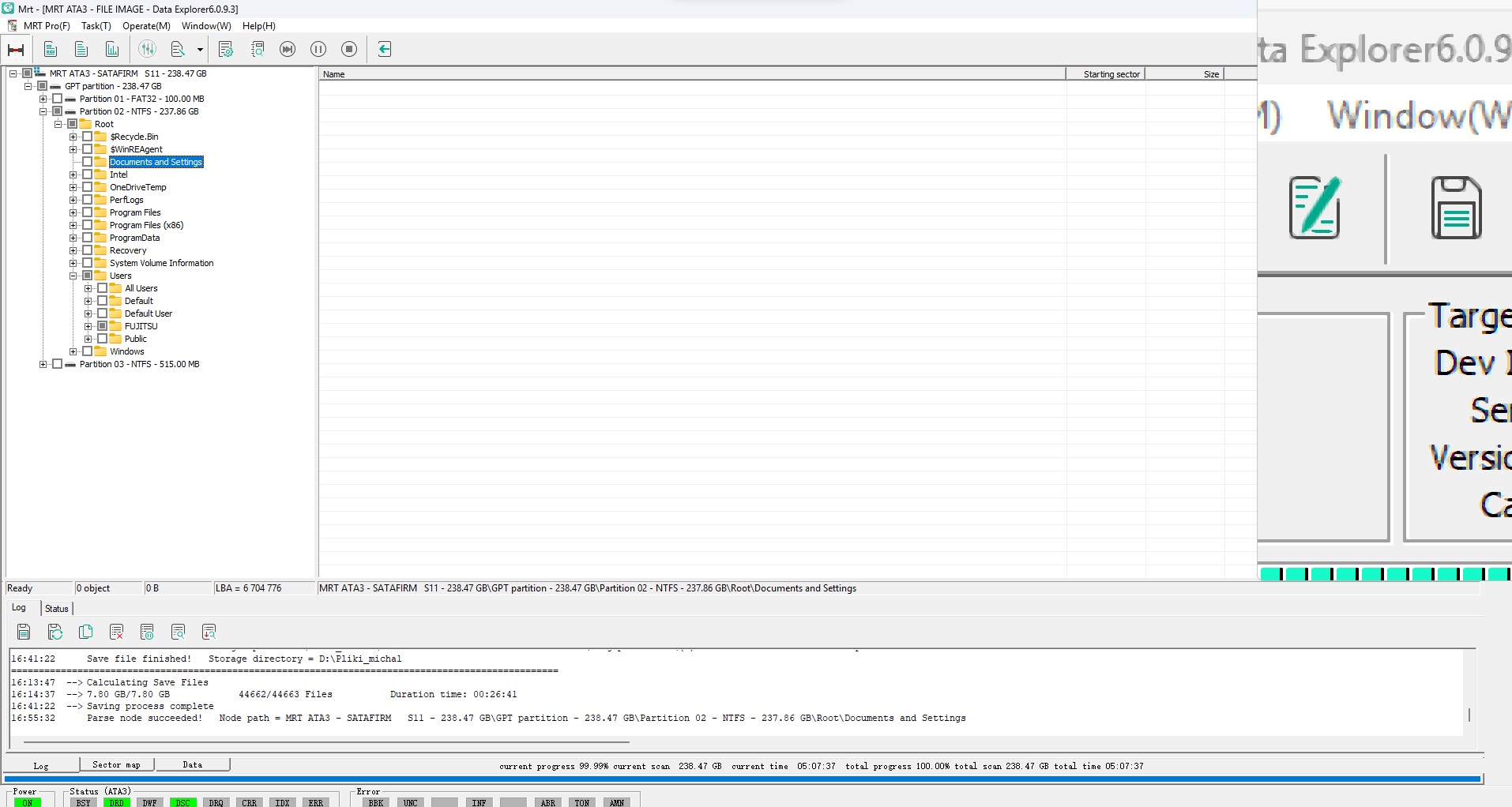

wittout shorting i see this
PostPosted: August 26th, 2025, 16:15
Joined: November 5th, 2015, 18:00
Posts: 81
Location: in the lab
Create the translator at this point and in the DE use "Read form active MRT Utility" as normal.
VEXUS Data Recovery
PostPosted: August 27th, 2025, 11:01
Joined: September 13th, 2023, 5:53
Posts: 88
100% sucess, thanks a lot !
