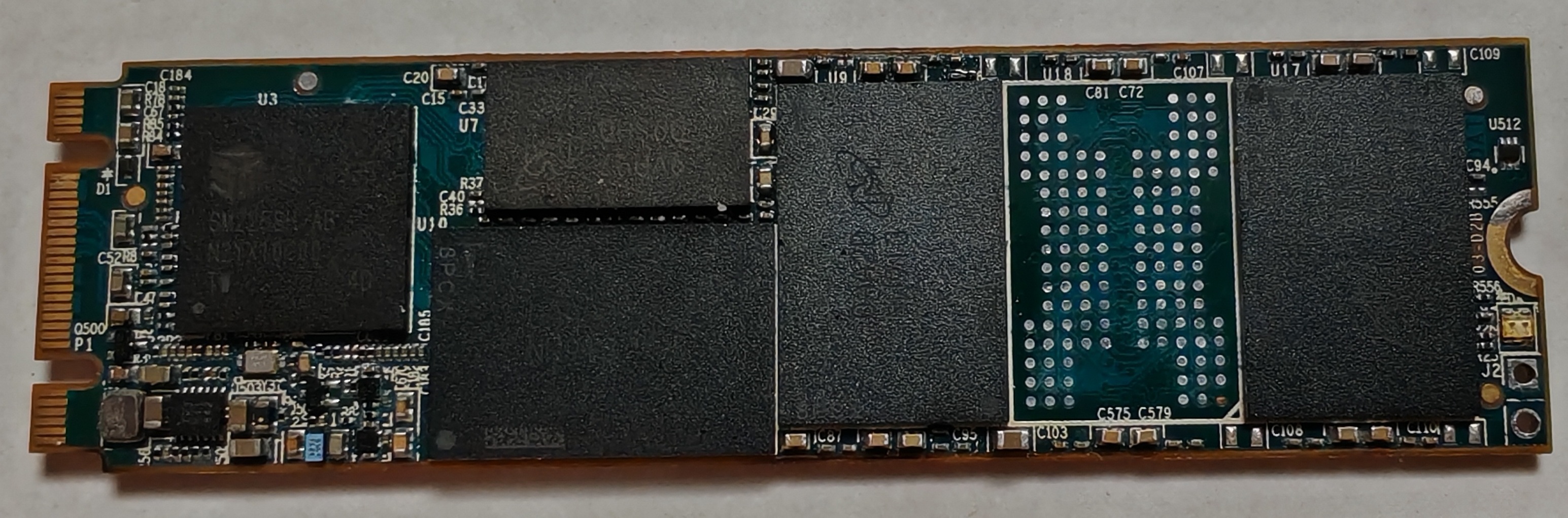

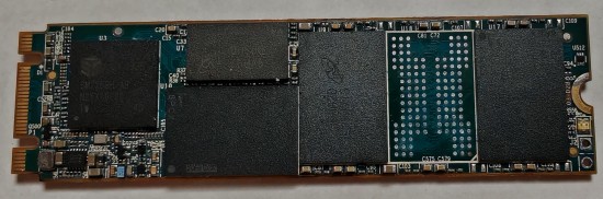

Hi all,
I have an Crucial MX500 1TB that suddenly becoming not detectable by BIOS after laptop (BSOD) crashed during Windows update.
Model: Crucial MX500 1TB M.2 SATA NGFF
Brought date: 20200926
Health (last known 2025/03/20): 96 %
SMART shows drive as healthy
Controller: SM2258H
DRAM: D9SHD X 2 (MT41K256M16TW-107:P)
Nand: NW913 X 8 (MT29F1T08EMHAFJ4-3R:A)
File comment: SSD Front/Top side

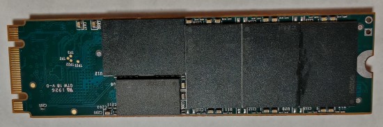

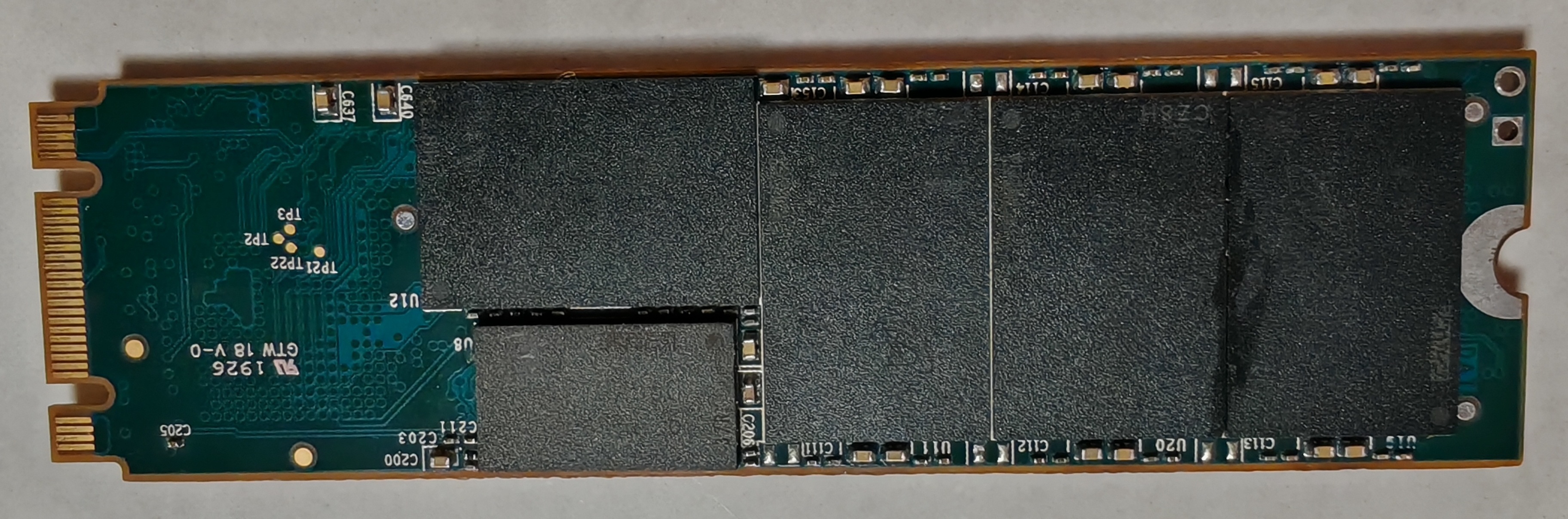

File comment: SSD Back/Bottom side
Troubleshooting NAND chip numbering as follow:
    - Top (T) side (with controller) - First NAND is beside DRAM with forth (last) beside test pin.
    - Back (B) (Bottom) side (without controller) - First NAND is beside DRAM with forth (last) beside test.

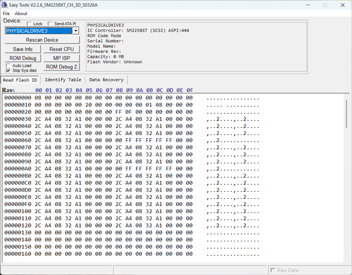

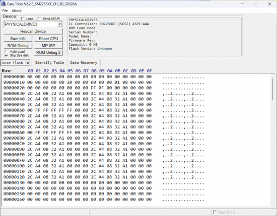

Using Easytools with test pin (ROM mode) shorted manage to forced the drive to ROM mode.
From Easytools tab (Read flash ID) address location (Raw):
    - From 00000060 to 00000120 should have device ID available (2C A4 08 32 A1 00 00 00) for first and second column respectively.
    - But 00000060 and 000000A0 first column device ID is not identified (00 FF FF FF FF FF 00 00).
    File comment: Device ID with all NAND soldered

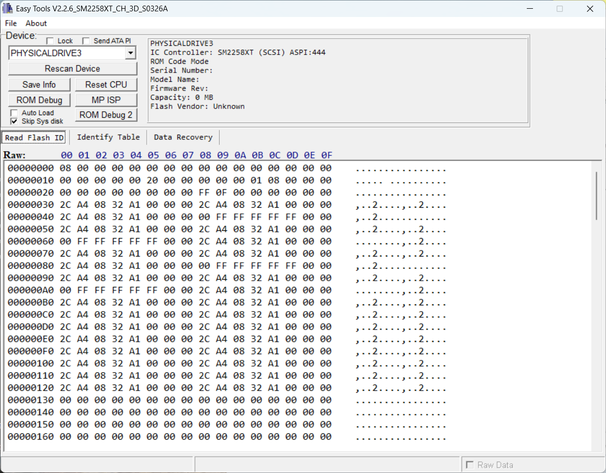

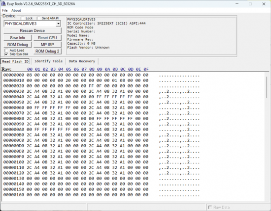

    - By trying NAND removal procedure, it has been found that NAND chip (T no. 3) to be the culprit.
      - Each NAND chip has four device ID
      - Removing good NAND chip should cause additional four device ID not identified that would be 6 in total.
      - Removing NAND chip (T no. 3), four device ID is not identified has appeared on (00000040 and 00000080) second column alongside (0000060 and 000000A0) first column.
      File comment: Device ID with faulty NAND (T no. 3) removed

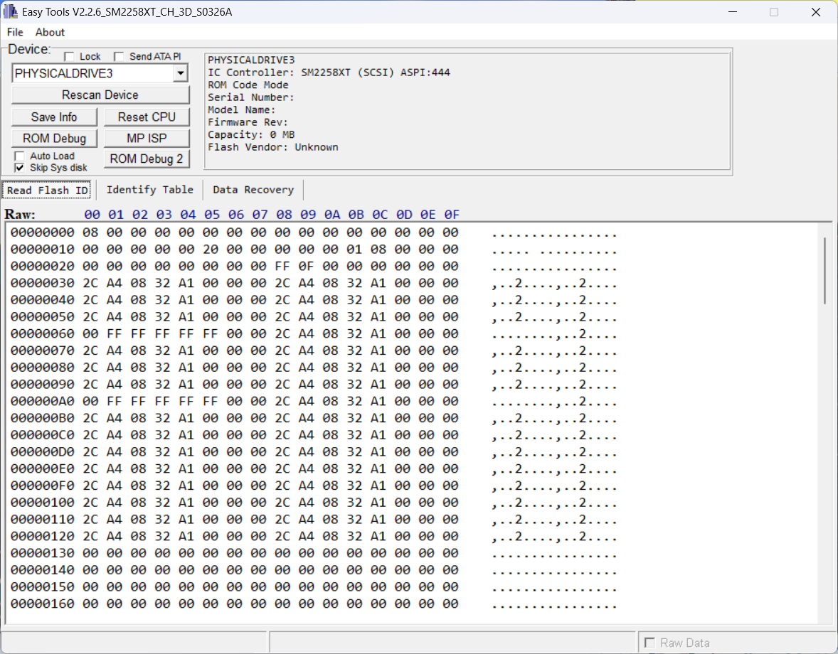

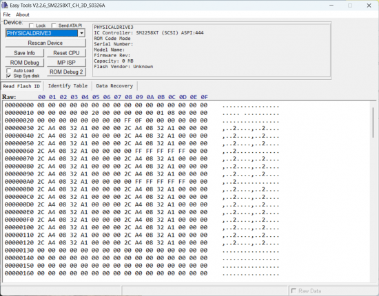

      - By swapping (T no. 3 and T no. 4) NAND chip location has also shifted not identified device ID from (00000060 and 000000A0) first column to becoming second column. This shows chip is the culprit and not solder joint/pad.
      File comment: Device ID with NAND (T no. 3 & T no. 4) swapped
From the picture taken, Top side third NAND (T no. 3) has been removed.
