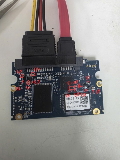

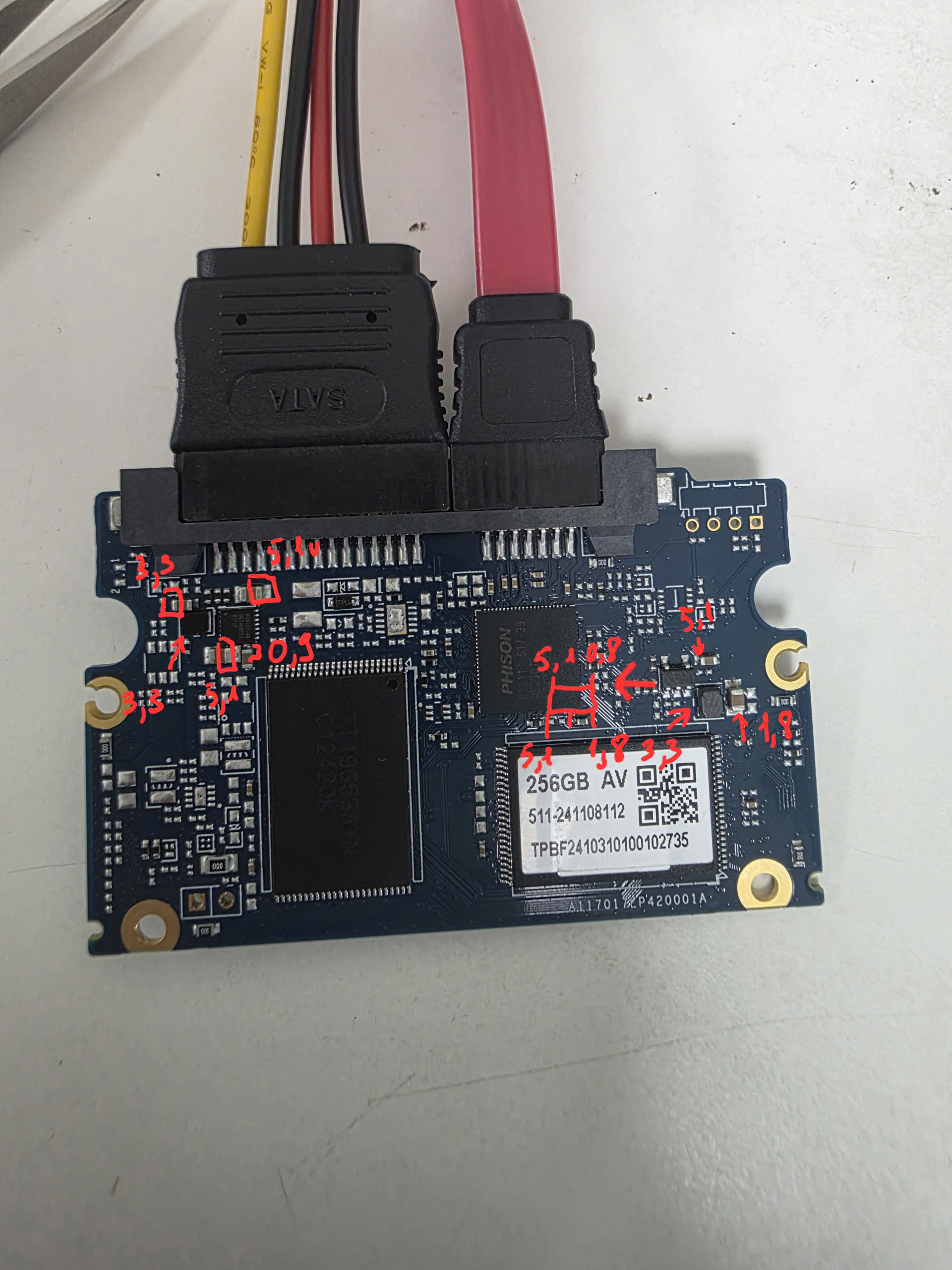

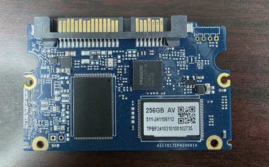

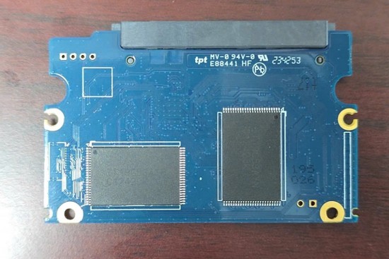

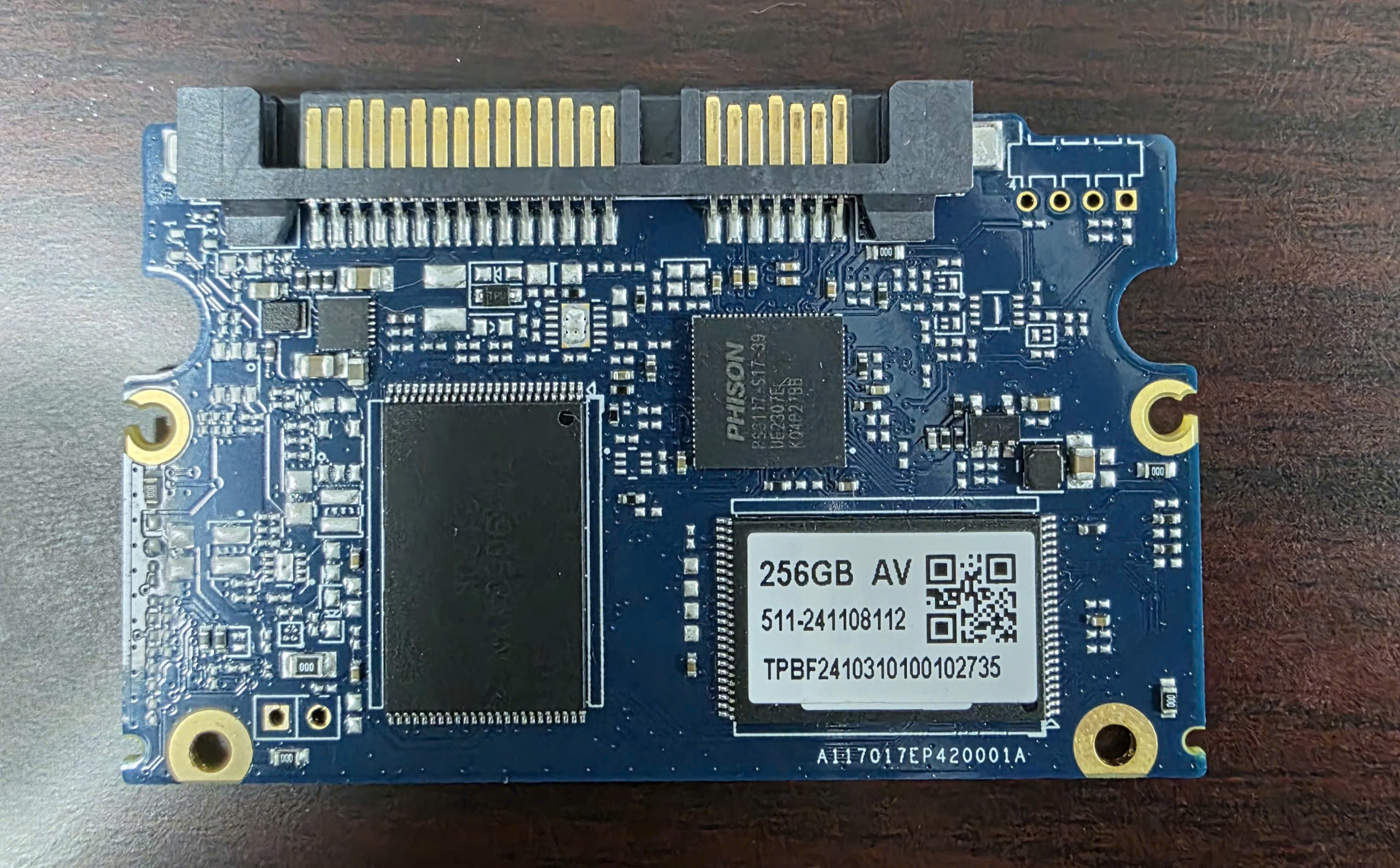

I have this SSD with Phison PS3117-S17 Controller that tested on PC3000 gives all lights like a crhistmas tree. Which I believe the SSD is shorted. However i cannot seem to find where the short is.
Can you guys help me out! Many thanks!
SSD
z7307173613688_d72a0c1394680bdc85f70c6682b987d5.jpg [ 877.82 KiB | Viewed 2988 times ]
z7307178271863_0f80b17acb68cfd85a005ce40f90c0bc.jpg [ 679.69 KiB | Viewed 2988 times ]

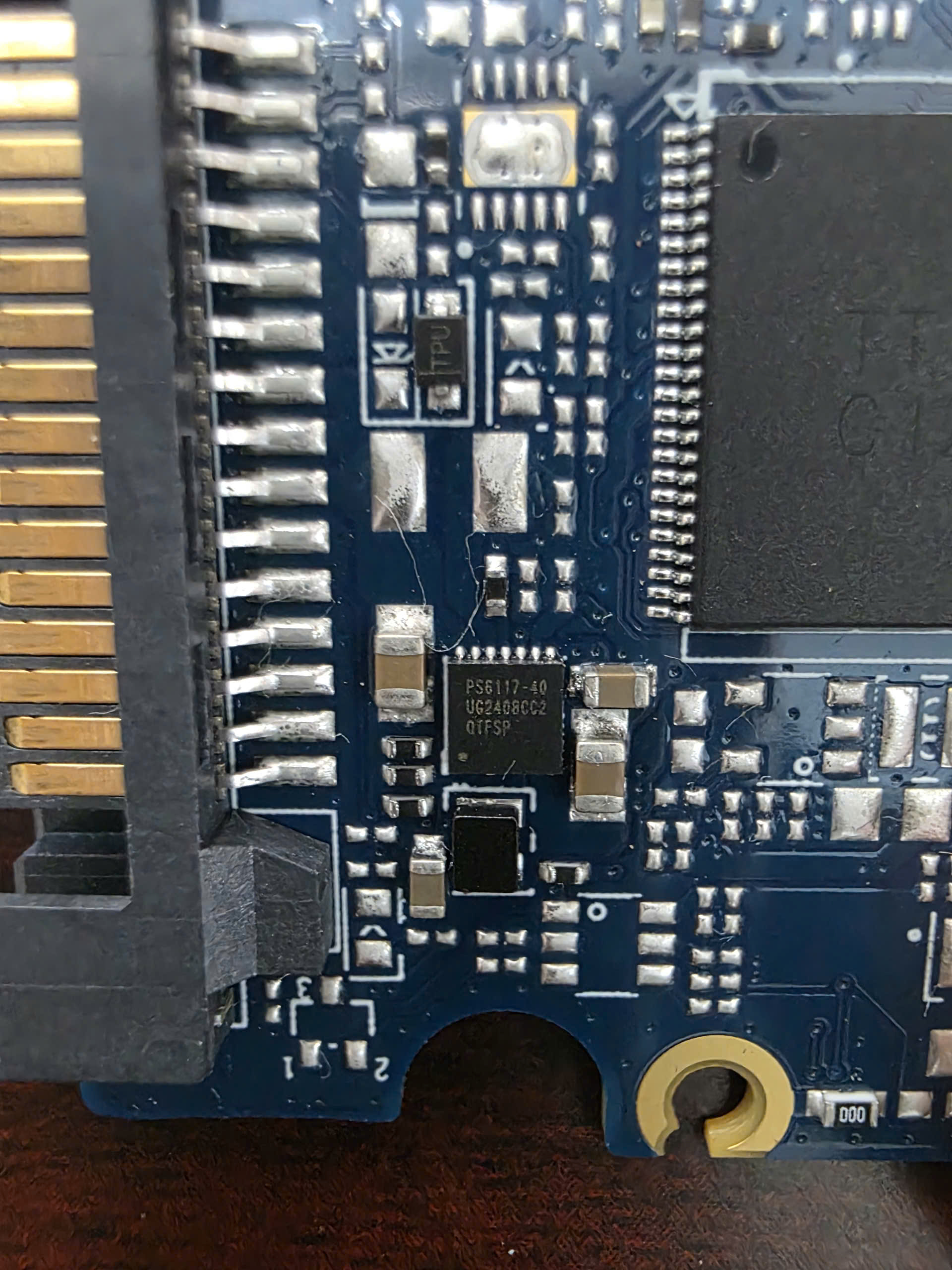

Voltages
z7307168369897_f700c218903f601cbdaa228d8db929b0.jpg [ 568.58 KiB | Viewed 2988 times ]
Many thanks!

5V is present at the input, and 3.3V and 1.8V are present at the outputs. Where is the Vcore supply for the controller? That should be around 1V. Could that be the 0.9V I can see at the PS6117-40 PMIC?
Can you point out where can i measure Vcore??
 Post subject: Re: PS3117-S17 help me find the shorted component
PostPosted: December 8th, 2025, 22:26
Posts: 17335
Sorry, your reply crossed with my edit. The PS6117-40 PMIC has 1x buck converter and 1x LDO regulator. Perhaps 0.9V is the LDO output for the Vcore supply, in which case there do not appear to be any shorted supplies.
Is there anything on the other side of the PCB? I can't believe that Vcore can be supplied by a puny LDO.

Location: Vietnam

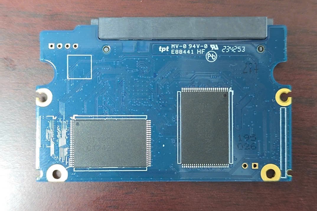

There is nothing on the other side

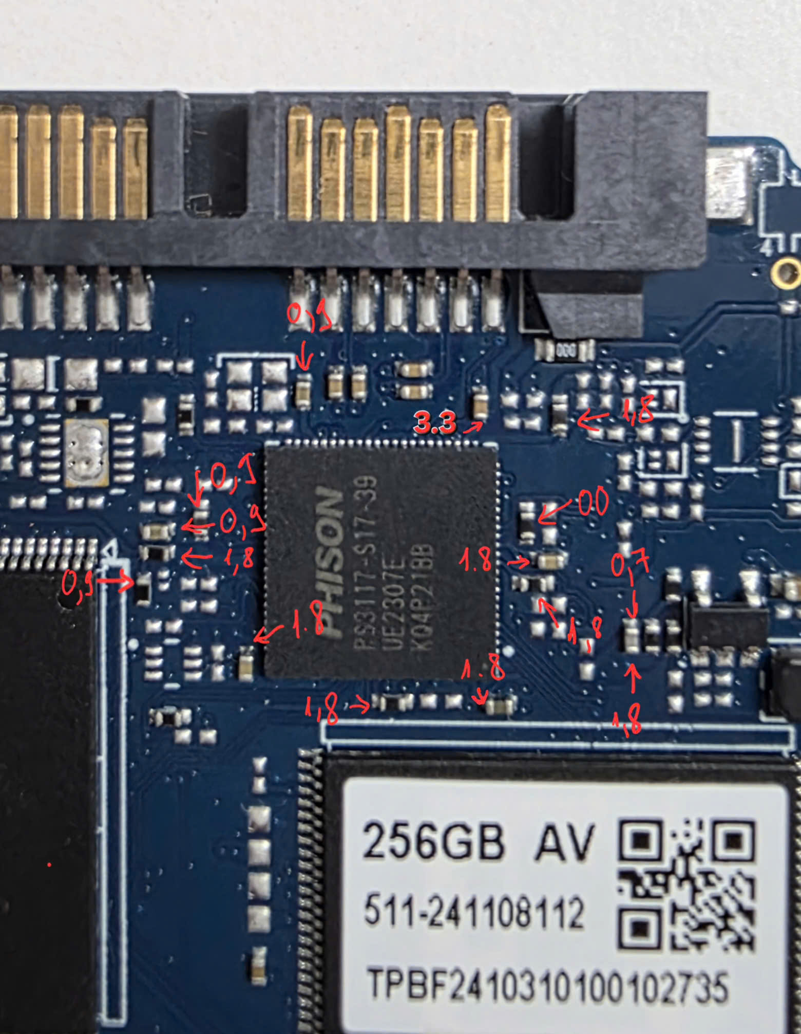

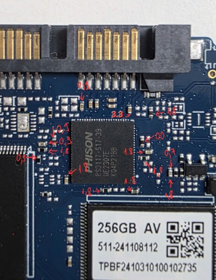

Measure the voltages on the tiny bypass capacitors around the controller. You should find Vcore and Vio.
PostPosted: December 8th, 2025, 23:32
Posts: 267
Location: Vietnam
Here are the voltages around the controller
z7307600832287_737539726f07aa4a085270549adcd705.jpg [ 474.88 KiB | Viewed 2973 times ]
PostPosted: December 8th, 2025, 23:41
Posts: 17335
All looks good to me. It looks like this is the cheapest possible configuration.
