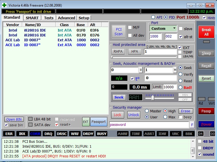

Victoria 4.46b gives me [ATA protocol] DRQ!!! Press RESET or restart HDD!
Victoria 4.43 gives me Waiting of readiness... Drive not ready!
Tried resting, restarting and even a known good hard drive, Same result. Tried the two ace ports that showed up.
I think we might need to buy Data Extractor.

Spildit wrote:
Make sure that you have Victoria in PIO !
Yep, I did.
Its an Intel motherboard.
Spildit wrote:
Try this :
