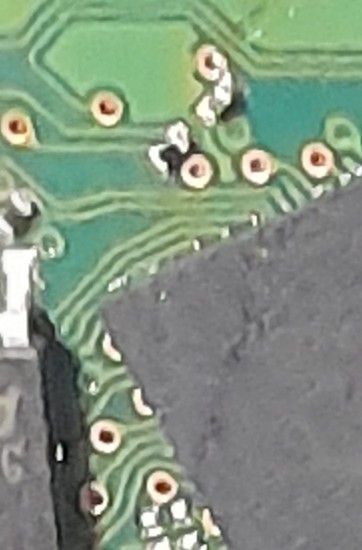

 Post subject: Wd charger pcb with broken pcb and mcu.
PostPosted: June 16th, 2026, 1:49
Joined: March 21st, 2009, 14:53
Posts: 59
Location: Malta
A wd charger 2 TB come from customer with fisically broken pcb and MCU :|
Rom is good.
Is data recovery still possible?
Thanks in advance for help and advices
 Post subject: Re: Wd charger pcb with broken pcb and mcu.
PostPosted: June 16th, 2026, 4:45
Posts: 130
What happened to the MCU?
smecca wrote:
Is data recovery still possible?
We don't know, but the easiest way is to check...
 Post subject: Re: Wd charger pcb with broken pcb and mcu.
PostPosted: June 16th, 2026, 8:48
Joined: March 21st, 2009, 14:53
Posts: 59
Location: Malta
Hi, thank for you reply
Customer tryied a diy usb port repair. Badly badly done. It ended xracking pcb along usb port side, cracking an angle of mcu.
File comment: Mcu part view
20260616_143741.jpg [ 127.52 KiB | Viewed 868 times ]
 Post subject: Re: Wd charger pcb with broken pcb and mcu.
PostPosted: June 16th, 2026, 9:10
Posts: 130
The quickest way is to replace it with a compatible PCB and check if the encryption is active.
Are you sure it's a crack?
 Post subject: Re: Wd charger pcb with broken pcb and mcu.
PostPosted: June 16th, 2026, 11:14
Joined: March 21st, 2009, 14:53
Posts: 59
Location: Malta
Pretty sure. Later i will desolder the die to inspect downside and pads conditions
Already tryied to use alternative compatible pcb (usb 800067) and hdd is ok, spins, ready state, sector edit:encrypted. If it is encrypted via usb i thing noway using full conversion procedure
 Post subject: Re: Wd charger pcb with broken pcb and mcu.
PostPosted: June 16th, 2026, 14:43
Posts: 1741
Location: Verona, Italy
Try to contact einstein9, maybe he knows how to crack key on this drive
https://forum.hddguru.com/viewtopic.php?f=13&t=45608
My firmware database:
 Post subject: Re: Wd charger pcb with broken pcb and mcu.
PostPosted: June 16th, 2026, 17:17
Posts: 4755
it was not even mentioned which version it was (no model number, anything). If it is an old model, pcb swap is possible. Let's hear some more info about the drive, pls.
