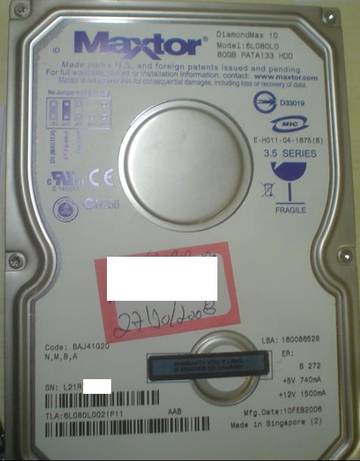

 Post subject: Re: LDR Maxtor 6L080L0 needed
PostPosted: October 30th, 2008, 8:52
Posts: 1060
pcimage wrote:
More info required!
Ok, my friend!!

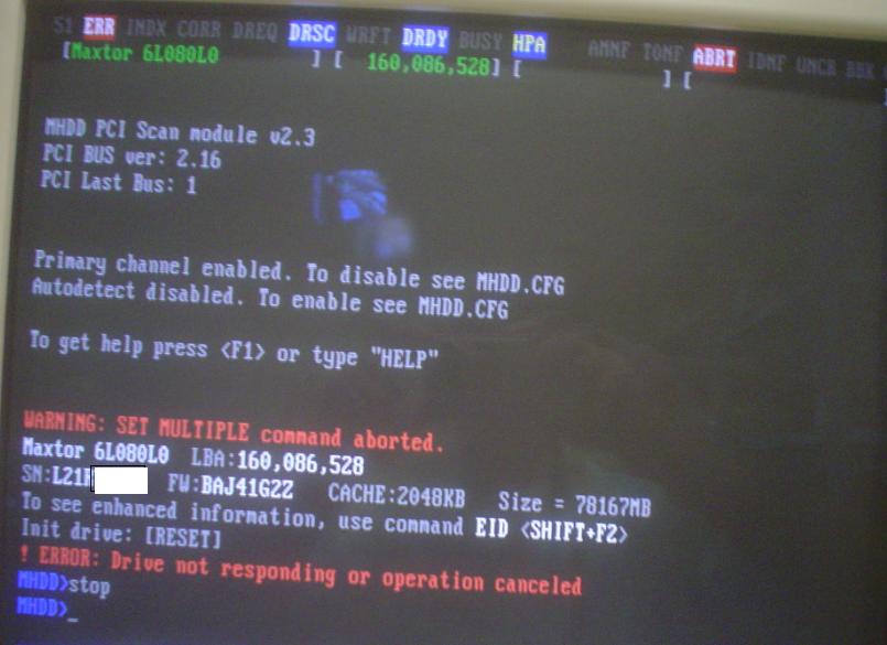

PostPosted: November 13th, 2008, 13:37
Posts: 1060

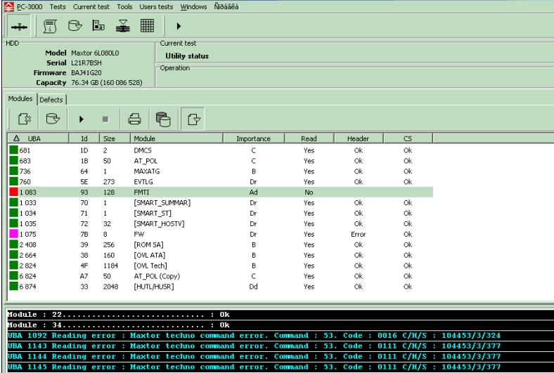

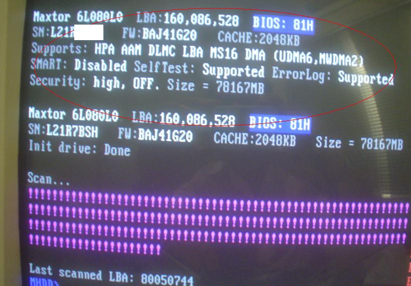

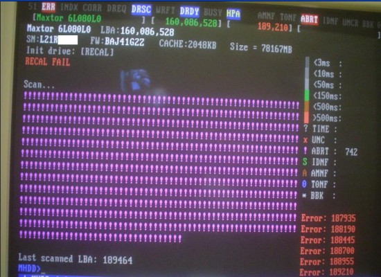

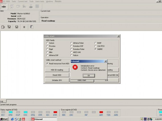

look error...

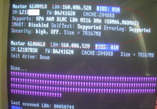

PostPosted: November 13th, 2008, 13:53
Posts: 1060

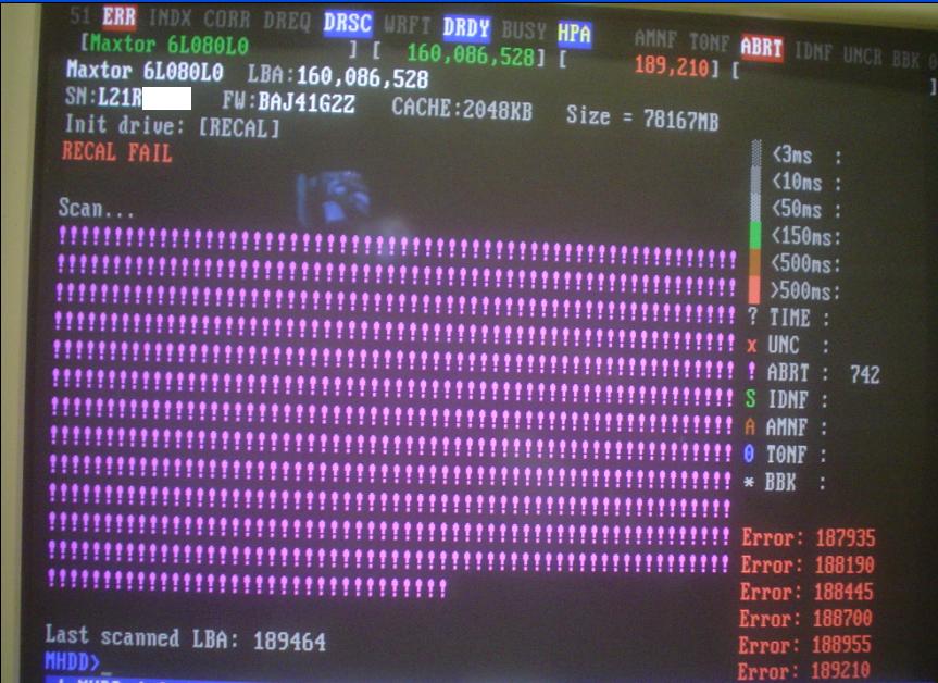

sempre wrote:
look error...
Нет ничего невозможного
PostPosted: November 13th, 2008, 15:21
Posts: 1466
Location: Europe, Hungary
Try another loader!
Maybe you have head problem as well...
The platter is untouched on the motor?
Janos

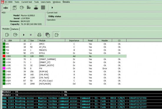

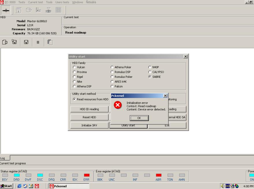

PostPosted: November 27th, 2008, 13:57
Posts: 1060
Hi to all!
after exchange of heads
Read roadmap............................ : Ok
Read roadmap extension.................. : Ok
Read zone allocation table.............. : Ok
Read Technological ID................... : Ok
Read Zone allocation table extension.... : Ok
U_LIST has been found for the head...... : 3
SA head................................. : 3
Ext Model............................... : 6L080L0021P11C
HDD structures have been read successfully

PostPosted: December 2nd, 2008, 9:40
Posts: 1060
Look.
Module : 22............................. : Ok
Module : 34............................. : Ok
UBA 1092 Reading error : Maxtor techno command error. Command : 53. Code : 0016 C/H/S : 104453/3/324
UBA 1143 Reading error : Maxtor techno command error. Command : 53. Code : 0111 C/H/S : 104453/3/377
UBA 1144 Reading error : Maxtor techno command error. Command : 53. Code : 0111 C/H/S : 104453/3/377
UBA 1145 Reading error : Maxtor techno command error. Command : 53. Code : 0111 C/H/S : 104453/3/377
UBA 1152 Reading error : Maxtor techno command error. Command : 53. Code : 0111 C/H/S : 104454/3/2
UBA 1153 Reading error : Maxtor techno command error. Command : 53. Code : 0016 C/H/S : 104454/3/1
UBA 1154 Reading error : Maxtor techno command error. Command : 53. Code : 0016 C/H/S : 104454/3/2
UBA 1155 Reading error : Maxtor techno command error. Command : 53. Code : 0111 C/H/S : 104454/3/3
UBA 1156 Reading error : Maxtor techno command error. Command : 53. Code : 0111 C/H/S : 104454/3/4
UBA 1157 Reading error : Maxtor techno command error. Command : 53. Code : 0111 C/H/S : 104454/3/6
UBA 1158 Reading error : Maxtor techno command error. Command : 53. Code : 0111 C/H/S : 104454/3/6
UBA 1159 Reading error : Maxtor techno command error. Command : 53. Code : 0111 C/H/S : 104454/3/7
UBA 1160 Reading error : Maxtor techno command error. Command : 53. Code : 0111 C/H/S : 104454/3/8
UBA 1161 Reading error : Maxtor techno command error. Command : 53. Code : 0111 C/H/S : 104454/3/11
UBA 1162 Reading error : Maxtor techno command error. Command : 53. Code : 0111 C/H/S : 104454/3/11
UBA 1163 Reading error : Maxtor techno command error. Command : 53. Code : 0111 C/H/S : 104454/3/11
UBA 1164 Reading error : Maxtor techno command error. Command : 53. Code : 0016 C/H/S : 104454/3/12
UBA 1165 Reading error : Maxtor techno command error. Command : 53. Code : 0111 C/H/S : 104454/3/14
UBA 1166 Reading error : Maxtor techno command error. Command : 53. Code : 0111 C/H/S : 104454/3/15
UBA 1167 Reading error : Maxtor techno command error. Command : 53. Code : 0111 C/H/S : 104454/3/15
UBA 1168 Reading error : Maxtor techno command error. Command : 53. Code : 0111 C/H/S : 104454/3/16
UBA 1169 Reading error : Maxtor techno command error. Command : 53. Code : 0111 C/H/S : 104454/3/17
UBA 1170 Reading error : Maxtor techno command error. Command : 53. Code : 0016 C/H/S : 104454/3/18
UBA 1171 Reading error : Maxtor techno command error. Command : 53. Code : 0111 C/H/S : 104454/3/19
UBA 1173 Reading error : Maxtor techno command error. Command : 53. Code : 0111 C/H/S : 104454/3/22
UBA 1174 Reading error : Maxtor techno command error. Command : 53. Code : 0016 C/H/S : 104454/3/22
UBA 1188 Reading error : Maxtor techno command error. Command : 53. Code : 0111 C/H/S : 104454/3/36
UBA 1191 Reading error : Maxtor techno command error. Command : 53. Code : 0111 C/H/S : 104454/3/41
UBA 1192 Reading error : Maxtor techno command error. Command : 53. Code : 0111 C/H/S : 104454/3/41
UBA 1193 Reading error : Maxtor techno command error. Command : 53. Code : 0016 C/H/S : 104454/3/41
UBA 1194 Reading error : Maxtor techno command error. Command : 53. Code : 0016 C/H/S : 104454/3/42
Module : 93............................. : Error
Module : 7B............................. : Header
Module : 33............................. : Ok
Module : 37............................. : Ok
Module : 1F............................. : Ok
Module : 78............................. : Ok
Module : 18............................. : Ok
Module : 21............................. : Ok
Module : 1E............................. : Ok
Module : 1A............................. : Ok
Module : 2F............................. : Ok
Module : 30............................. : Ok
Module : 63............................. : Ok
Module : 48............................. : Ok
Module : 1D............................. : Ok
Module : 1B............................. : Ok
Module : 64............................. : Ok
Module : 5E............................. : Ok
Module : 70............................. : Ok
Module : 71............................. : Ok
Module : 72............................. : Ok
Module : 39............................. : Ok
Module : 38............................. : Ok
Module : 4F............................. : Ok
Module : A7............................. : Ok

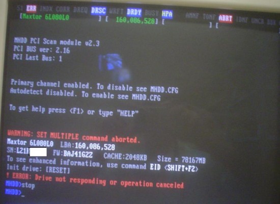

I can rewrite I modulate it 93(DB) ? I find that not…
