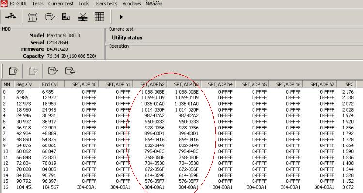

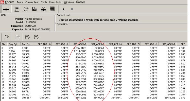

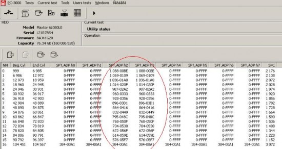

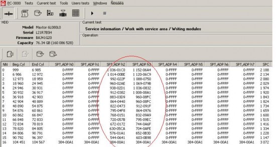

My friend,
:arrow: this deceived you! it is enough to verify…. that look that each hd has its modulates exactly 93 different being of the same family…
Нет ничего невозможного
 Post subject: Re: LDR Maxtor 6L080L0 needed
PostPosted: December 5th, 2008, 8:40
Posts: 1060
sempre wrote:
rameez wrote:
93 is FMTI module it isnt specific u can copy from any hdd with same number of heads .
My friend,
LOOK RAMEEZ!
