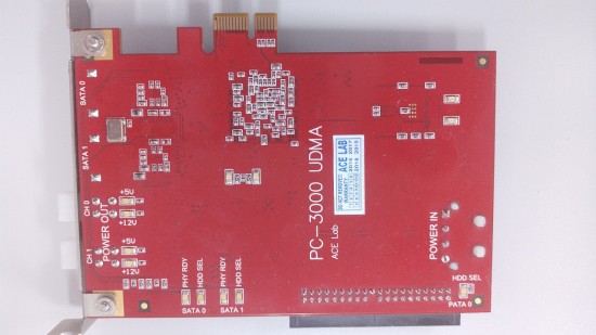

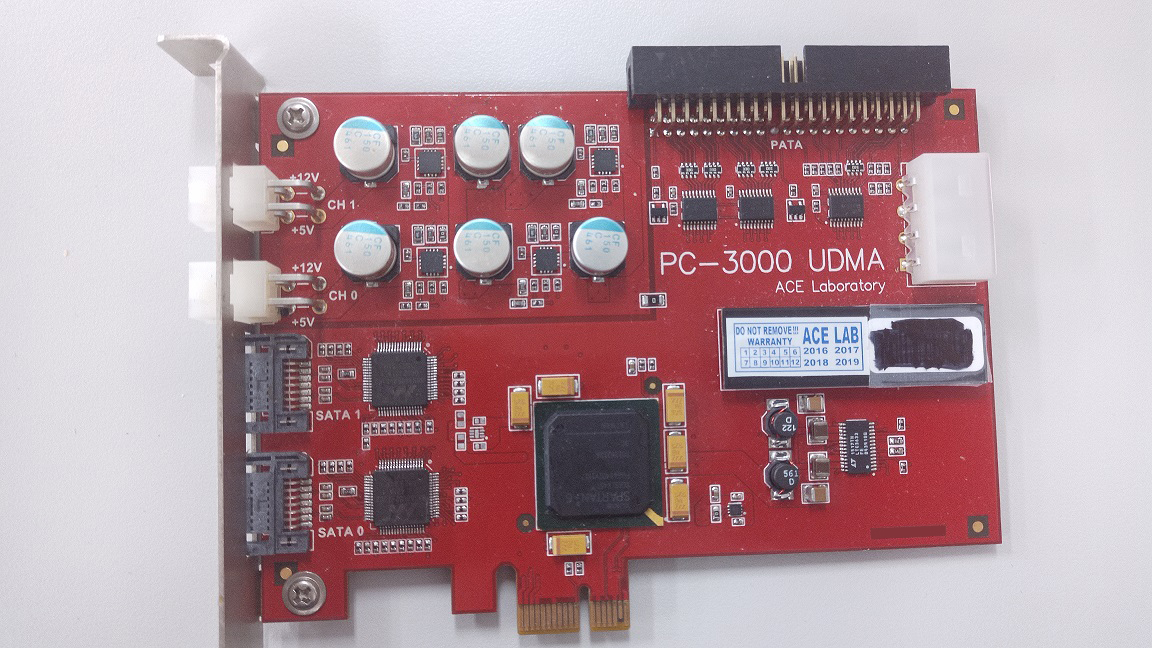

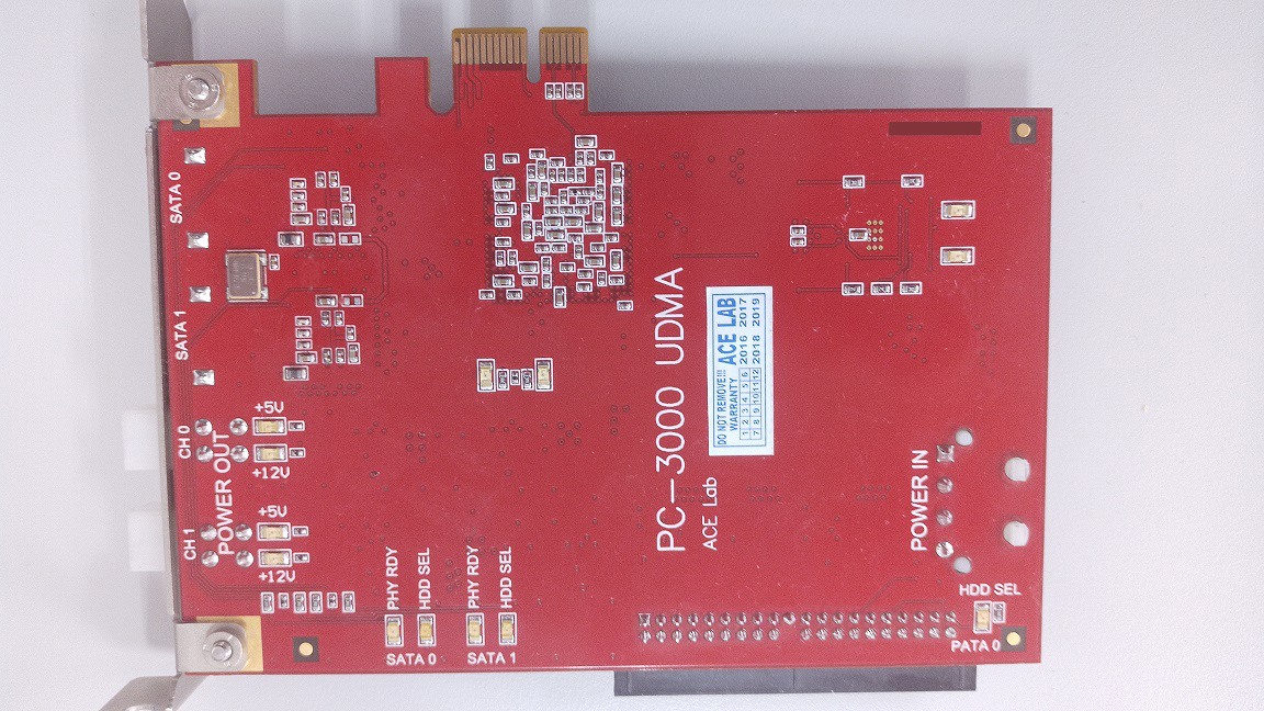

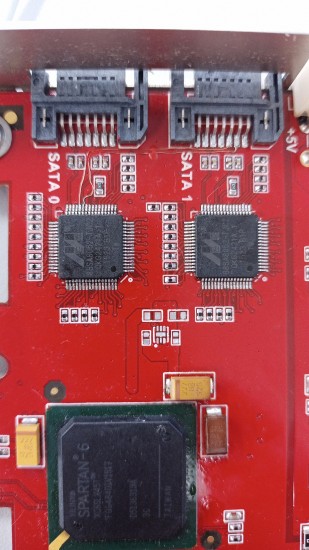

Here we are
 Post subject: Re: Repair the pc-3000 UMDA
PostPosted: December 2nd, 2024, 22:56
Posts: 17328
There appears to be a single oscillator on the PCB which clocks all the chips. Also, the two SATA-IDE bridges appear to share the same supplies, so this would rule out these two possibilities.
Is it possible to connect a drive to the data port of SATA 0 and then power it directly from your PSU, without going through the PC3000-UDMA card's current monitor circuitry? If this works, then try the same for SATA 1. This will tell you if there is any weirdness in the power section.

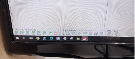

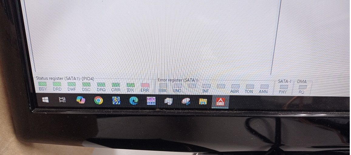

Sir i did what you said
"connect the HDD power DIRECTLY to the motherboard and sata cable to pc-3000"
but as i tought the PC-3000 shows the same status port 0 is ok but power 1 same status!
[quote="fzabkar"]
PostPosted: December 4th, 2024, 2:55
Posts: 17328
I think that your tests prove that the Spartan IC is faulty.

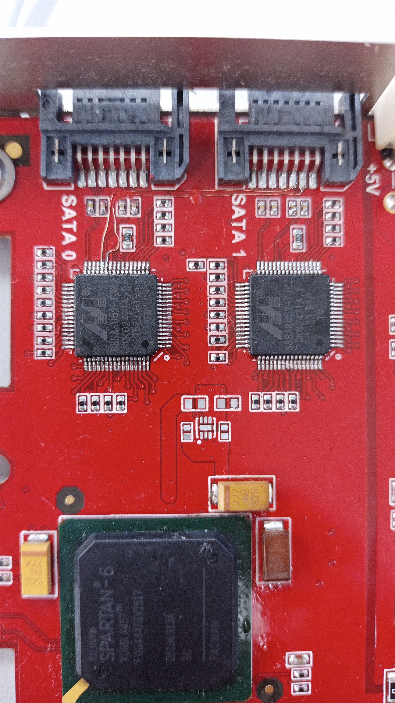

i guess maximum 260C for reflow
may i ask Sir? whats the voltage suppose to be on those pinout in the photo??
is it ok if i bridge with a wires from sata 0 controller IC to sata 1?

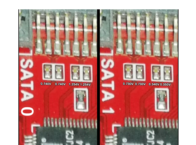

PostPosted: December 5th, 2024, 5:09
Posts: 17328
Yes, something is wrong there, but I don't understand what it is. Clearly the DC bias level of the Tx/Rx pairs differs between the two channels. There is a 1% 6.04K precision resistor (REXT) that sets the bias current (ISET) at pin #26. I would compare the voltages at these resistors.
See REXT/IEXT in this circuit diagram:
https://www.hddoracle.com/download/file.php?id=10650&mode=view
The REXT resistors are those two resistors in your most recent photo.
The only other thing I can suggest is to compare the voltages on each pin of the two bridge chips.
BTW, I notice that pin #29 of the bridge ICs in the circuit diagram is connected to a 3.3V supply, whereas on your PCB this pin appears to be grounded. :-?

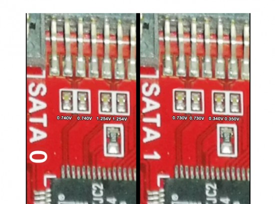

Sir iv notived a difference of voltage in pin 28 & 27 ! on sata 0 is about 8V but on sata 1 is only 3V.
i made a bridge with a thin wires but now both SATA 0 and SATA 1 is not recognized on pc-3000
