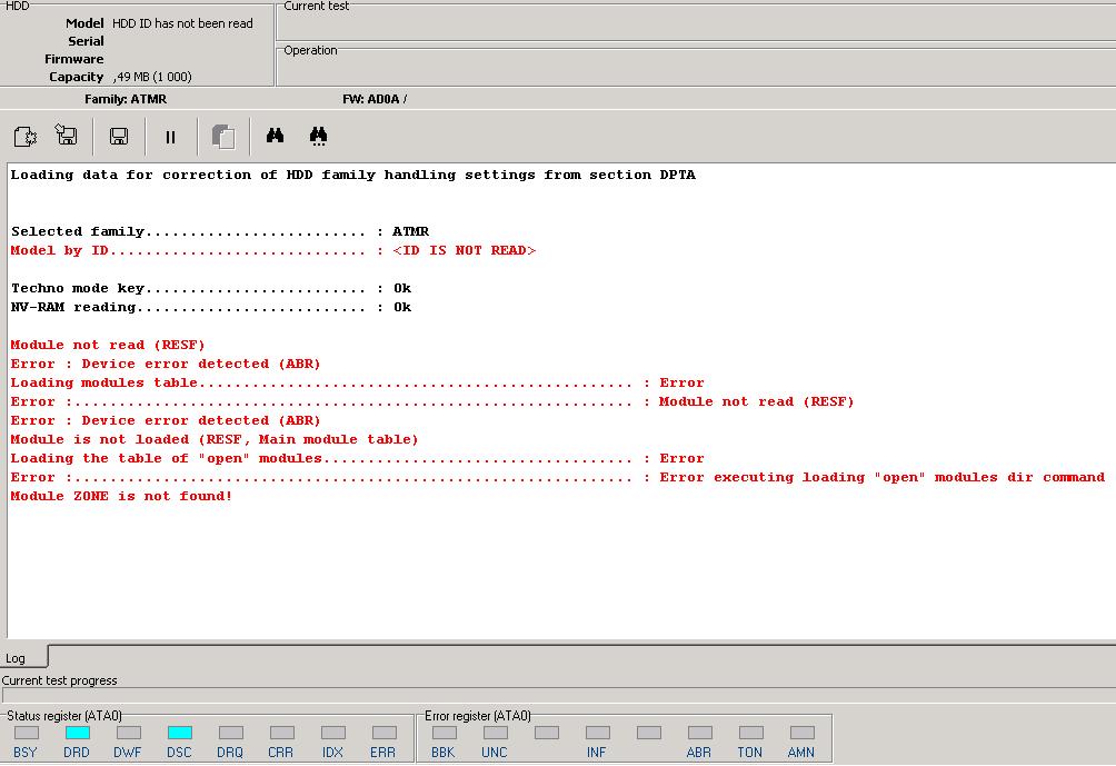

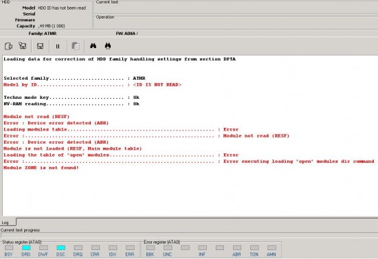

Hello Again,
With the donnor PCB the disk Spin but dont give the ready state.
So i change the NVRAM from Patient to donnor, now i can have ready state but the disk still dont SPIN.
Show the picture off reading the NVRAM . OK
Anyone know what maybe be the problem.
ZeBong
" Россия еще раз"

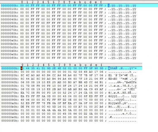

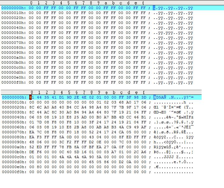

Hi again,
i save the NVRAM from client disk and see that is corrupted i compare with other one.
How can i get this NVRAM ?
the PCB Code is:
14R9060
J41063D
N13440
00T0
