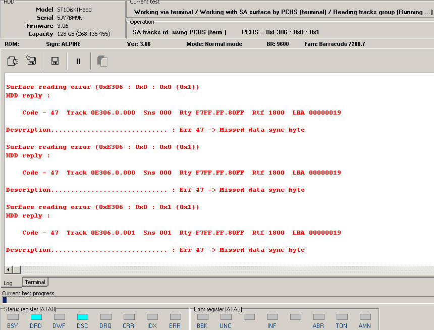

ST380011A model is not detecting , 80Gb detected as 128gb , serial no is correct, can read sa surface, but getting error while reading tracks, can you figure out what is the problem ?

As you can see, the drive is not detected correctly.
So you have to check why. Maybe even the problem is not on the drive, but on cabling.

Seems unusual for model to be wrong, but not garbled, and also serial number and all other parameters are correct.
Have you verified a working drive on the channel? Does HDD still give same ID on alternative station, such as MHDD station?

It looks like the drive is ss'ed, or loosed the STUFF.

Firstly better to show here terminal log.
I could see there reading error (bad heads or corrupted R/W channel on PCB - popular problem on 7200.7)
this is my suspicion. Also, in my experience, 7200.7 are prone to surface damage and/or dirty heads. terminal would help.

You have stuffed the drive with default values use edit hdd ID to correct the problem.

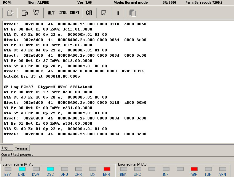

Terminal Log

Has any physical work been performed on this disk?

no, i was trying to read using DE , whilw these terminal log

You could swap PCB and check terminal again, but from some quantity of these cases I had in the past I would bet heads are about to die.
