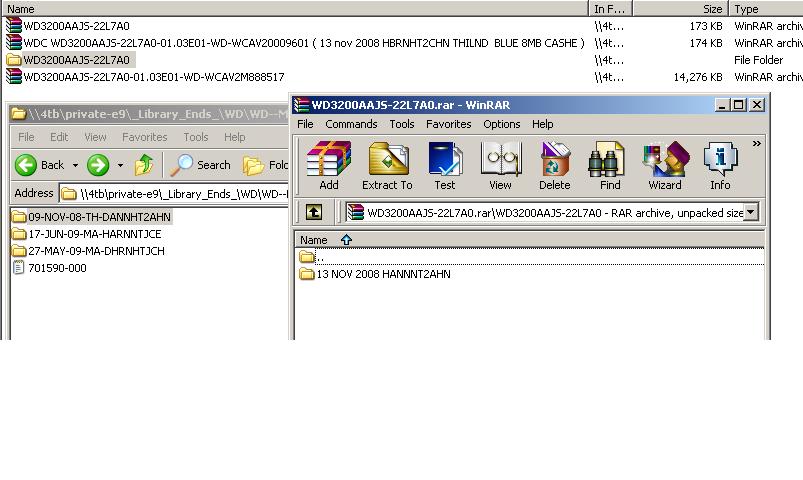

 Post subject: Re: WD Pinclite firmware needed for WD3200AAJS-22L7A0
PostPosted: September 14th, 2010, 11:31
Posts: 2848
those helps?
since ur not providing SN?

einstein9 wrote:
those helps?
You can determine FW version from SN ?
PostPosted: September 15th, 2010, 2:15
Posts: 2848
sorry most of them are: WCAV
none match
:oops:
