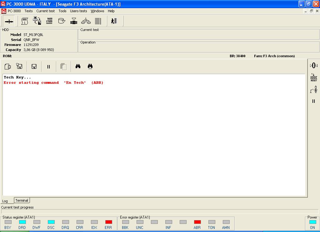

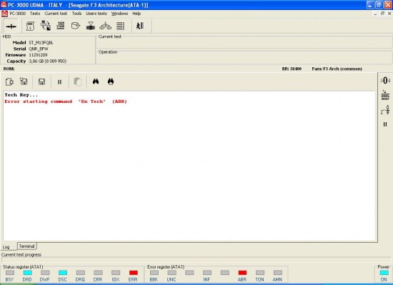

I try to disconnect PCB from Hdd and, with Terminal opened, i run utility. I see follow :

Sorry that is wrong image. Follow that correct ...... Sorry :shock:
