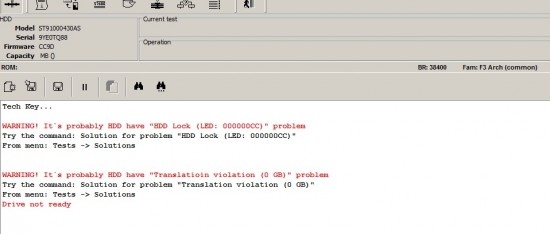

1 TB ST91000430AS(external removed from casing)
Problem:while using disk cable unplugged,replgged cable after that not detecting.
My finding: detects model number s/n without capacity after some time in PC3kPortable.
if detected then it give me 2 warnings hdd locked,translation violation.
if im doing HDD Lock (LED: 000000CC soln giving error drive not ready. and continus knknkn low sound
Tech Key...
Drive not ready
DiagError 00005014
F3 2>
Test : Solution for problem "HDD Lock (LED: 000000CC)"
HDD power supply switching OFF/ON...
Spin Up...
Drive not ready
Tech Key...
ExecuteSpinRequestably HDD have "HDD Lock (LED: 000000CC)" problem
FAIL Op=0100 Resp=0003on for problem "HDD Lock (LED: 000000CC)"
FAIL Op=0100 Resp=0003utions
FAIL Op=0100 Resp=0003HDD have "Translatioin violation (0 GB)" problem
FAIL Op=0100 Resp=0003on for problem "Translation violation (0 GB)"
DiagError 00006008 r problem "HDD Lock (LED: 000000CC)"
Spin Errorsupply switching OFF/ON...
Elapsed Time 5.482 secs
R/W Status 2 R/W Error 84150180
F3 2>
Drive not ready
if not detected error FAIL Op=0100 Resp=0003

Can you post terminal output?
Just power on and post terminal.
Does the drive spin up normally?
Does it spin down after a while?
I 'd say bad heads.

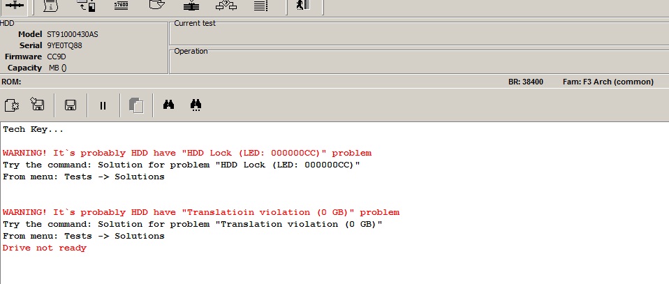

Send Status: COMRESET seen
Rst 0x10M
CommandProcessorTask
Finished SIM Init
Finished InitCmdProcessor
StartDrive
Finished StartDrive
RW: Disc Ctlr Initialization Completed.
StartDrive
Finished StartDrive
ExecuteSpinRequest
Sound like given in download file Seagate ST31000340AS 7200.11 SD81.mp3
Dont show model fimware in pc3k software
Model : HDD ID has not been read
Serial :
Firmware :
Capacity : .49 MB (1 000)
After send status sound stops.
If i kept above terminal for some time ,power off and on drive it starting showing me model and firmware version in PC tool software

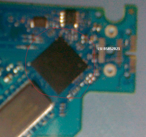

One more my obervation,if im try above procedure only with PCB and checked respective voltage at motor terminal its showing me aprox 1 v supply.What voltages should be there to spin motor?(is it proper way for dignose?)

One more thing i checked if im connecting Only PCB with USB interface it detects USB mass storage in Device manager.But LSI Chip heats slightly
But if im connecting PCB along with HDD it wont detect.
