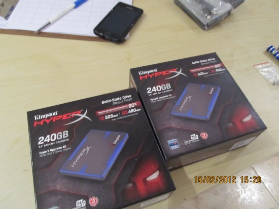

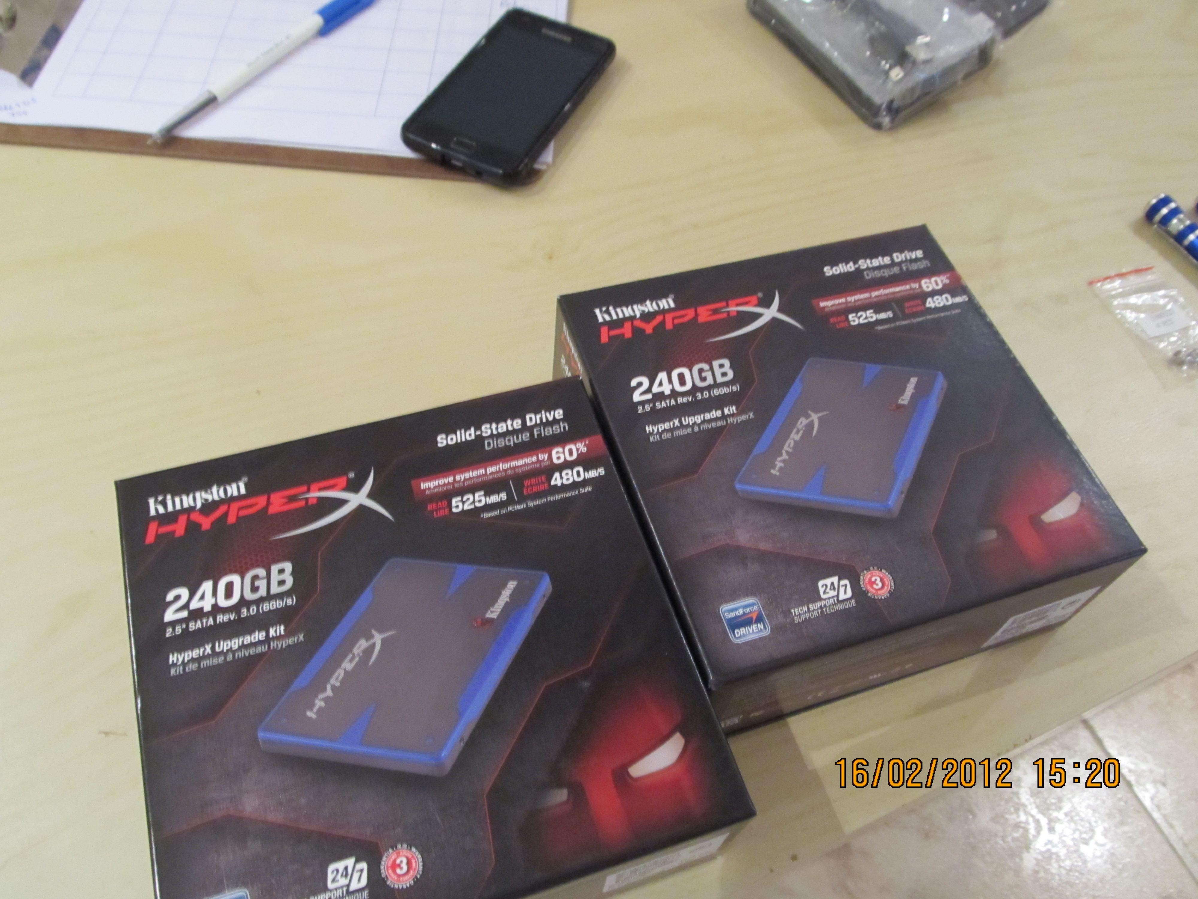

 Post subject: Re: PC hardware recommendations for PC3000 UDMA
PostPosted: February 16th, 2012, 8:31
Posts: 2848
Did you mean this??
got 2 for testing here
PostPosted: February 16th, 2012, 13:11
Posts: 441
Location: italy
yes i meant that..can u test database performance compared to a motor one hdd..
2 in raid 0 could be amazing :lol:
