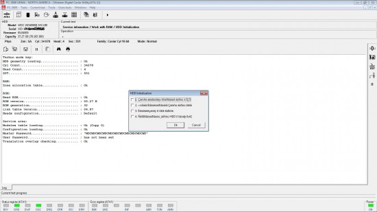

 Post subject: This sub menu seems to be in another language.
PostPosted: September 7th, 2013, 1:49
Posts: 1898
Location: In your hard drive.
This sub menu seems to be in another language. Anyone know what it says?

yes: it says "you have four choices, make your best guess... Mwuhahahahaha!"
looks corrupted to me with so many graves accents umlauts and cedila :/

It's Russian. You need to choose the proper font and then translate the result.
Hint: The second word translates to "engine".

Hint #2:
3. инициализация с новой картой
3. Initialized with the new card

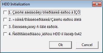

As everyone has said you need have correct language to display the correct Cyrillic characters
 Post subject: Re: This sub menu seems to be in another language.
PostPosted: September 9th, 2013, 0:32
Posts: 1898
I have the Russian language loaded and get the same thing. I tried contacting Ace by email, support ticket, and forum but nothing so far.

I think you may have to choose the Russian language in windows, the language bar IIRC, not just have it installed. Meaning everything is set to Russian. (if it is indeed the Russian language. I don't know Russian, is there more than one type of langage pack in the Russian language, like there is for different chinese variants?
I struggled getting a few Greek programs working at the school I support.
PostPosted: September 9th, 2013, 4:23
Posts: 17326
http://en.wikipedia.org/wiki/Windows-1252
http://en.wikipedia.org/wiki/Windows-1251

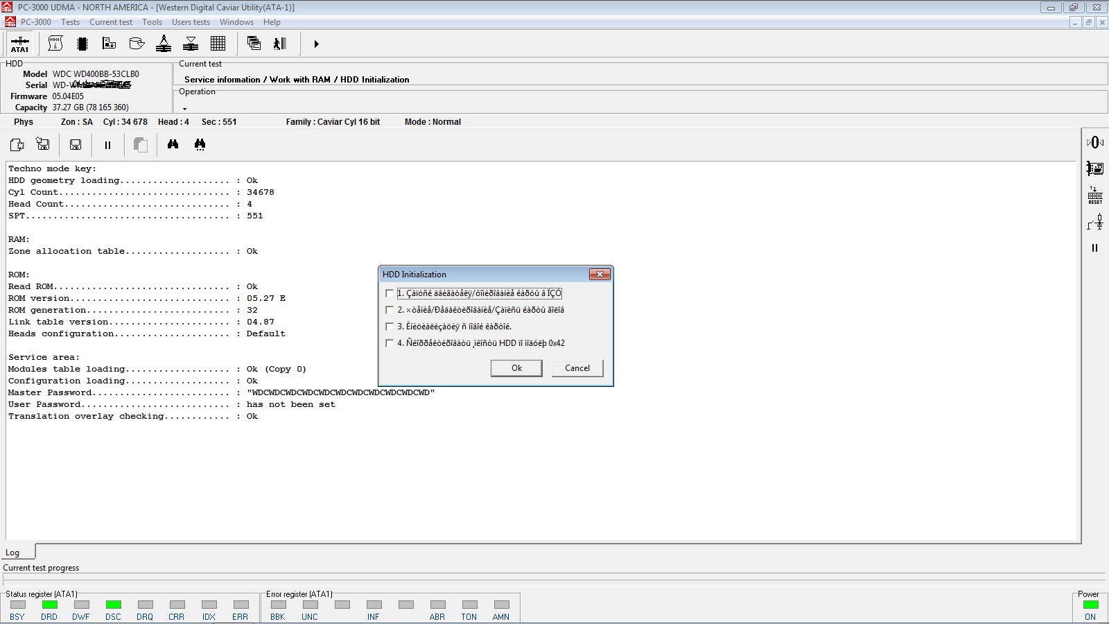

Tell Ace that there appears to be a typo on the first line.
BTW, it's all about motor control, working with head maps and ROM, and adjusting capacity.
Also, Google's initial translation isn't always the most appropriate, so check the alternatives.

Can someone check their North American version to see if the WD 16-bit is messed up?

А Б В Г Д Е Ж З И Й К Л М Н О П Р С Т У Ф Х Ц Ч Ш Щ Ъ Ы Ь Э Ю Я
À Á Â Ã Ä Å Æ Ç È É Ê Ë Ì Í Î Ï Ð Ñ Ò Ó Ô Õ Ö × Ø Ù Ú Û Ü Ý Þ ß
а б в г д е ж з и й к л м н о п р с т у ф х ц ч ш щ ъ ы ь э ю я
à á â ã ä å æ ç è é ê ë ì í î ï ð ñ ò ó ô õ ö ÷ ø ù ú û ü ý þ ÿ

It says
1. Spin up/create (heads) map in ROM (doesn't make clear sense to me even that Russian is my native language, lol :), also it has a typo as was mentioned before )
2. Reading/editing/writing heads map
3. Initialize with new (heads) map
4. Correct(change) drive's capacity using module 0x42
Mine (not North American, though :P) is messed up as well, both UDMA and PCIe.
