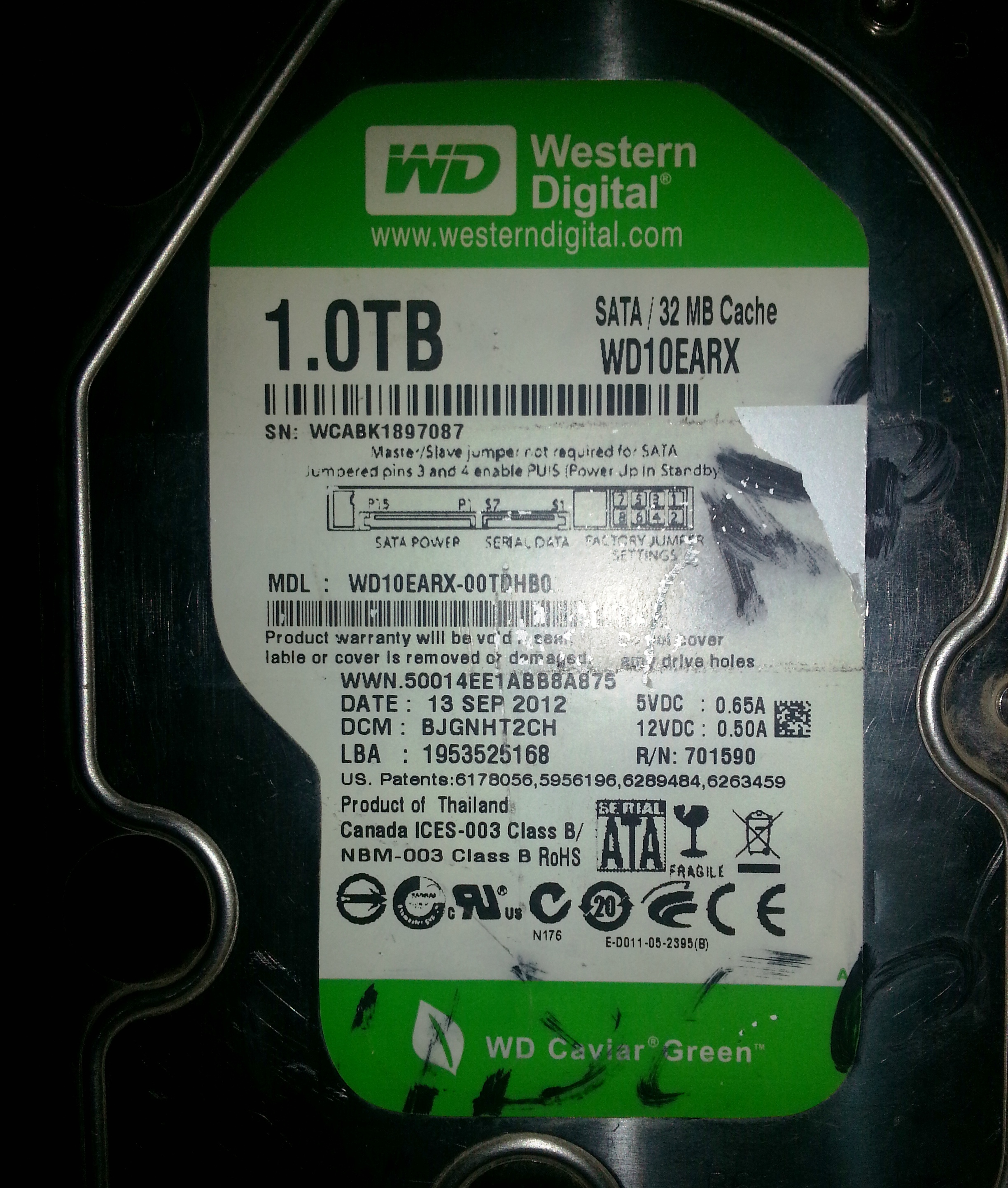

Please share any ROM version for the below model;
WD10EARX-00TDHB0
thanks in advance.

You sure it's EARX and not EADX? I've never seen EARX-TDH.
Also TDH is Dragfly 2, not Sadle 2D.
Am I missing something?

@Northwind, It is EARX, i have double checked it.
thanks for the info about family.
@Tawfeek, are you sure that it is correct rom, it doesn't have ROYL sections in it, what tools you use to read this ROM ?
It's not that I don't believe you, but for archive reasons, can you upload a pic from front label? I have never seen this model and I need to classify it.

Tawfeek wrote:
21-AUG-2011
WCAV5T624244
007700EE-
ٍSPT1974
MA
WDC WD10EADX-00TDHB0
00000000  52 4F 59 4C 04 00 1E 00 0D 00 01 00 4F 5F F9 7F  ROYL........O_ù.
00000010  30 30 30 31 30 30 30 30 00 00 00 00 00 00 00 01  00010000........
00000020  37 37 2E 30 34 44 37 37 00 01 00 00 00 00 50 01  77.04D77......P.
00000030  4E 62 B0 5F 9A 22 00 01 FE 7F 00 00 00 00 20 00  Nb°_š"..þ..... .
00000040  01 01 00 01 00 00 57 44 43 20 57 44 31 30 45 41  ......WDC WD10EA
00000050  44 58 2D 30 30 54 44 48 42 30 20 20 20 20 20 20  DX-00TDHB0
 Post subject: Re: WD10EARX-00TDHB0 ROM+LDR
PostPosted: April 13th, 2016, 8:06
Posts: 464
Location: Egypt
I didn't notice that , As i said it's not from my DB . it's from A friend profile . i just focused about 00TDHB0
i'm so sorry

here is the front label:

MindMergepk wrote:
jermy wrote:
MindMergepk wrote:
any one has plz share
You collecting any version exist ? or need it for DR ?
need it for DR.
Native ROM is missing.
PCB is 2060-771898-002 Rev A
Should that be 771698?
I notice that the R/N number on the label is 701590. Doesn't this normally reflect the PCB P/N? Could the PCB also be foreign? I would check the IC date codes against the manufacture date on the label.
PostPosted: April 14th, 2016, 5:31
Posts: 3550
This drive is fake.
