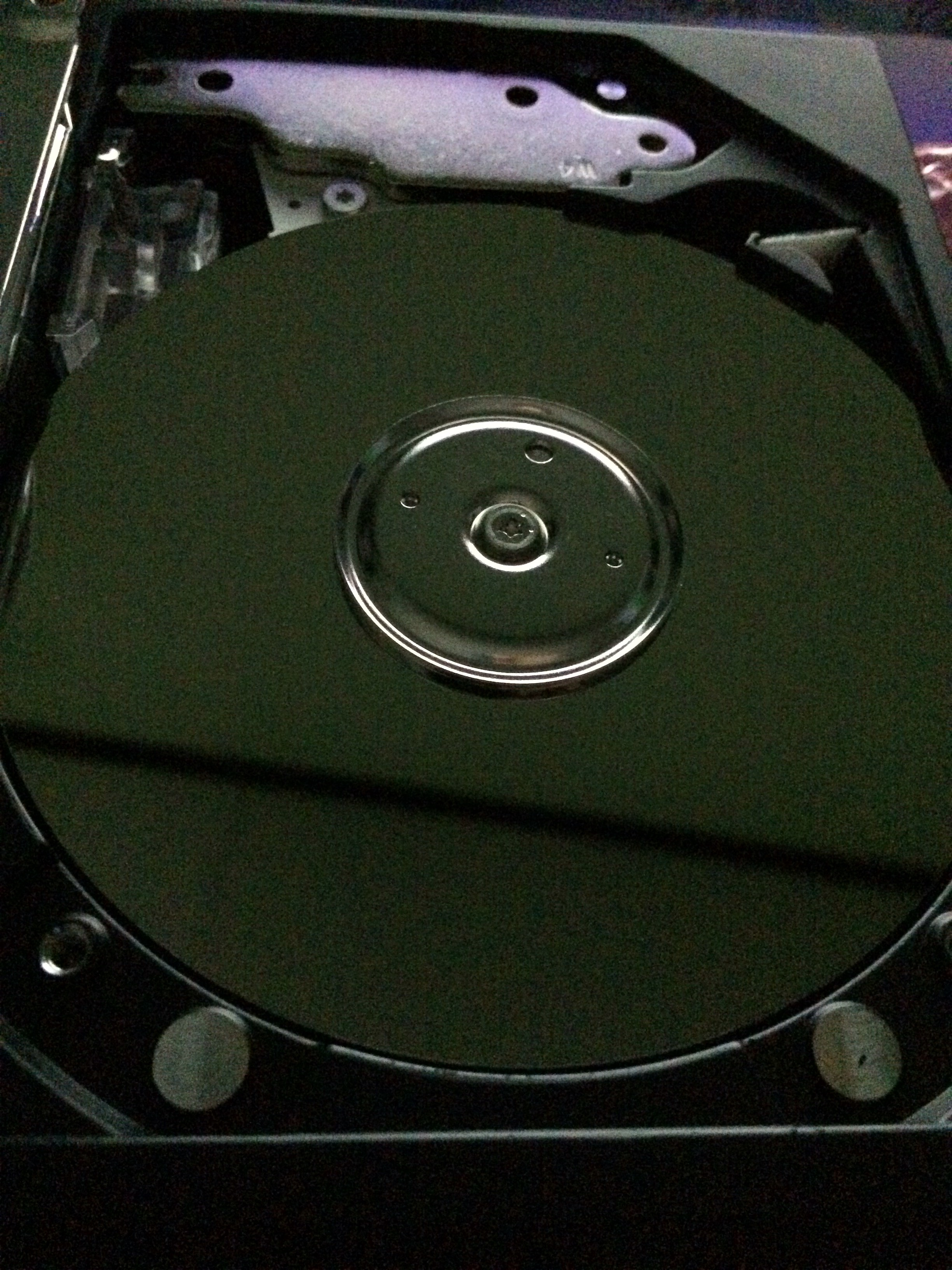

Attached pic
 Post subject: Re: MAXTOR HDD PCB Replacement!!!
PostPosted: September 16th, 2016, 11:04
Joined: September 27th, 2010, 16:29
Posts: 182
Location: Buenos Aires, Argentina
Hello olinyer, may a ask you a question? Why did you open the hdd? Did it make some noise? I assume that you are not connecting the hdd opened...I am right?
Best
F
