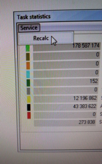

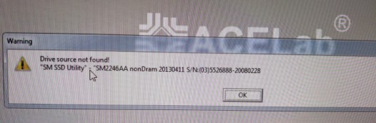

 Post subject: Resume task failed
PostPosted: March 16th, 2020, 10:00
Joined: July 12th, 2010, 4:38
Posts: 1455
Hi
I have a situation here, when I was imaging a SSD. In this case I had to put it into safe mode, load a loader, create a translator and start an Imaging task.
During the Imaging, the system crashed and I had to reboot the PC.
After that, and re-doing all the steps to access data, when I want to resume the imaging process I get an error that I attach.
If I create a new task, I can see that the ID of the SSD is exactly the same. If I copy all files from one task to another except task.prm, I can see the sector map (green and black sectors), but on the task statistics all sectors are marked as not read.
If I copy the task.prm I get the same error.
I don't want to re-do all the scan (it took a few days to do....).
Any suggestions?
SSD.jpg [ 497.52 KiB | Viewed 14447 times ]
ACELab partner
 Post subject: Re: Resume task failed
PostPosted: March 16th, 2020, 10:08
Posts: 402
Location: Moscow
pclab,
I can see the sector map (green and black sectors), but on the task statistics all sectors are marked as not read.
It is necessary to recalculate statistics on the lower tab "Heх"
 Post subject: Re: Resume task failed
PostPosted: March 16th, 2020, 10:13
Joined: July 12th, 2010, 4:38
Posts: 1455
Tomset wrote:
pclab,
I can see the sector map (green and black sectors), but on the task statistics all sectors are marked as not read.
It is necessary to recalculate statistics on the lower tab "Heх"
Hi Tomset
In the Hex tab? It's nothing there.
Do you mind to explain?
Thank you so much
ACELab partner
 Post subject: Re: Resume task failed
PostPosted: March 16th, 2020, 10:27
Posts: 402
Location: Moscow
pclab,
Sorry, the "map" tab - right click.
Last edited by Tomset on March 16th, 2020, 10:29, edited 1 time in total.
 Post subject: Re: Resume task failed
PostPosted: March 16th, 2020, 10:28
Joined: July 12th, 2010, 4:38
Posts: 1455
Ah, found it.
For former knowledge here's the attachment.
Recalc.jpg [ 2.36 MiB | Viewed 14434 times ]
ACELab partner
 Post subject: Re: Resume task failed
PostPosted: March 16th, 2020, 10:29
Online
Posts: 4843
I think he meant the map tab, but if you copied the map files you should be able to see the already copied sectors in the map... at least that's what i would expect.
 Post subject: Re: Resume task failed
PostPosted: March 16th, 2020, 10:36
Posts: 402
Location: Moscow
pepe,
It is expected, but will not appear until it is counted to a new database. :)
 Post subject: Re: Resume task failed
PostPosted: March 16th, 2020, 10:49
Online
Posts: 4843
even if you copy the fdb as well?
ps.: it looks like we relpied quasi simultaneously :)
 Post subject: Re: Resume task failed
PostPosted: March 16th, 2020, 11:53
Joined: July 12th, 2010, 4:38
Posts: 1455
I also thought it would work just with the copy, but it only worked after the Recalc.
ACELab partner
 Post subject: Re: Resume task failed
PostPosted: March 16th, 2020, 11:59
Posts: 402
Location: Moscow
pepe wrote:
even if you copy the fdb as well?
IMHO.
The new task does not recognize someone else’s base.
