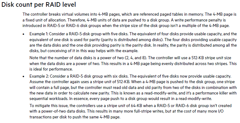

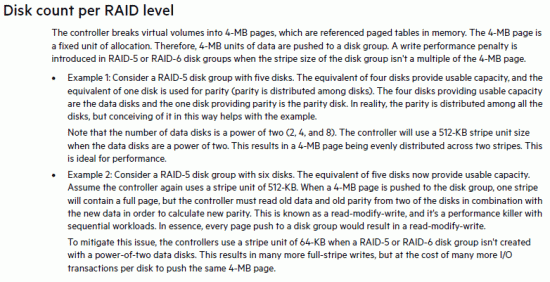

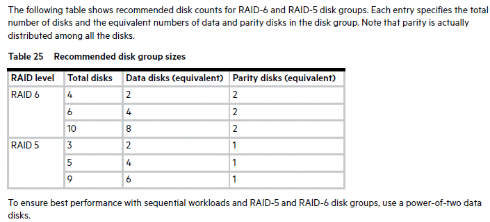

ThinkSystem DS6200/DS4200/DS2200/DS EXP Storage Manager Guide:
https://download.lenovo.com/storage/01gw902_ds-series_smg_en.pdf
FWIW, Lenovo's "Best Practices" (page 144) recommends that the number of data disks in a RAID-6 be a power of 2, in which case the optimal stripe size would be 512KB. Otherwise the stripe size is 64KB.
