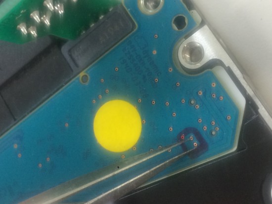

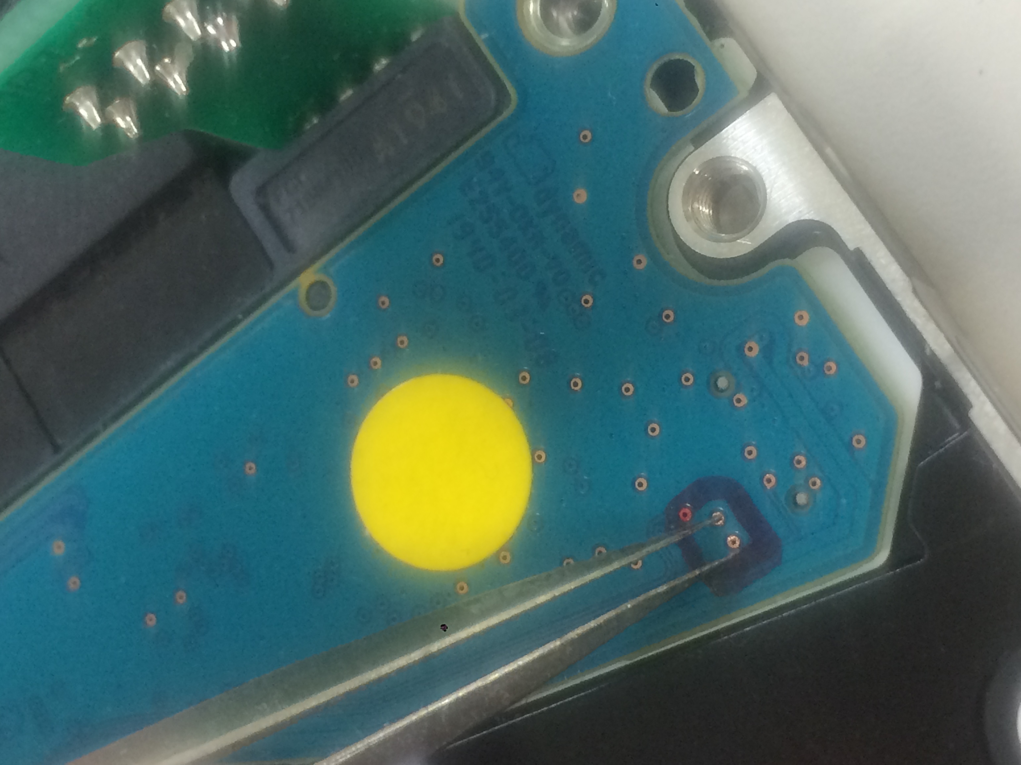

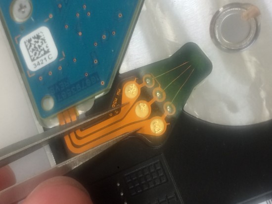

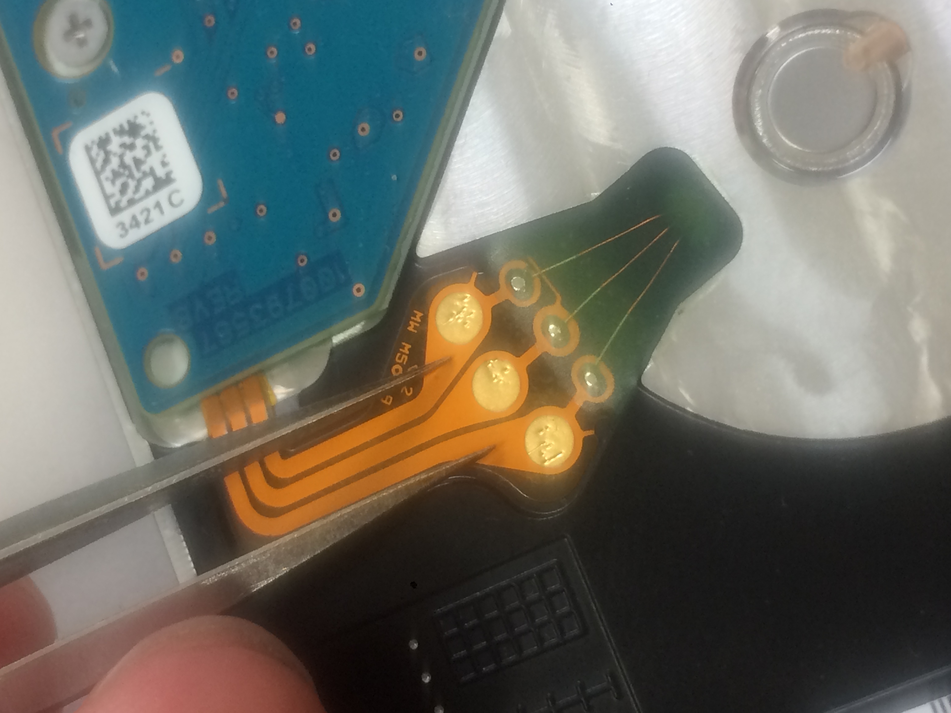

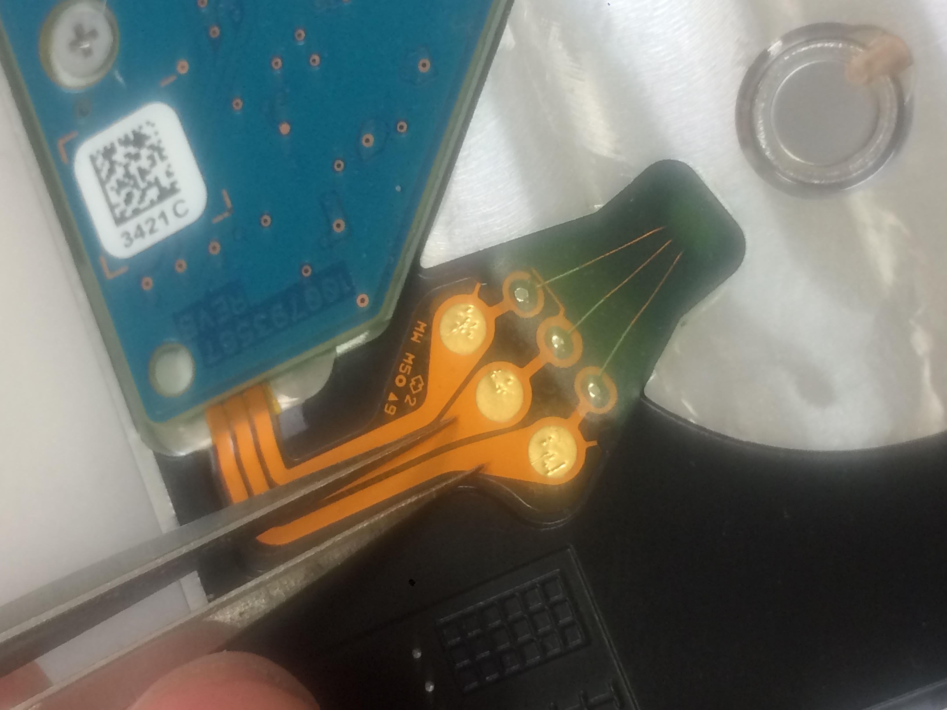

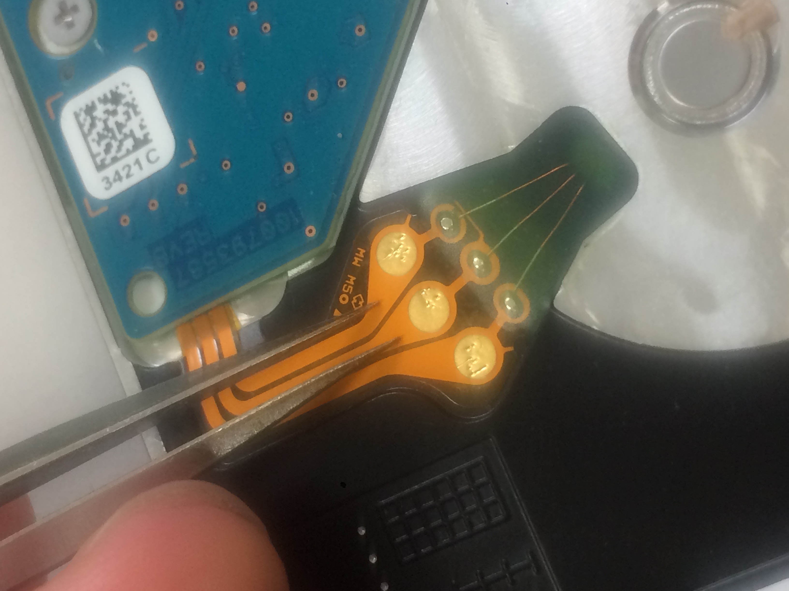

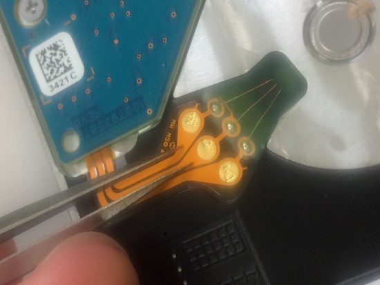

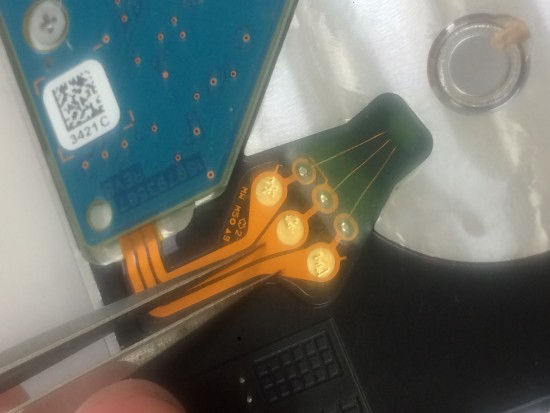

can somebody tell me which is the correct position for the read channell? i tried many times but is still get the error LED:0x000000BD FAddr:0x00008004
should i short before or after the tech Unlock Handshake"?
should i keep the position untill the drive get ready ? if the position is correct will the drive keep spinning or will stop spins?
