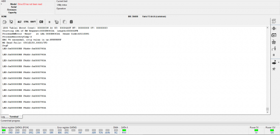

This disk doesn't make clicking noise neither spin down can it get fixed on FW level or the issue is deeper with Heads
Model - Seagate 2.5" Barracuda (Rosewood A5) ST1000LM048
Most probably yes.

Disk stays in busy state & is not coming to terminal . Does this case needs anything extra like shorting
