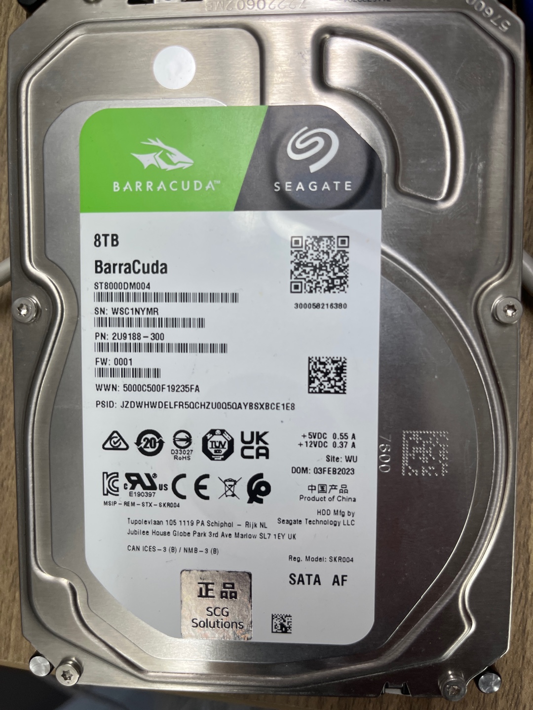

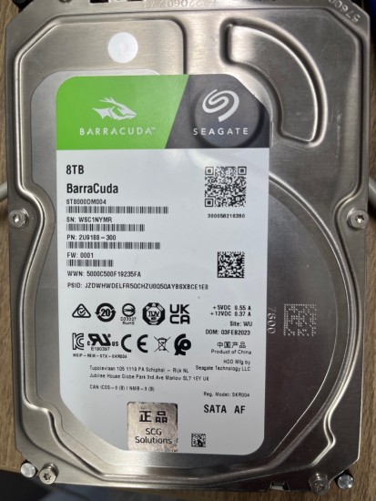

 Post subject: seagate barracuda 8HB ST8000DM004
PostPosted: September 3rd, 2024, 2:20
Joined: June 3rd, 2024, 0:06
Posts: 26
Location: 대한민국 서울특별시 송파구 문정동 96-6

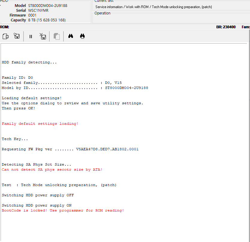

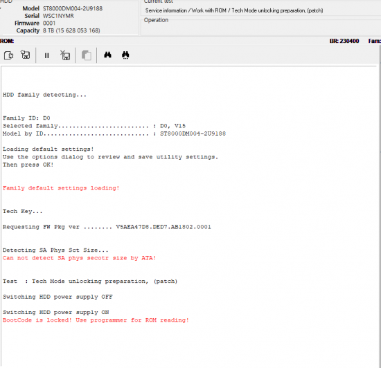

Is there a workaround for the ROM boot code lock??
Should I read after removing the chip??

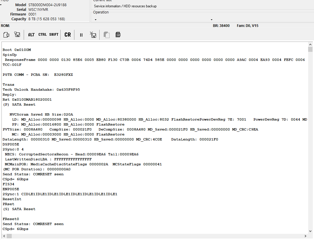

 Post subject: Re: seagate barracuda 8HB ST8000DM004
PostPosted: September 3rd, 2024, 2:40
Posts: 26
PostPosted: September 3rd, 2024, 4:55
Posts: 26
PostPosted: September 3rd, 2024, 13:36
Joined: March 6th, 2010, 3:46
Posts: 627
Location: Kolding | Denmark
As it says in log " Use programmer for ROM reading" - You can not use PC3K ( for now )
Read ROM with external programmer. Patch ROM in PC3K and write it back again.
I prefer to read/write on board with a pogo clip.
Digitalsupport Data Recovery
https://digitalsupport.dk
PostPosted: September 3rd, 2024, 18:37
Posts: 4850
- read rom several times and compare them
- make sure you read the full rom, ie not just the half of it with a bad config.
Thank you! so much! :D :)

Make sure you chose the correct chip in your programmer. Read and save several times and compare your dumps.
PC3K HexEdit, WinHex whatever you prefer will do fine. Also check ROM info when you load it in PC3K.

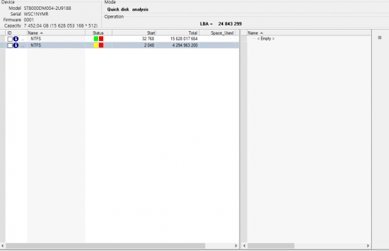

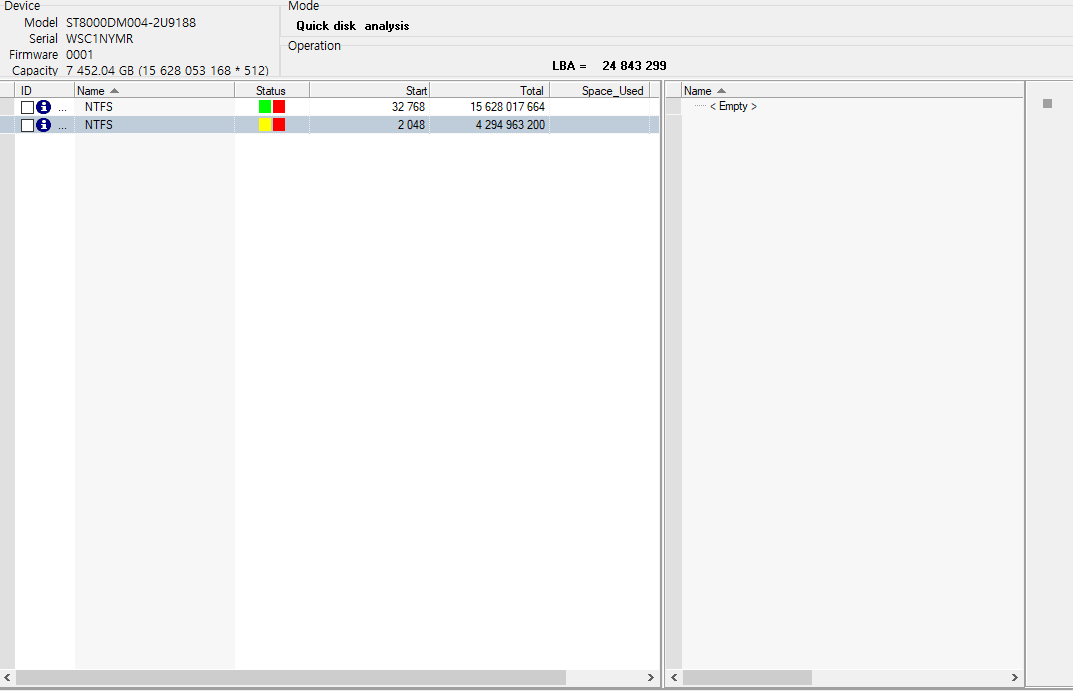

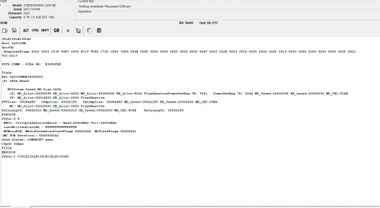

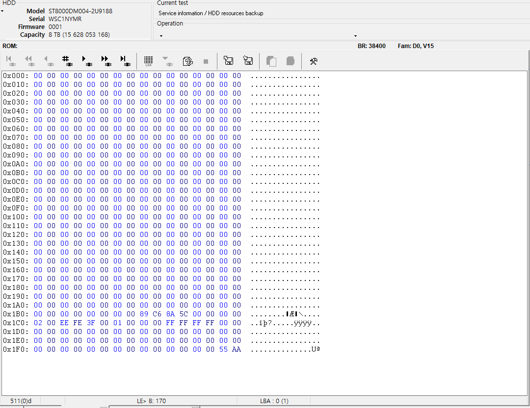

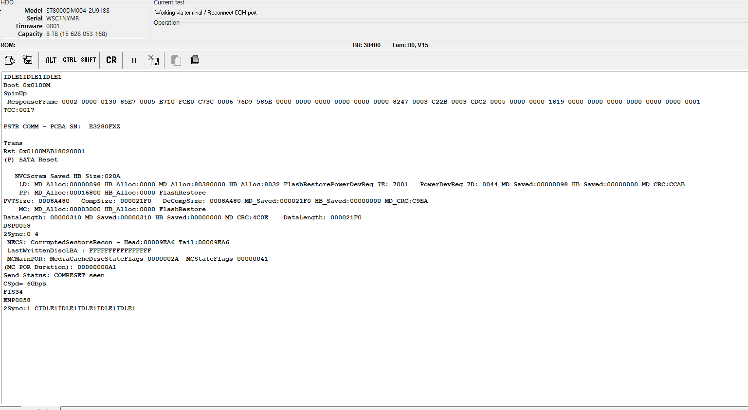

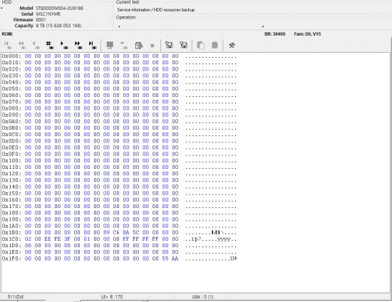

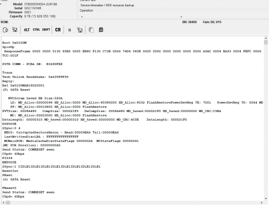

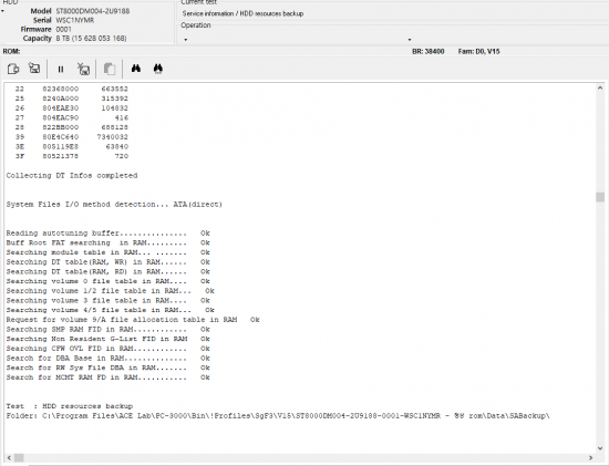

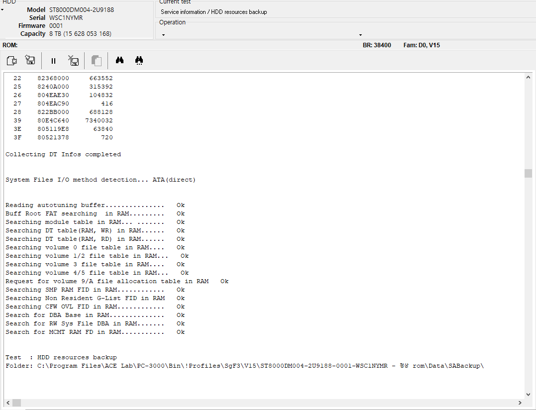

You have completed the ROM patch.
However, the data is not visible.
What's the problem?
Upload both terminals and logs.
Everything seems normal on the log.
Just in case, I'm going to post ROM too.
PostPosted: September 6th, 2024, 16:54
Posts: 4850
Try cloning the drive first then do logical recovery on the clone...

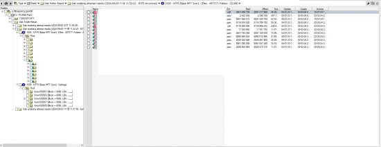

PostPosted: September 8th, 2024, 23:13
Posts: 26

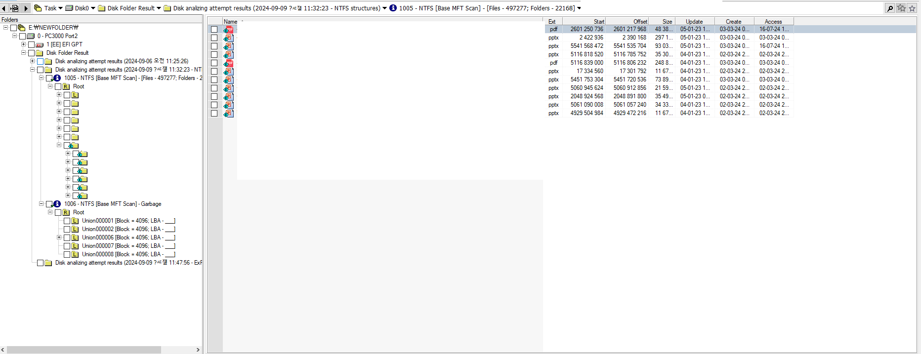

pepe wrote:
<font style="vertical-align: inherit;"><font style="vertical-align: inherit;">먼저 드라이브를 복제한 다음 복제본에서 논리적 복구를 수행해 보세요.</font></font>
It looks like this.
The folder with E does not have data even when it is recovered, and the capacity is zero. In this case, is there no other way but to recover RAW?
Is it broken data?
PostPosted: September 9th, 2024, 2:28
Posts: 3551
E = EFS encrypted, if I remember correctly.
