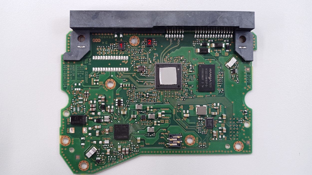

hello i have this urgent case with broken pcb
iv changed the pcb. with a donor ...the HDD become ready but cant read any sectors!
do i also need to solder the ram IC on the hdd ? or the smooth IC? are the head adaptived in the ram IC?

yeah, i suppose you need to transfer adaptives at the least.
would it be hard to post a pic about the pcb?

Hello Sir iv soldered back the ROMS to the original pcb and soldered back to the donor
now both HDD get ready but cannot access the sector ! im shocked

Did you dump the ROMs, or did you just solder them? In any case, could you dump all 4 ROMs? I have written a tool that can parse the contents.

No, it doesn't. And in your situation, it is not ROM issue. Same problem you get if connect only PCB. User area access is different story. Do you hear long double recalibration of you hard drive or it became ready within a second?

The OP damaged a good donor drive by using its PCB on the patient without a ROM transfer. Doesn't this imply that something was written to the donor ROM by the patient drive? I assume that the donor is still spinning.

or the preamp is dead and killed both pcbs...

Sir i did the rom CHIP swap! both hdd are spinning! both hdd had data access before the swap

does swap the rom chip kill the preamp? both HDD are spinning and get ready without any weird sound
