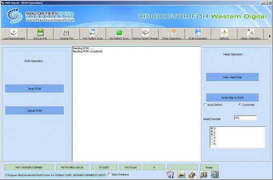

Now I have new problems:
1. Antivirus intercepts most SD usb driver as a virus. Didnt have a problem before with the same antivirus software.
2. WD doctor has a section to change the head map but the function just corrupts your rom or doesn't work.
3. Manuals are a mess. Update one manual with all the info. Im tired of downloading twenty manuals for the same tool. Seriously, why is half the manual devoted to installing the software.
4. Pop up update never works but still annoys me. Just get rid of it. I will update when I feel like it.
5. SD forum is basically useless. Hard to navigate to find updates, firmware, and manuals. Your going to get faster and better help posting here. Lack of a ftp site for uploading firmware bugs me.
6. All the tools are a year or two behind the current technology.
7. What is this new database thing and how can I get rid of it?

8: Update program in WD doctor doesn't update the software,
it updates the firmware of the box , and makes previous versions of
WD Dr not work.

Dear thatdellguy,
For the problems you mentioned here, some of them are undergoing and we already put into our upgrade plans:
1. Antivirus intercepts most SD usb driver as a virus. Didnt have a problem before with the same antivirus software.----We have already contacted AVG, Norton. If you use a different antivirus, please contact me.
2. WD doctor has a section to change the head map but the function just corrupts your rom or doesn't work..---------I will sumbit it to our D & R dept immediately. If you can give me more info,such as screenshot, resource files, it will help us greatly.
.------In fact, we put all our files and case study into the DVD. We may take your suggest and reorganize the manual.
4. Pop up update never works but still annoys me. Just get rid of it. I will update when I feel like it. -----.------Okay. I already sumbited the problem and I hope it can be fixed within 2 weeks..
5. SD forum is basically useless. Hard to navigate to find updates, firmware, and manuals. Your going to get faster and better help posting here. Lack of a ftp site for uploading firmware bugs me..------------that's a problem. I don't know how to solve it in a short time. So we listed some most often used files/documents on America Market Dept. website :http://www.diskdatarecoverytools.com/download.html
If there is any new upgrades, you can get the info here..
6. All the tools are a year or two behind the current technology. .
--------Well, as you know, HDD manufacturers release many different models one year. We need time to analyze and study. It needs more time. However, we will try our best to keep up-to-date..
.------In fact, it is a database for firmware, we will add our current firmware resource into it. Besides, you can backup your firmwares lab. You can disable it when installation

We use a corp version of symantec norton.
I will send you some pictures of the head map problem.

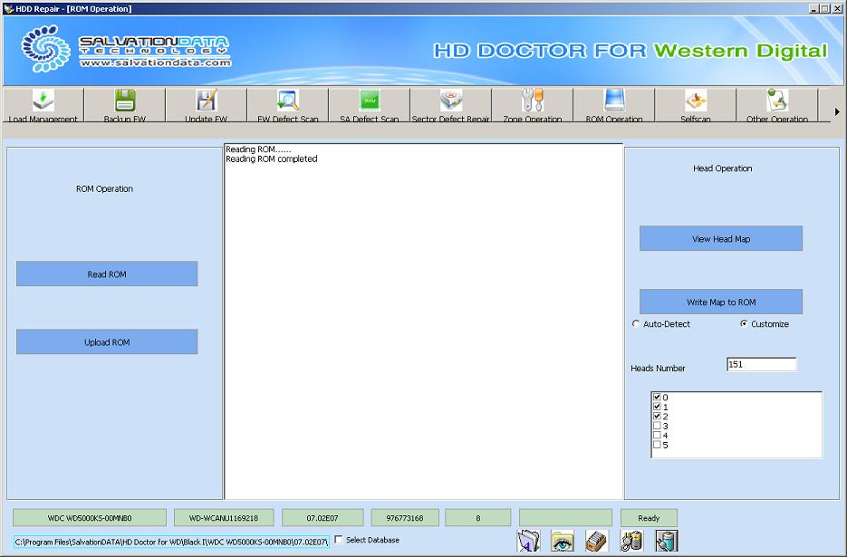

After I press "View head map" this is what I get:
I have gotten the same thing .
I can add, if you try to correct the head map to 8 heads ,
and write map to rom , it corrupts the rom so that pcb no longer functions.
Also the head map function only has 6 available heads, and not
the full 8
