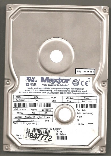

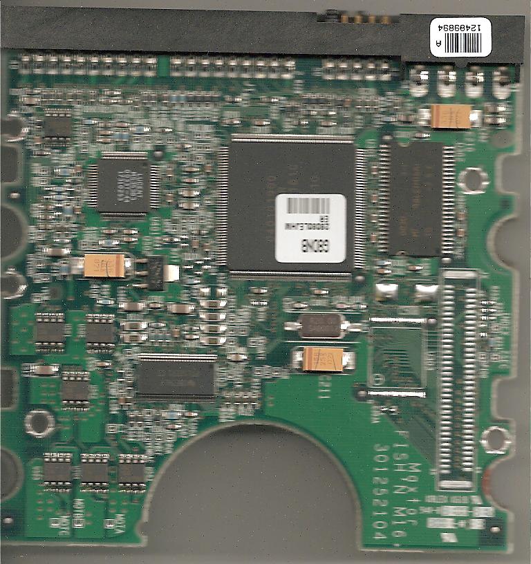

For demonstration purposes, what would be the simplest way to cause a functioning maxtor drive detect only as ATHENA or whatever family name it has? I was under the impression that a corrupted header in the g-list or p-list would cause this behavior, but I have been having trouble inducing it on purpose on a drive I have here by writing random bytes over the TAP_LD1 and TAP_LO1 bytes in these modules.

Can you post pics of label and pcb? Thanks.

here's a pic of the label and a fuzzy one of the pcb... all I had here to take pictures with was a customer's flatbed scanner so the pcb one isn't so great.
