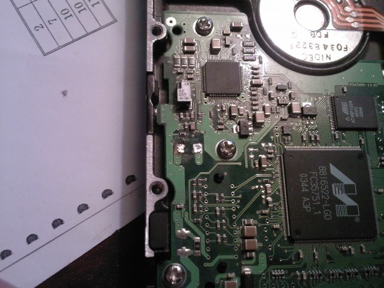

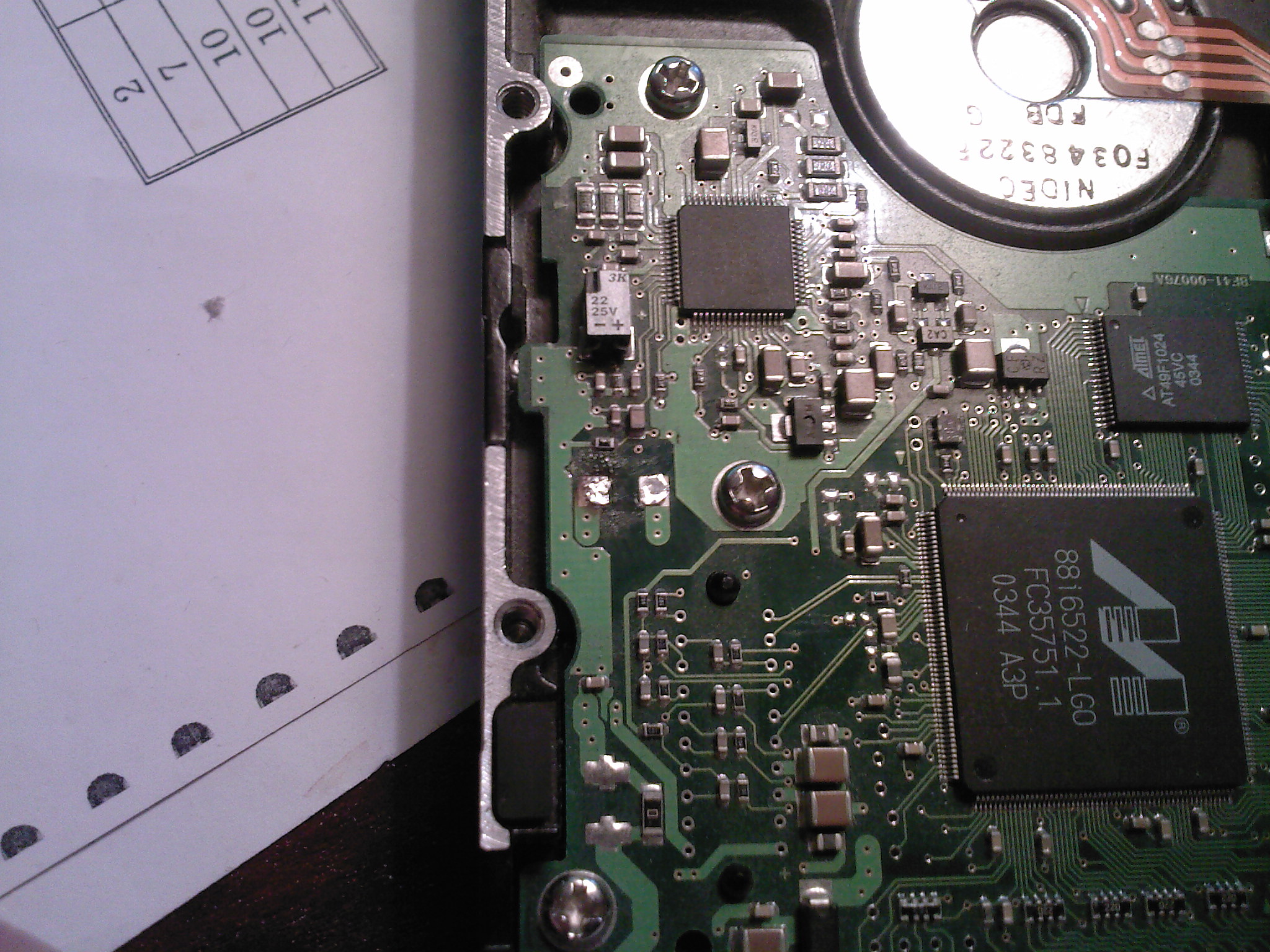

I have a Samsung SP0802N and need a schematic for the main board. Any ides where I can find one?
I put 16v through it by mistake and blow a SMC, the one to the left of the middle screw. looking at the drive with the spindle cable to the top.
So, can about help here?
TIA
Andy

Post a pic

OK, here goes.

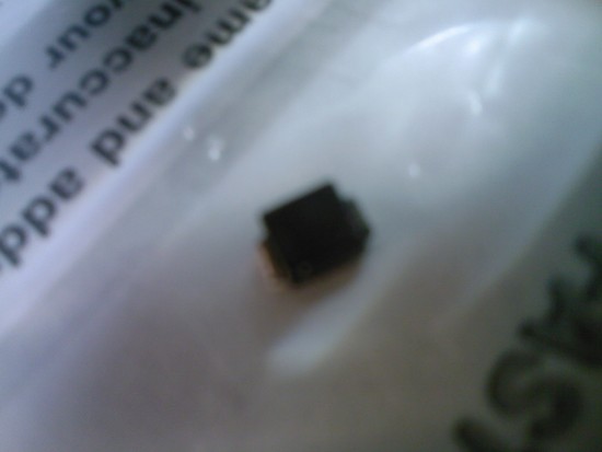

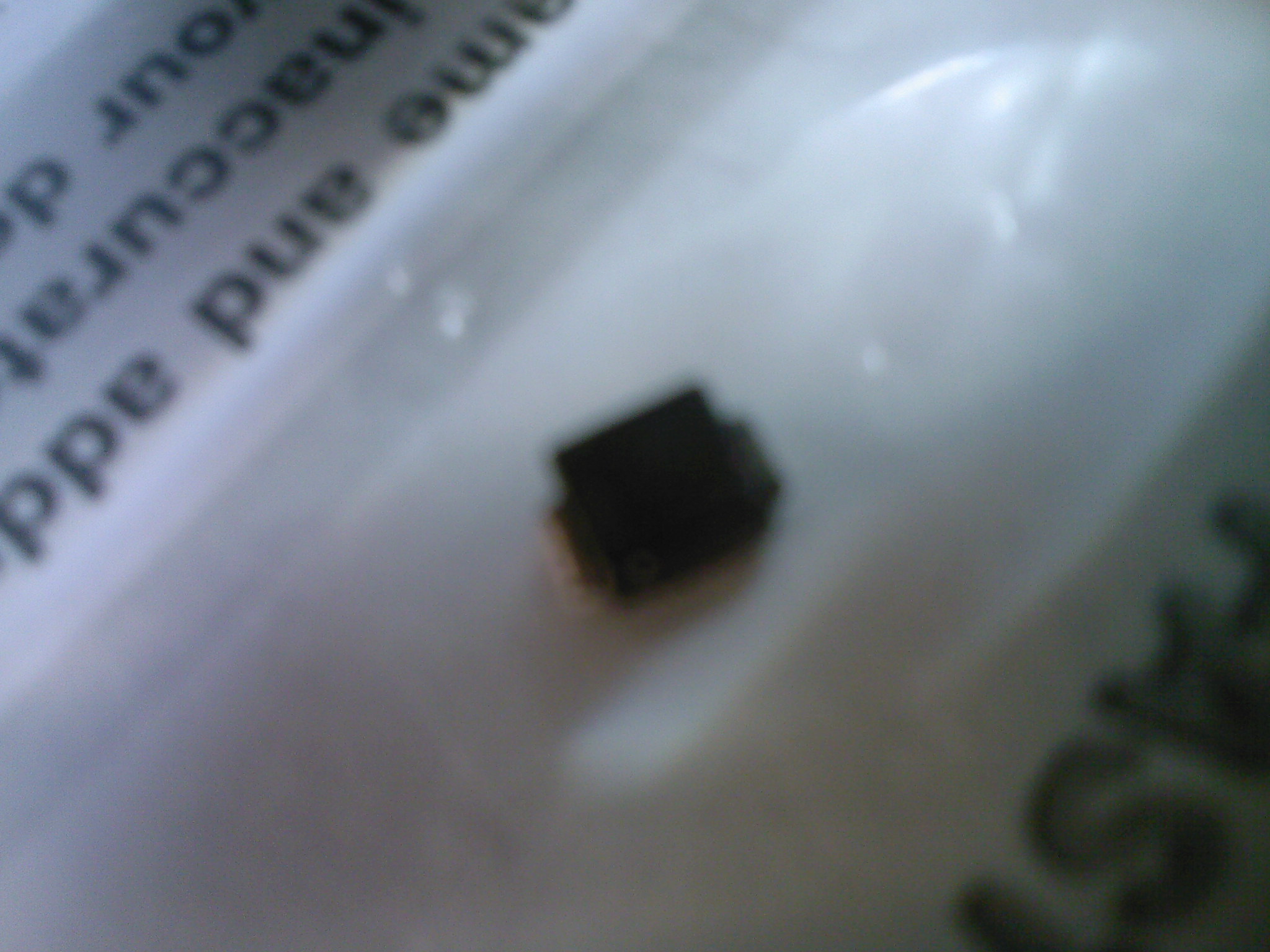

In the main pic. you can see where it sits, just to the left of that PK screw, the bottom pic is the SMC. I think it could be a diode, maybe a votreg. Anyway, what do you think? I have just DLL Palo_SVC_Manual_Eng.pdf which is great, but, does not show any components.

Pic is blurry, but seems it is a power diode. You should be able to simply 'replace' this with one from a donor PCB, no need to worry about compatibility.

i am sure that is diode.

Thanks Guys, that's what I was thinking, Diode, will have a look through the c&^p I have as see if I have one, failing that I will pop over to RS, I doubt if Maplin would have one.
I'll let you all know if I fix the problem.
