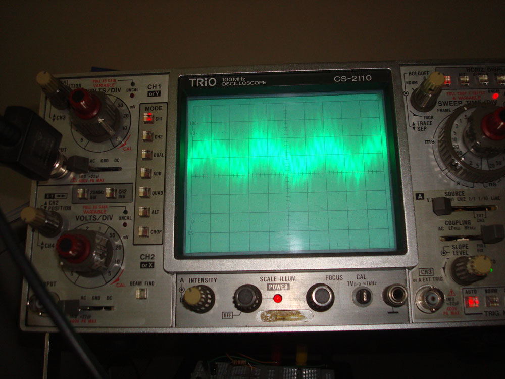

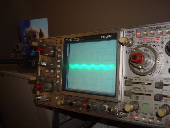

Hi Janos,

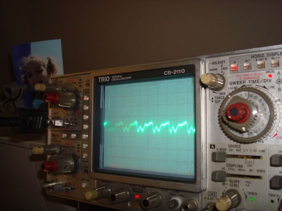

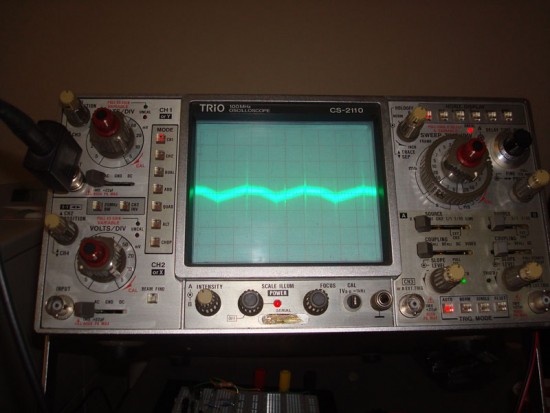

I have attached two images of the 12v and 5v rails by back probing the molex with the scope.
What do you think? Looks bad? Settings for both pics was :
5mV/div (but 10x probe - so 0.005 x 10 = 0.05v/div)
.5ms
I should connect a spare Enermax I have here and compare....
Cheers
-Al

um, this is not a good measure methode.
A capture scope can be better, because the idle computer not makes current spikes...
Anyway, this looks noisy anyway. :D
Janos

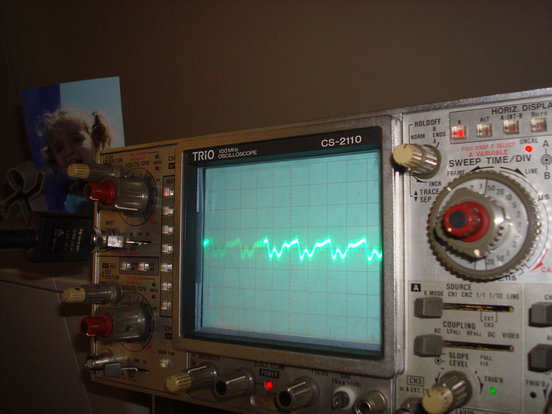

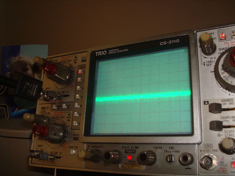

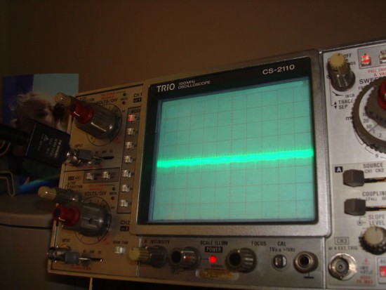

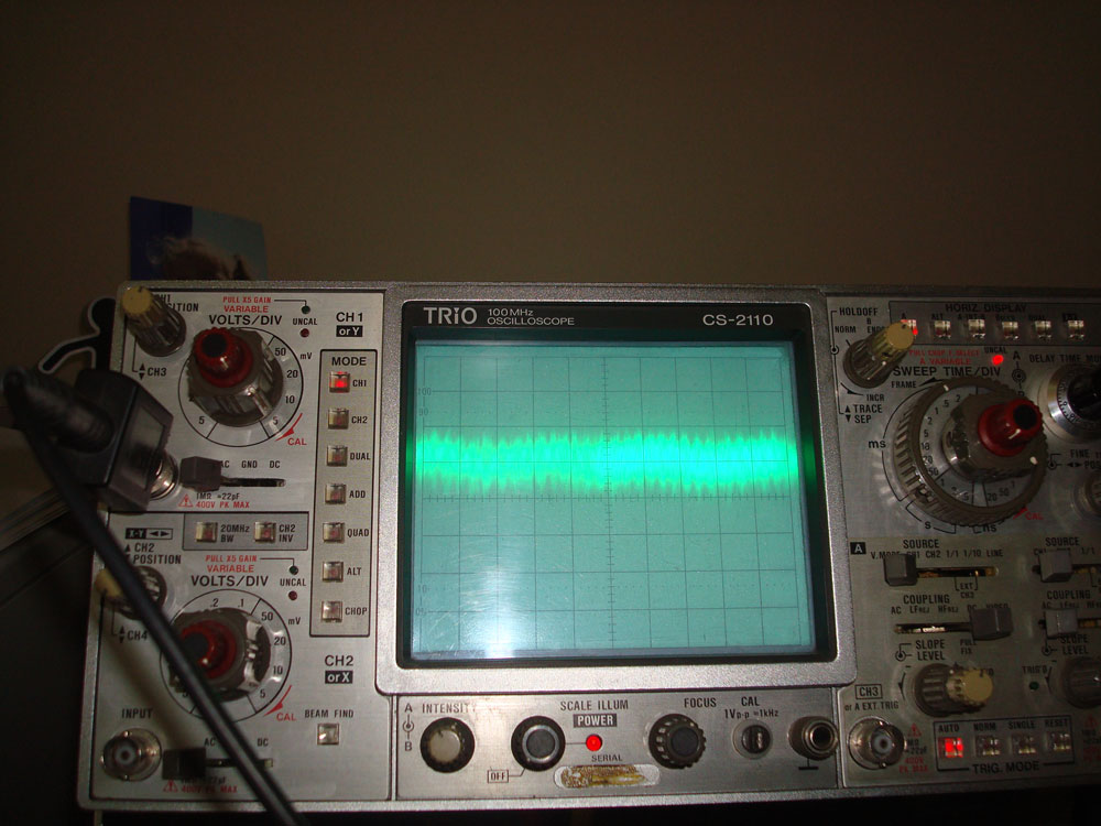

scratchy wrote:
You need to look at single traces of two or three cycles.
Then look at the trace, it should look something like a square waveform.

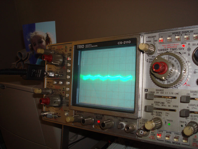

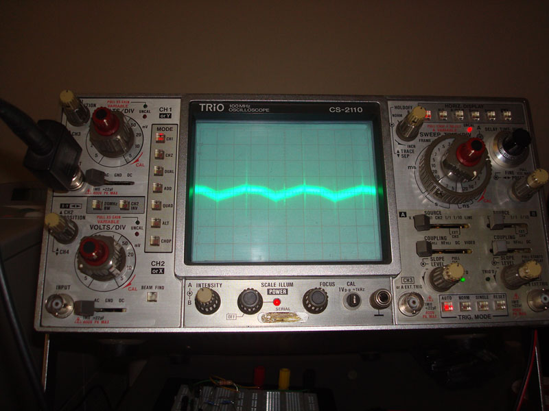

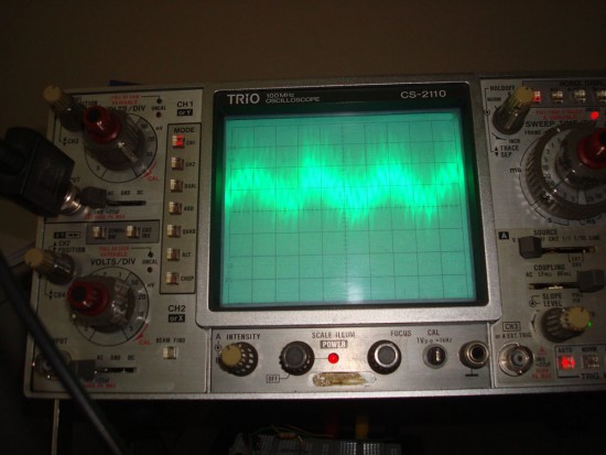

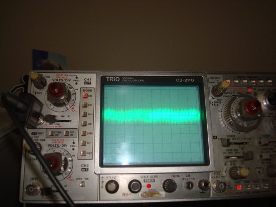

Ok I have had another crack at it. Some pics are time/div zoomed to 5us. Some are 1ms. (check file names)
Both are heavily zoomed on v/div to 5mv (but thats a 10x probe so its really only 0.05v/div).
This was not with a load (or hdd) attached to the molex.
The old PSU picture certainly has some spikes in it (they are a bit faint in the photo).
I assume these spikes are the bad things, though in reality the biggest spike was 4 divisions, so only 0.02v....
Thoughts?

File comment: 5v rail
New PSU
Time/Div = 1ms
Volt/Div = 0.05
This was as close as I could get to making it display anything near a squareish wave?
New PSU
Time/Div = 1us
Volt/Div = 0.05
Old PSU
Time/Div = 1ms
Volt/Div = 0.05
Old PSU
Time/Div = 1us
Volt/Div = 0.05
Those spikes go all the way to the top of the screen - just.
