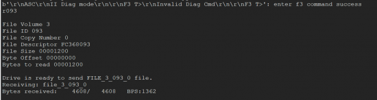

Hi~guys.
i am writing a postgraduate thesis focused on seagate firmware and i have developed a F3 tool to reading sysfile of Seagate ST3500418AS .
i do not understand the relationship with sysfile and ATA module. :roll:
how can i get the ATA module of Seagate ST3500418AS ?
if anyone can help me ,thanks a lot.
File comment: my f3 tool

ATA Module is In Older Classic Pre F3 Drives Not F3 Drives
In terminal at level '1' command 's'.
You must first enable DITS and get modules using DITS:0x144.
More info in 'F3 Serial Port Diagnostics' and 'F3 Diagnostic Functions Manual'.
