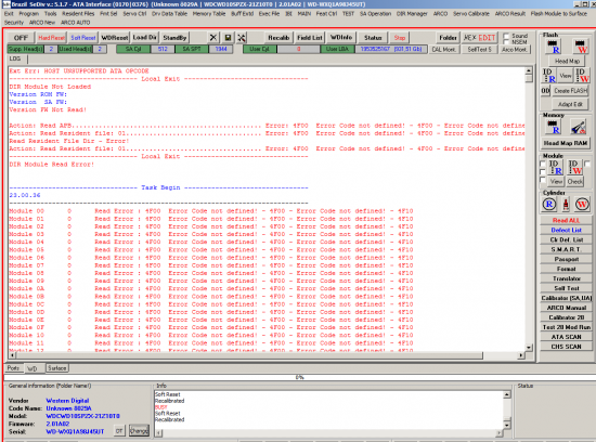

Hi, I'm new to the forum and I have some questions and would like to know if you can help me?
Estou com esse erro esse erro da imagem e não consigo fazer nada com o hd no sediv.

Palmer Lock.
Need unlock PCB.

Not.
Оnly buy unlocked PCB.
https://www.donordrives.com/unlocked-wd ... drive.html
Or.
Sediv possible if find an unlocked board for a while to unlock your own.

Alas.
Without an unlocked board, no matter how.
Already having an unlocked board, you can unlock your own.
You can contact someone who has such an unlocked board and he will unlock yours.
Moreover, he can unlock such a board only a few times. Then he will have to buy a new one.

renatofls,
In the beginning, you need an unlocked board.
With her help, you can unlock your board.
Аnd not otherwise.
