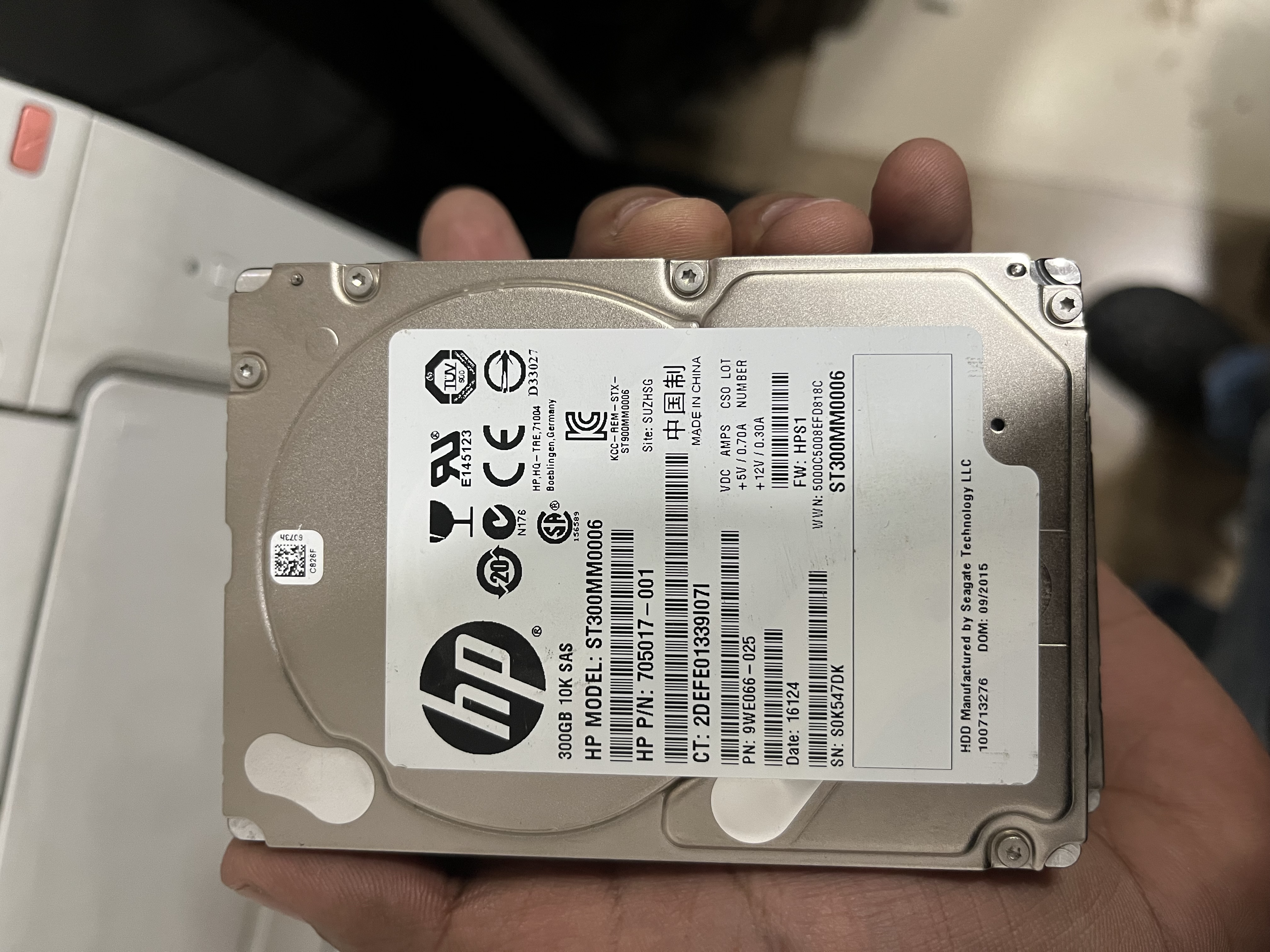

im looking for hp branded seagate hdd firmware for model number ST300MM0006 Firmware HPS1

Well,
what is the issue and what are you trying to achieve by this please

I’m looking to make normal Seagate hdd to this specific model since my workstation software is not accepting other firmware

I have many identical Seagate st300mm0006 with 004 firmware installed with sector size 512

Can you dump the vendor specific VPD pages?
You can do this using sg_vpd:
https://linux.die.net/man/8/sg_vpd
This command dumps page 0, which is a list of supported VPD pages.
sudo sg_vpd --page=0 /dev/ice
The above tool is a component of the sg3_utils package:
https://sg.danny.cz/sg/sg3_utils.html
The vendor specific pages are in the range 0xC0 - 0xFF.
You can dump these pages as follows:
sudo sg_vpd --raw --page=nn /dev/ice > VPD_nn.bin
"nn" is the page number. "If a number is given it is assumed to be decimal unless it has a hexadecimal indicator which is either a leading '0x' or a trailing 'h'."

ST300MM0006 = Seagate Savvio 10K.6 300GB, SAS 6Gb/s
Have you already tried to force flashing this?: https://files.hddguru.com/download/Firm ... g-0004.zip
Older Seagates are sometimes not locked or prevent flashing generic fw.
