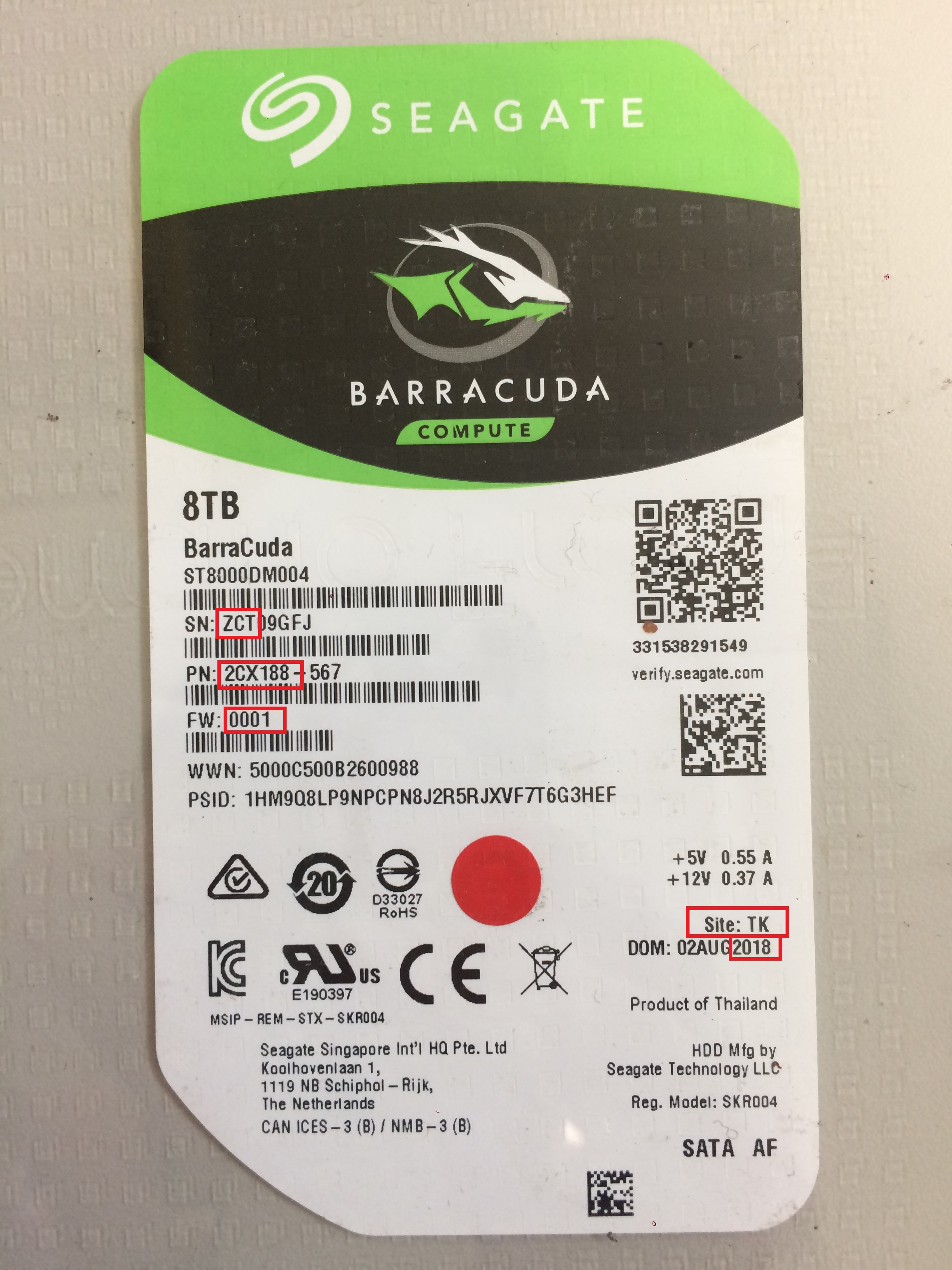

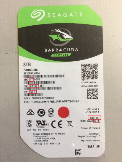

hello Guys i really need a donor for a very important work.
customer need to get data from his passed away relative. sadly i cannot find the right donor here in japan :( :( :( :( :(
if someone got with closer serial, etc i would like to buy :D :D :D
thank you

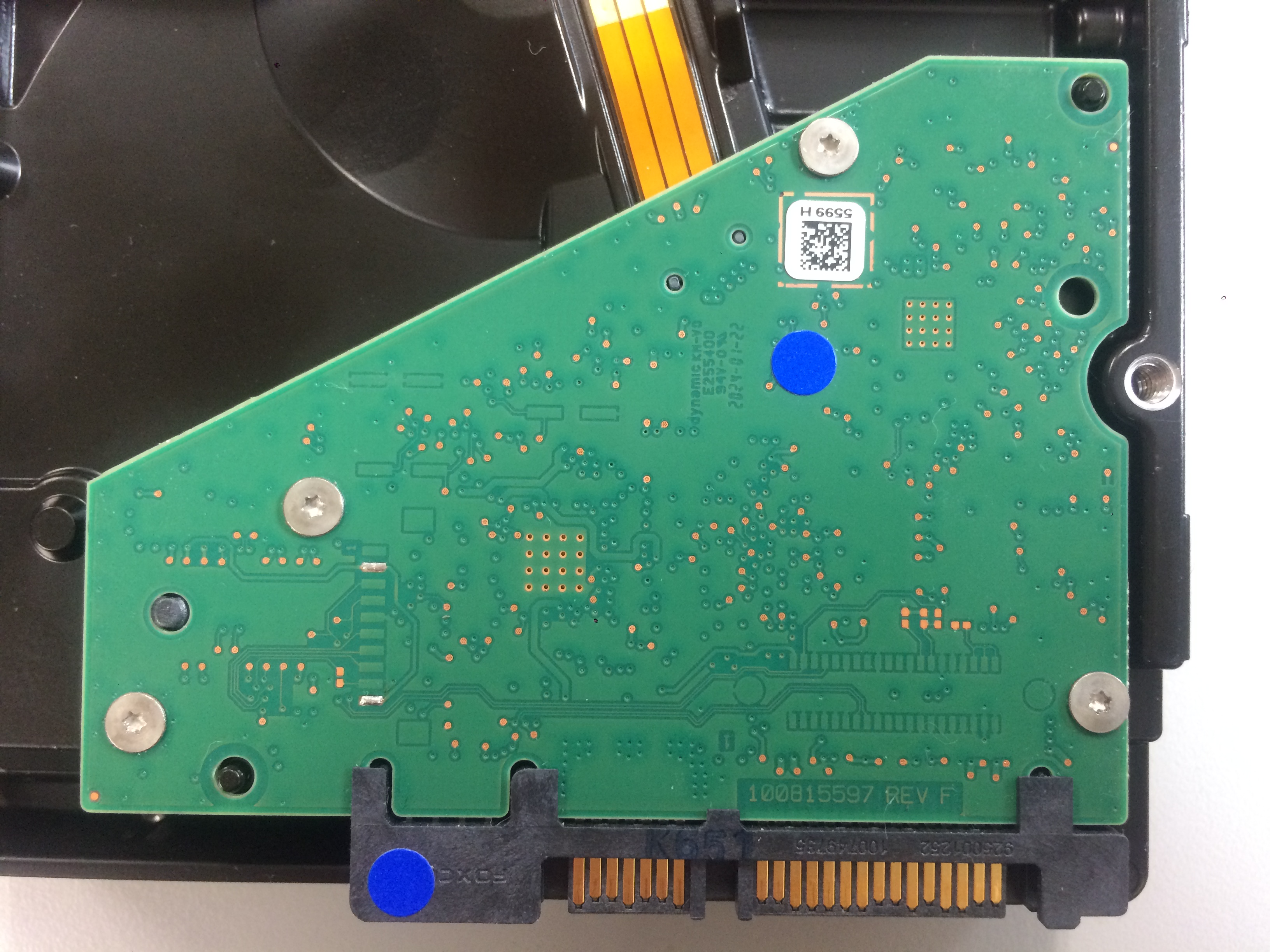

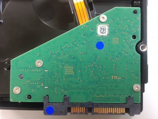

shubhsinghal i have a similar donor but still doesnt accept the heads.
this is the pcb of the Patient

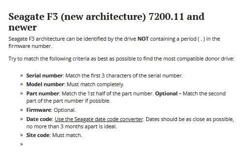

according to this site F3 drivers matching guide

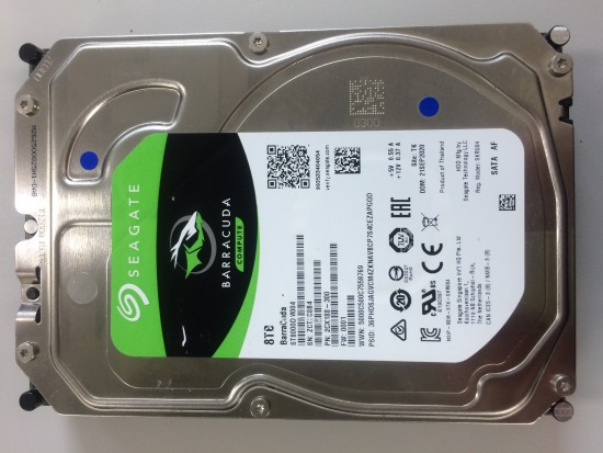

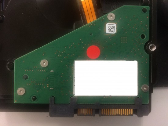

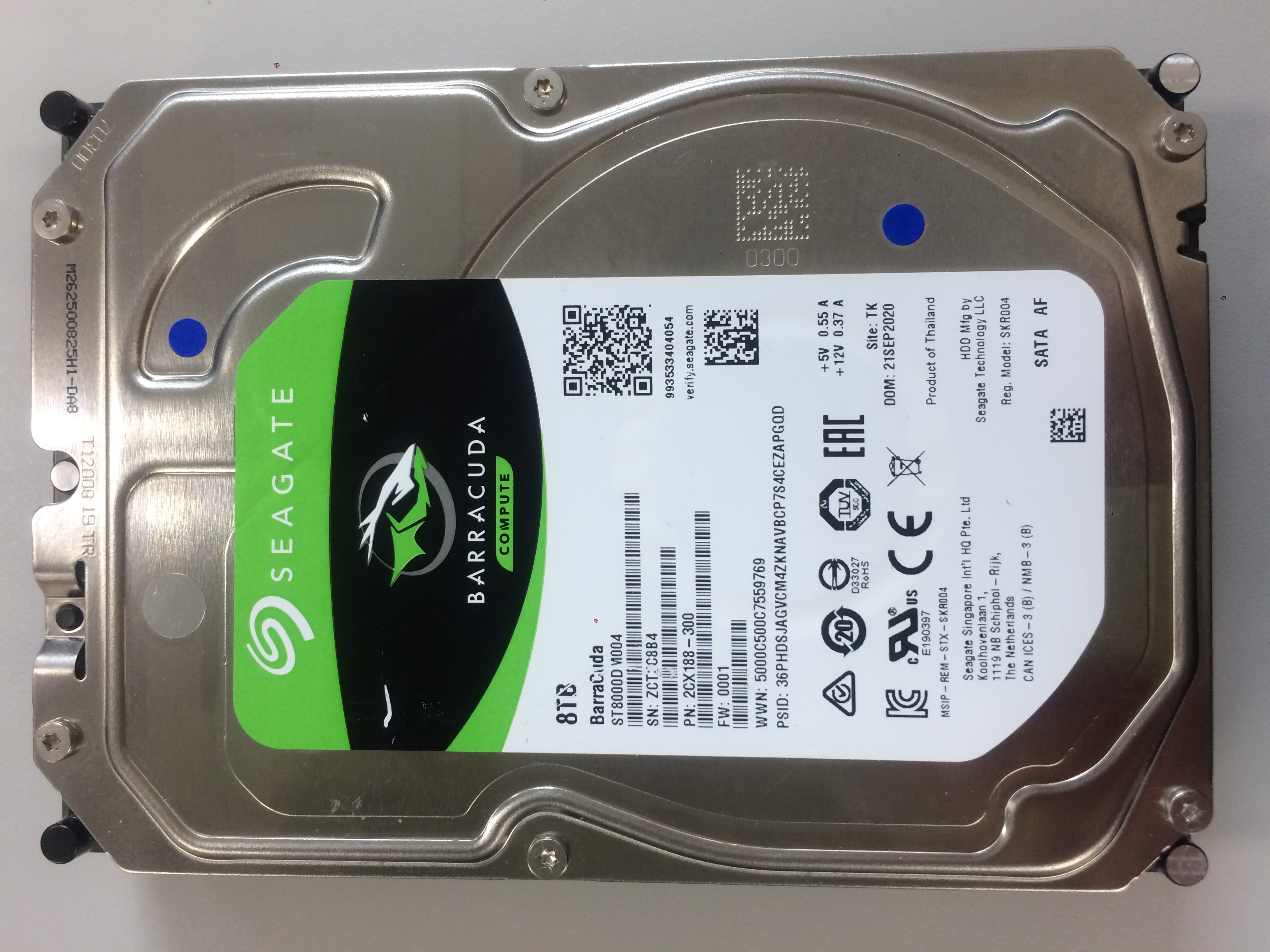

here is one of my DONOR. should be ok but unfortunatelly doesnt work since the year of production is not the same
It matches perfectly with your patient drive. Go for it.
This is extremely strict and most of it doesn't make sense.
