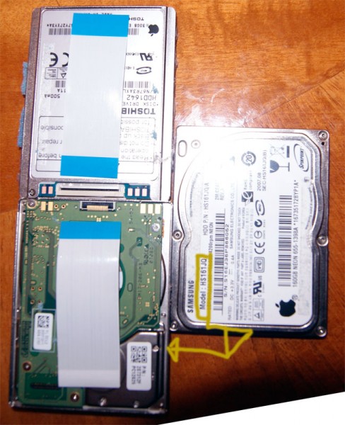

Ah at last!
Its like this is it?
The zif cables are the ones you can buy everywhere for like the 1.8" Toshiba Apple drives or another.
Please notice this Samsung is almost 1/3 of the size and its CE technology.
Thanks.

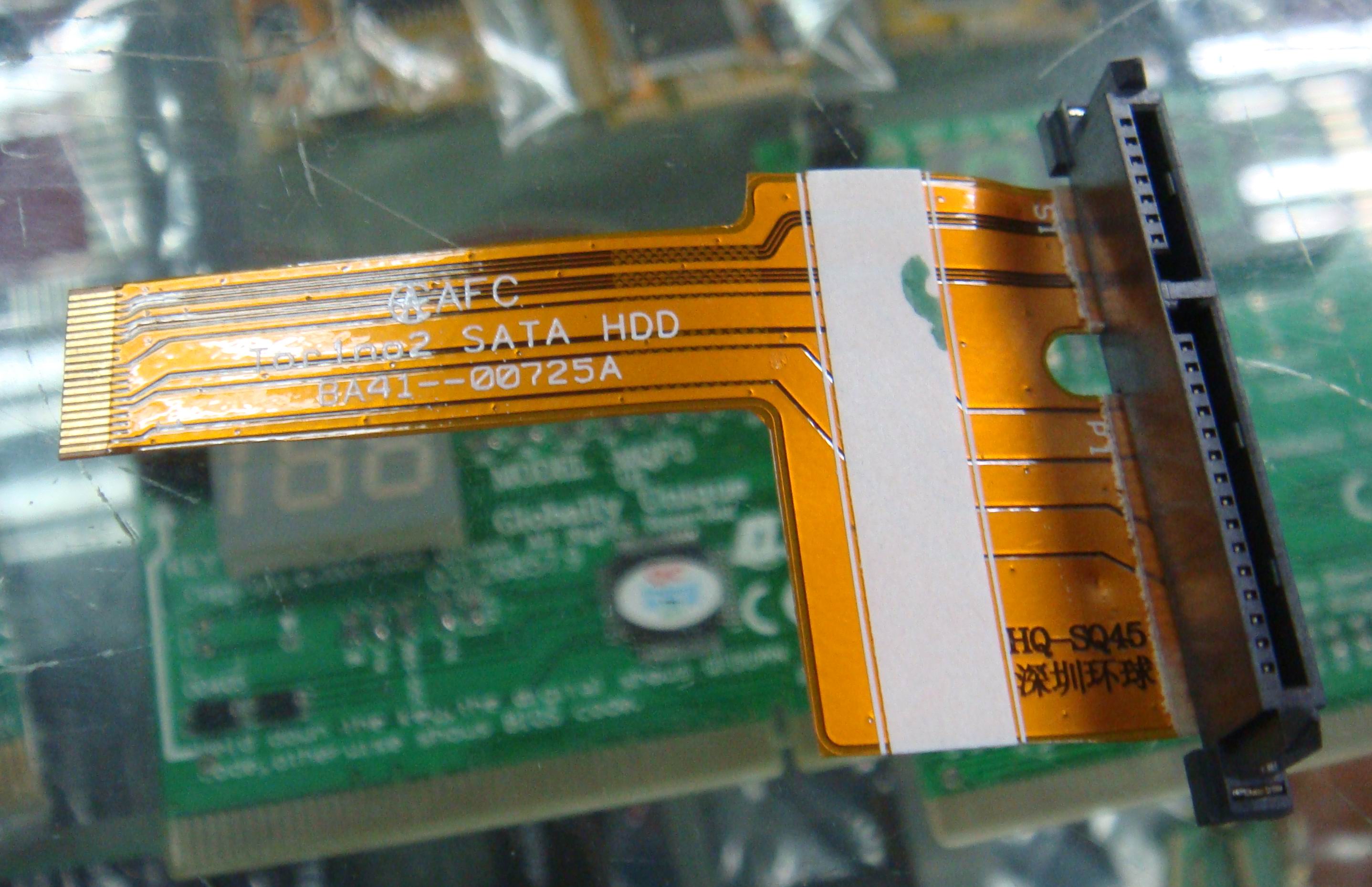

Hey ppumkin - is that what you need (see attached photo)
Ahh thanks Mate!!
PS Its not MMC- its actually sata..
Good tip anonymous!
PS This forum is da bomb with help!
Thanks for the help...
If you need one pm me.

 Post subject: Re: ATA Convertor
PostPosted: October 1st, 2010, 10:31
Posts: 3235
Location: USA
I do not think this is accurate
PostPosted: October 1st, 2010, 10:43
Joined: May 7th, 2010, 13:20
Posts: 595
Location: United Kindgom
What is not accurate- the MMC part or the SATA part.
Or both?
Do you have the pinouts for YPM09657 Marvel chip?
Free Solutions
PostPosted: October 1st, 2010, 11:07
Posts: 3235
Location: USA
The SATA part. Samsung's data sheet clearly states that hs161jq has a CE-ATA interface which is based on MMC. That said, there is a think-outside-the-box solution that does not require adapters at all...

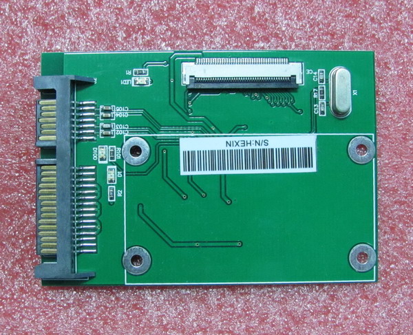

that's ZIF ATA/100 if you got an IPod replace the drive , IPod usb connection works as ATA convertor .
you might need a $20 micro sata => normal sata depending on your recovery case .
Those ZIF connectors on pcb are mostly designed for max 15 time connect/disconnect.
PostPosted: October 1st, 2010, 14:20
Joined: October 20th, 2009, 18:25

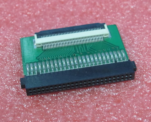

Posts: 58
Location: Tehran/Iran
if you got the drive orginal ZIF cable then its only a 5$ convertor
http://www.drivestar.org/product/converter/converter.htm
PostPosted: October 1st, 2010, 14:53
Posts: 3235
Location: USA
That is for regular ZIF. CE-ATA is different.
