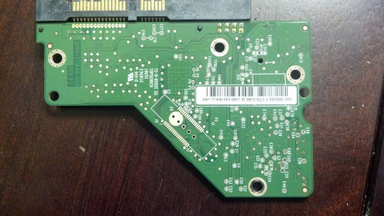

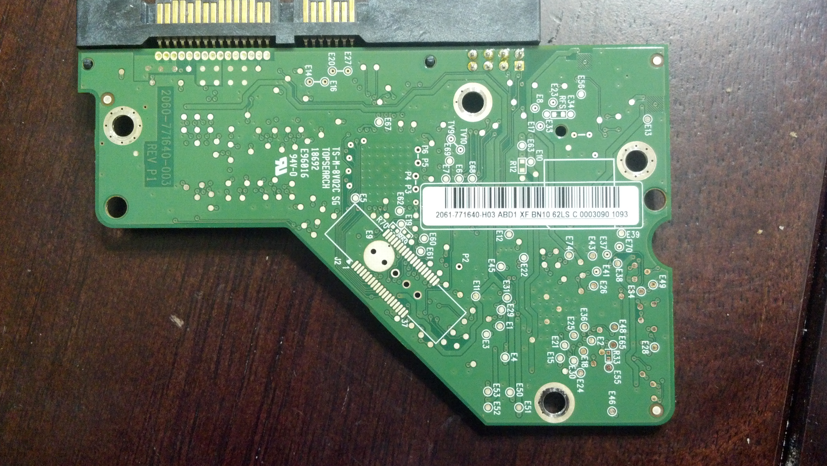

Drive just up and stopped working. No sounds, anything. Absolutely no power gets to drive, thinking its gotta be the PCB. Nothing on it looks bad, scorched or broken but just one day - nothing.

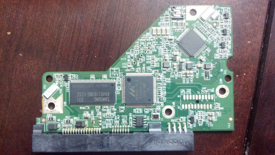

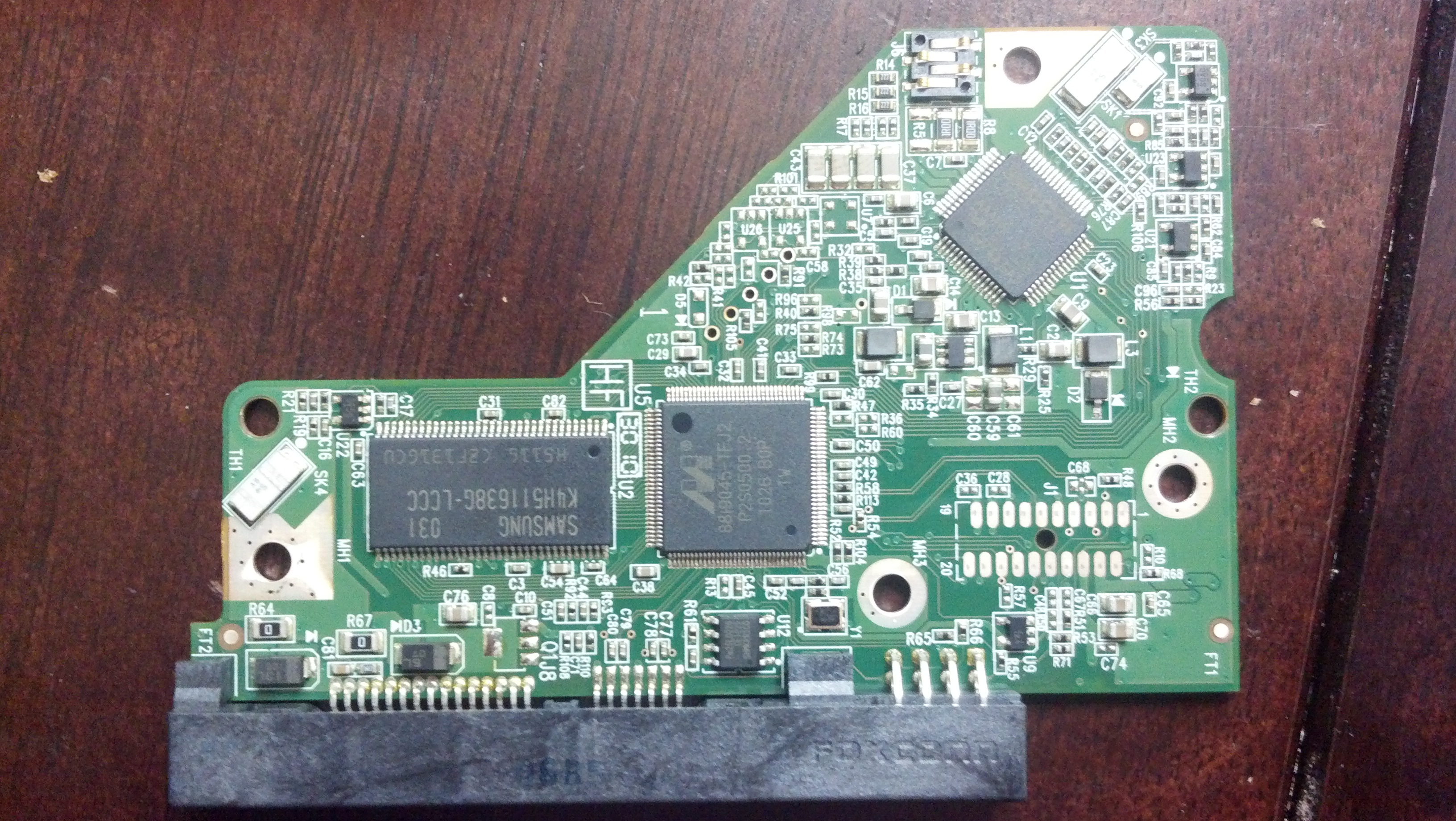

Check PCB first for TVS problems. (search this forum)
Then post pic of board (component side) here

You can't just replace the board, there is adaptive ROM information that needs to be transferred.
As I remember there are two versions of the 771640 PCB, one with external ROM and one with masked internal ROM. Hence the pic request.

Hopefully its not the internal. Its manufactured from like sept 2010, so hopefully that helps.

Also, I noticed this PRINTED on the board, NOT on the white label (The white label code is the one I listed above, I see this one differs)
2060-771640-003 REV P1

As pointed, this pcb contains an external rom chip which needs to be transfered to new pcb.
Be careful when doing the transfer and if you're not too skilled with soldering work, give it to someone who is (ie. a pro). If you screw things up with soldering, things can go really nasty.

Yep, ROM is at U12 near the bottom of the first pic.
As northwind says, make sure whoever swaps the chip is 100% confident of their de-solder and resolder skills. Any mistake there could prove VERY costly.
