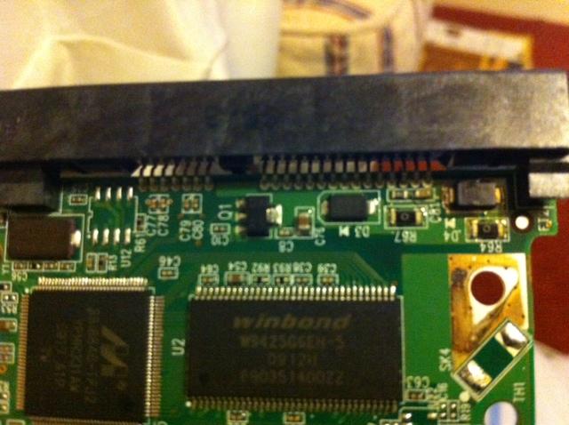

I would please love a bit of help. I smoked out my PCB after I plugged in a DC rather an AC. There was no smell from the Drive as it comes on and shows as drive connected on OS but I cannot access it. After a few consultations with almost 5 specialists, I was told to get.a replacement board but unfortunately I cannot seem to find either the HDD as they no longer manufacture it nor the PCB, which then led me to this forum. The HDD in question is detailed below,

Thanks for the swift reply and sorry for the confusing state of things. Let me be much clearer that there are 2 HDD's in question. The first one happens to be a samsung 500GB model (HD501LJ) date (03/2007), PCB (BF41-00133A Trident 11-RE Rev06). This hard drive shows on the OS without any access. It powers with the casing but totally quiet and not happen to be spinning either.
The second hard drive is a western digital (WD10EADS) date (31/may/2009) PCB (2060-701590-000 REVA). Now this hard drive had a funny smell when wrong power source was plugged in. Opening it up and removing the PCB, the diode close to the connector on the right hand corner (picture attached) looks burnt. This is where my reasearch came in that it was the diode that needed replacement.
Picture attached. So sorry for the confusion :)
File comment: The burnt diode shown on the top right hand side

The problem could be as simple as a shorted TVS diode, in which case just remove it and make sure you don't overvolt your drive again.
See http://www.users.on.net/~fzabkar/HDD/TVS_diode_FAQ.html.
The same goes for the Samsung. There are several TVS diode photo clips here:
With any luck, the whole exerecise should cost you nothing.

Thank you guys for your input fortunately, I was able to retrieve the files after removing the "TVR" diode which shunted the circuit board and I have there fore replaced it not the drives are as good as new. And to @fzabkar the link you provided was of a huge help understanding those diodes.
I guess I just saved myself 400 quid of data extraction
