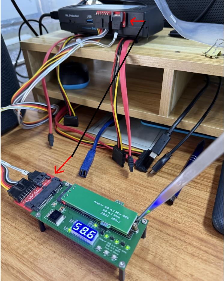

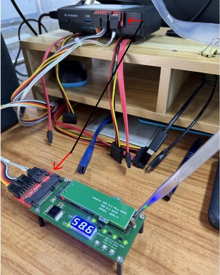

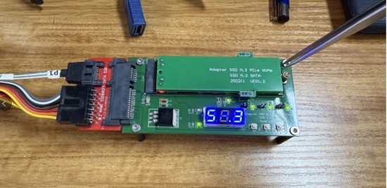

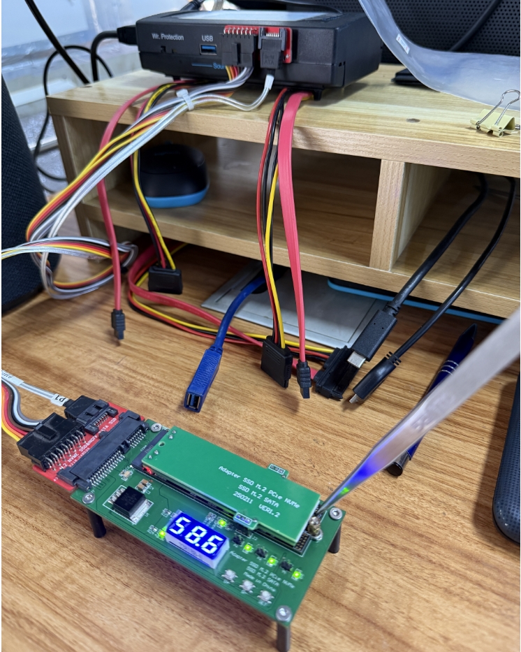

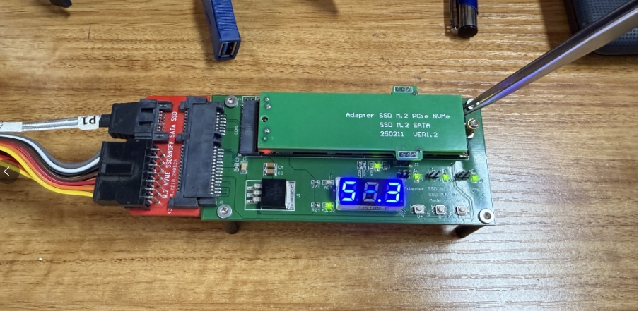

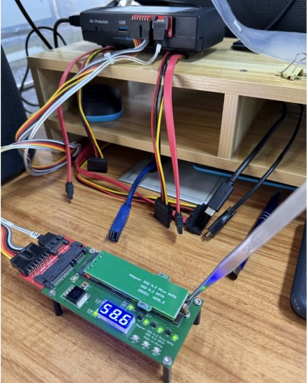

Application Scenario 1: For disks with a lot of black spots in the image, heat them up to 80-100 degrees after mirroring and replenish the part of the black block that has not been read out (this is effective for most SSD disks).
2: For some Protable III unsupported host controller, disk that can't load LDR virtual compiler, long busy SSD disk, heat the disk to 100 degrees first, about 30-40 minutes to refresh the ID or power off to refresh the ID. About 30% of the disks can be mirrored.
3: For SSDs with bad core power supply, you can fly a 1.0v, 1.2v, 1.8v cable to the hard disk.
Contact me if you are interested

What's the temperature range of the device....Also what's the safe max temperature to avoid burning the peltier element?

The maximum temperature of the adapter is 110 degrees Celsius. After testing, the best effect is found at 70-100 degrees Celsius.

I want an extension, I need to do exactly what he did in the picture. PC3000 on a shelf and the adapter away from it.
