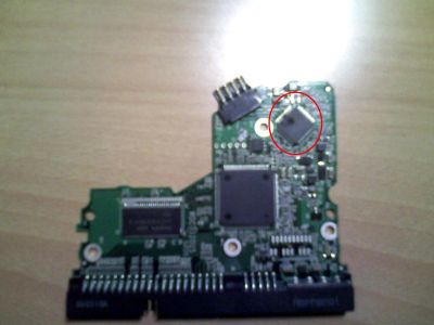

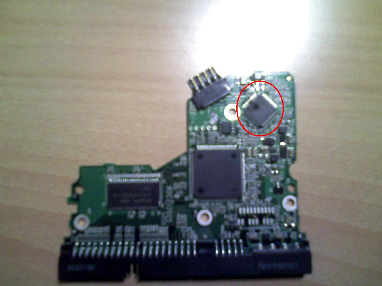

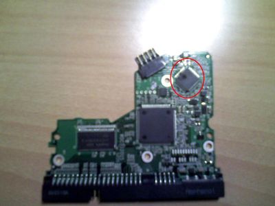

Hi to all. Something happened with the HDD and I need to change the PCB. The details of the HDD are
WD2500BB-00RDA0
DATE: 06 APR 2006
DCM: D8BHCTJAH
PCB: 2061-701292-B00 AA XW 3D03 1RY3 9 0007400 6407
I would appreciate your expert opinions on my problem.
Thank you in advance
 Post subject: Re: PCB for WD2500BB-00RDA0
PostPosted: July 6th, 2008, 11:51
Posts: 2288
Location: In ur HDD !
Can u see any visible damage with ur pcb ???
PostPosted: July 6th, 2008, 14:00
Joined: July 5th, 2008, 13:04
Yes. An IC has been damaged . I think is the spindle IC.
PostPosted: July 7th, 2008, 18:18
Joined: May 21st, 2007, 16:10
Posts: 1592
Location: Gothenburg/ Sweden
Hi, you're right it's spindle motor IC.
And next to it you'll find the 8 legged chip you need to desolder and resolder to the new Pcb you have to buy.
And that Pcb should have the same numbers (2061-701292) on it.
Search for burnt Pcb on the forum, and you get a lot of help.
Regards/ Bosse
http://www.rescue-it.se
PostPosted: July 8th, 2008, 15:48
Posts: 2288
Most of the times i have seen when this component burns it also damages the fuse R120 , Diode , and one of the transistors , Check them before changing the controller .
