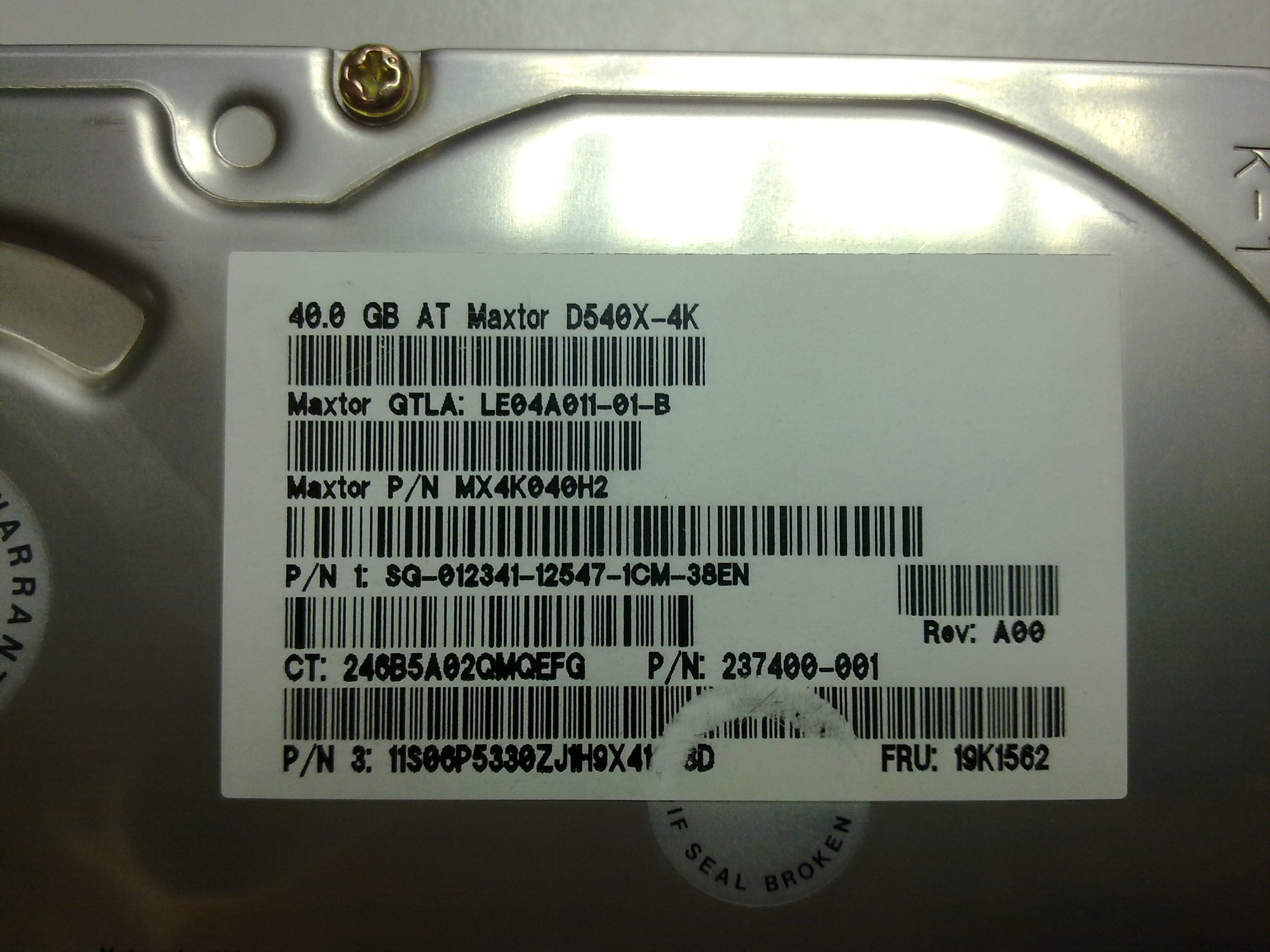

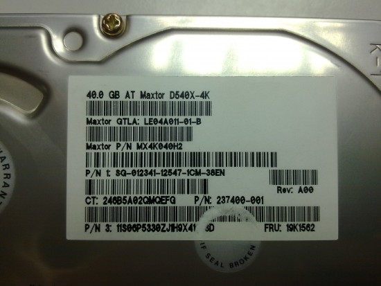

Here is a picture of drive label so if someone have a idea or thinks that it can handle with hd doctor for maxtor...

 Post subject: Re: FW for Maxtor D540X-4K Please!!!
PostPosted: September 22nd, 2010, 6:15
Posts: 1729
einstein9 wrote:
I have no SD maxtor doctor, but i am quite sure it is not supported, because this drive is quantum technology, and the FW is quantum structure inside.Completely different than the diamondmax series....
Agree with Mr.Janos. This Quantum has a different FW structure inside, so the SD doctor for Maxtor can not deal with it.
PostPosted: September 22nd, 2010, 8:51
Posts: 2854
I GOT THIS: LE04A014-01-B
i have the complete drive here does it help?
PostPosted: September 22nd, 2010, 14:19
Posts: 1466
Location: Europe, Hungary
einstein9 wrote:
This helps only if the original PCB is bad.
Other cases, i don't think so.
Janos
PostPosted: September 23rd, 2010, 0:59
Posts: 1721
This is not supported in SD Tools for Maxtor. Sorry you need other tools in order to deal with this one. Janos is right on this one. You will not fix this with SD tools even if you have FW for it which is impossible in this tool. Sorry.

Thanks for all your post, i am convinced that my hdd doctor will not help in this case, so I'll send it to associate with a pc3k
maybe he can tries something i do not want to destroy the data of my customers...
There is a strong possibility as Janos said that the heads are defective to...
