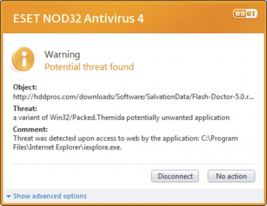

 Post subject: Re: Second hand updates
PostPosted: March 9th, 2011, 8:28
Posts: 256
Location: Turkey
threat found !!!
PostPosted: March 9th, 2011, 11:59
Posts: 411
Location: Romania
It is absolutely normal with Salvationdata exe's...All are detected as viruses...Fals alarm, just ignore it.
Rgds
www.datasave.ro
PostPosted: March 11th, 2011, 14:32
Posts: 1079
Location: canada
the problem is that they use encryption package
which gets picked up by the anti virus saying its malware
its a false alarm
