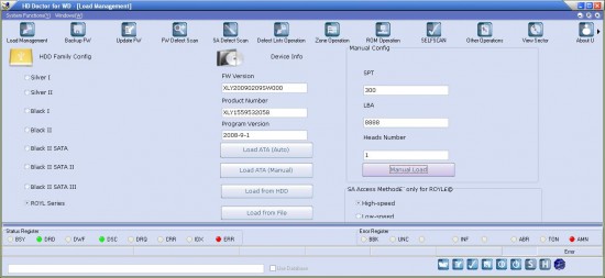

Hello
I connect a WD5000bevt drive an the HD shows busy and after that shows Err
How to repair please
Thx

the status is ready and when i want to load hdd Hd doctor shows the error
help please
 Post subject: Re: error loading hdd
PostPosted: June 19th, 2013, 22:47
Seems like firmware is not read for some reason.
Can you describe the drive's physical behavior after power on?

the drive spin well and there is no strange sound

Let's eliminate the obvious: PCB is native?

yes pcb is native thx for helping

did you try to load in LOW SPEED when it's REAYD?

no mods readed
i also try to load by low speed
