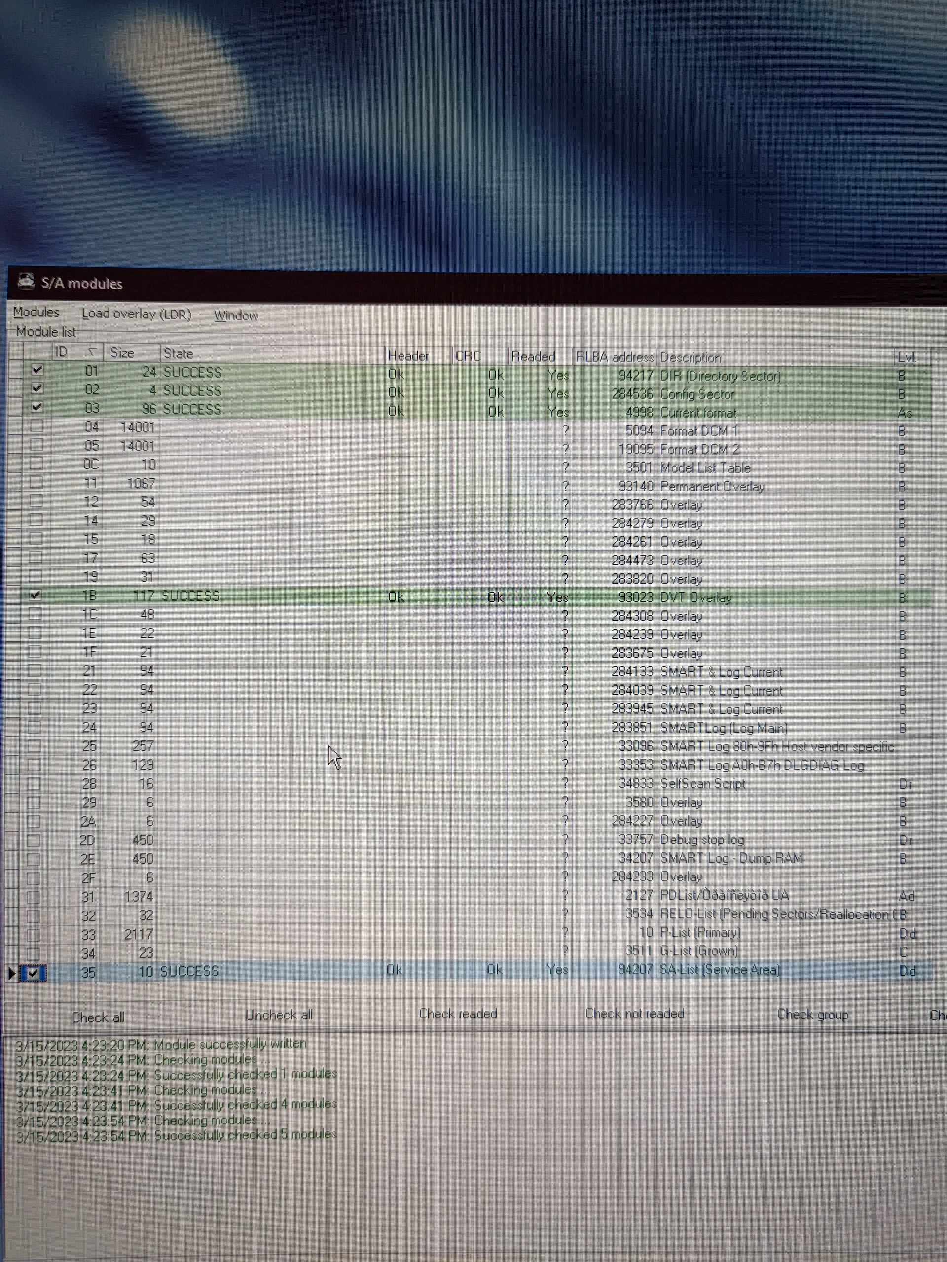

And my next blunders (I know I was wrong on many manipulations, but I was ready to try): I managed to read all the modules, and I found that the ROM version was the same on the SA (so proof that the chip was well flashed).
All modules were recognized except 2: Module 02 and another module but I don't remember which one. I saved everything (ROM+Modules) except the two modules that I could not read (SCSI ERROR). Then based on modules found on a forum, with a serial number close to mine, I downloaded module 2, I modified it based on module 402E of my backup (I think it was 402E...). And I wrote module 2... The disk then disconnected and since then I had a lot of problems in the SA. I spare you all my actions, I tried many things to get to the current state, including a complete SA format in order to try to rewrite the whole SA (many errors in the SA when I tried to read the modules: many bad sectors.
Currently: the disk is recognized but still in the same way with a serial number XYZ. I manage to load in RAM the original modules number 1 (DIR toRAM), number 2 (READ/Write to Ram -> CONFIG-FILE), the two overlays 1B and the second number which escapes me: I push "detect" again and the disk is recognized as originally (serial number good) but just the size remains at 0 GB. And it is several times that I rewrite modules by changing the DIR to write elsewhere on sectors surely more healthy. I manage to put back several modules as seen on the picture below.
However, when I try to see if it stays after a soft reset, the disk locks up again and I have to start all over again by going through the kernel mode.
File comment: Photo
Now you know everything.
So I have two questions:
- Is it already possible to repair this disk while being at this level?
- Is it possible to re-install all the SA at once on another DIR?
I insist that this disk will end up either repaired, or destroyed software-wise, but will not go to a center.
Thanks in advance to those who had the courage to read this long story and who can possibly help me!
PS: english is not my first language like you guess, my apologises if i make wrong shortcuts or use the wrong terms.

Nice to know you did manage to get it working again.
Prior to the big mess up it could had been fixed most likely with a correct copy of module 02 properly uploaded to the disk.
Anyway glad you manage to sort it out.
Yes, you right, if i used the program without USB (USB fucked my upload i think), i guess the prior problem would was solved with this action. But i learnt much in that way !
Thanks for all your messages on that forum who helped me in my case !
