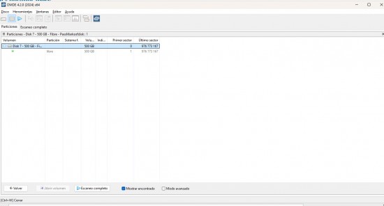

Hi, please if somebody can help me, i need to recover an mbr partition from a disk that was converted to gpt by mistake, I have tried testdisk, but it doesn´t show me anything, as if it was unpartitioned, any other program or technique I could use?

Show us the Partitions tab in DMDE:
https://dmde.com/
 Post subject: Re: Help please - gpt-mbr mess
PostPosted: June 24th, 2026, 12:52
Joined: June 23rd, 2026, 20:16
Posts: 7
Location: Bolivia
https://dmde.com/
it didnt find anything :/

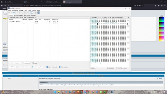

Tick the Advanced Mode checkbox and drag the vertical scrollbar from top to bottom in the right hand pane. Do you see any data?
ok, let me do that now...
PostPosted: June 24th, 2026, 19:39
Posts: 7
Location: Bolivia
none :/

If the disk was converted to GPT, then why is there no GPT metadata?
thats what I´m asking, no gpt or mbr, is there a way to recover old data from there?
PostPosted: June 25th, 2026, 9:31
Posts: 17294
How can you expect to recover anything from an image full of zeros? Even if your drive was TRIM-ed after formatting, it should still have a file system. Your story makes no sense.
