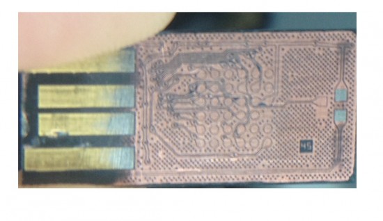

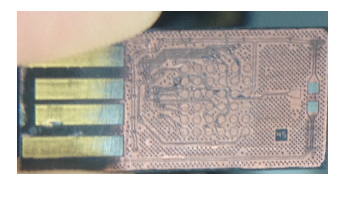

Hello everyone;
I have a monolithic USB PEN DRIVE, it seems that the controller is damaged and i can“t get the dta from it, so i would like to know if there a possibility o recover the data from it. The pictures below shows the type of pen drive that i have. I'm not findinding any kind of way to recover the data from it. Any sugestions?
Thank you very mutch.

Posts: 4000
A DATA Recovery lab can connect to the round pads and attempt to access the NAND directly. It is a common recovery, though success varies.
If you do not own Flash recovery tools, this is not DIY due to the complexity of wear levelling algorithms, DATA whitening and knowing how to successfully dump the NAND in the first place (pinouts, chip config etc.)
If you say your location, a local DR Lab can be suggested.

http://odzyskiwanie-danych.com.pl/image ... arvika.jpg looks same. My pinout should fit.

Yes it is the same. How can i conect it to pc3000. Do you have any suggestion?

You will need a thin wires connected to special Monolith adapter this way
