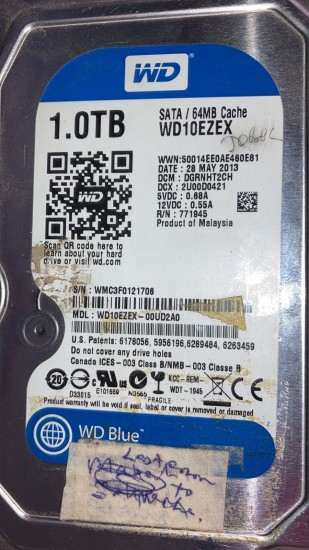

 Post subject: WD10EZEX - Repair Disk Operations - Initializ self test env.
PostPosted: September 1st, 2021, 5:37

at end it give above error - still could not able to Repair the DRIVe.
MRTLAB Tech can you please help to resolve?

Can you upload Rom.bin And PCB number(2060-771945 ?)
