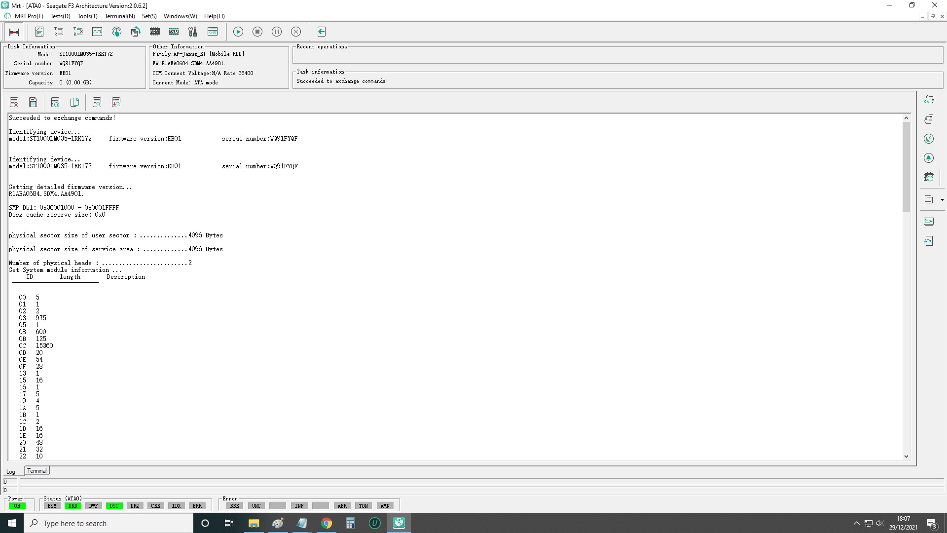

I have problem on ST1000LM035-1RK172 Seagate Mobile HDD , capacity is 0.00Gb :
Already posted in MRT Lab Support Forum website with no response.
1. Hdd is ready, unlocked, SA and hdd resources is saved very well.
2. Unless Sys 28 (translator) copy0 is bad (read error), copy1 is good, so I copied, Sys 28 from 1 to 0, copied done with no error
3. Hdd re-initialized .
3. Problem remain same, 0.00Gb, find in attachment
Anybody can help .
Many thanks.
File comment: 0.00Gb

Check if Sys 28 checksum is ok. If not fix it.

Send me sys28. I might be able to help.

Thanks for support anyway, my problem solved, the correct firmware donor head saved hdd life.
