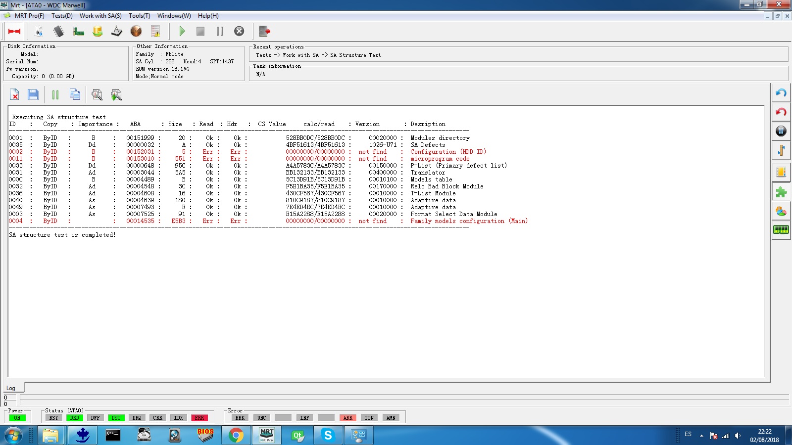

I have this hard drive and it gives me the faults that I attach to the image.
It's almost certainly software problem.
But I do not know how to reconstruct the module 0x02.
Thank you.

See modules 0x802F or 0x802E.

Those modules sometimes contain copies of module 02. However, in your case they are empty. Can you reconstruct your damaged modules from the good sectors of each copy? Otherwise you should be able to use resources from a donor.

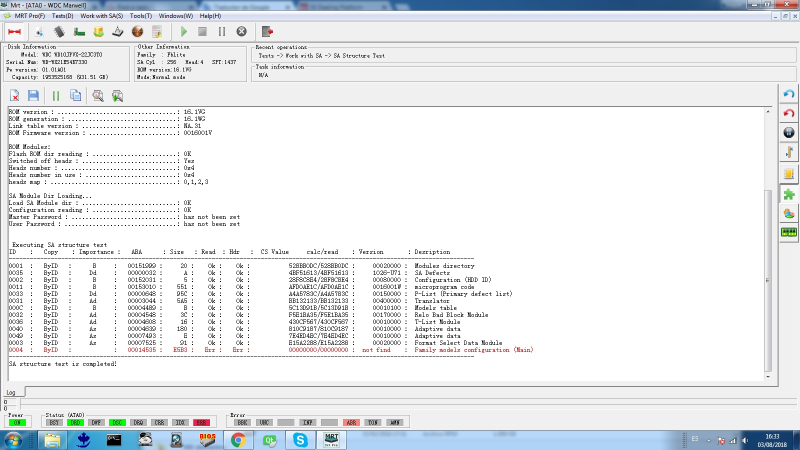

Now the disk has been unable to read the modules 0x11 and 0x04.
I think that's why when I sign in for ABA or for TRACK it does not read anything.
It could be that he does not read the module 0x04 due to a failure in reading the module 0x11, now I think I should find a compatible 0x11 module, but I never get it, unless it is read from the same disk.

How can you know the firmware version of the disk?
 Post subject: Re: wd10jpvx-22jc3t0 0GB
PostPosted: August 3rd, 2018, 2:29
You can work from ROM version (16.1VG)
PostPosted: August 3rd, 2018, 2:30
http://files.hddguru.com/index.php?acti ... ty/Fblite&

thanks pcimage. I have loaded your module to the first one.
The firmware version of the disk is:
ROM Firmware version: .........................: 0016001V
but I see in the firmware file: "01.01A01", and I do not know what that code is.
Can someone explain it to me.

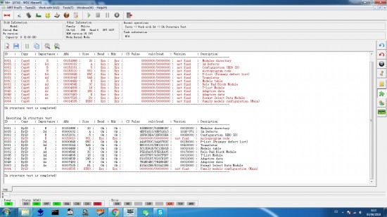

By the way, once the module 0x11 is loaded, I will have access to it by track and by ABA. I have read the module 0x11 per track and I have seen that the entire header is 0x00. I have recorded by track the module that pcimage has given me and the operative disk.
I need to solve the module 0x04 but I have full access to the data and fast.
Thank you very much.

Reading the module 0x04 by ABA reads perfectly. It has the verification of the SA by ID.
