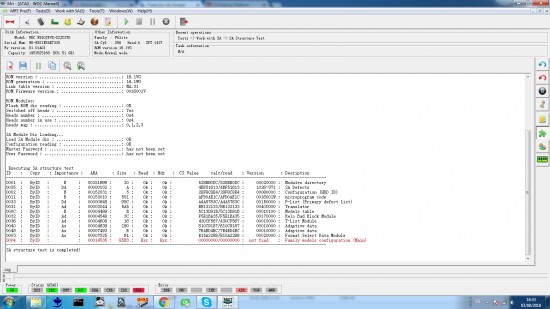

 Post subject: wd10jpvx-22jc3t0 0GB
PostPosted: August 2nd, 2018, 16:26
Posts: 474
Location: spain
I have this hard drive and it gives me the faults that I attach to the image.
It's almost certainly software problem.
But I do not know how to reconstruct the module 0x02.
Thank you.
Nueva imagen de mapa de bits.jpg
Nueva imagen de mapa de bits.jpg [ 294.01 KiB | Viewed 21091 times ]
 Post subject: Re: wd10jpvx-22jc3t0 0GB
PostPosted: August 2nd, 2018, 16:41
Posts: 17215
See modules 0x802F or 0x802E.
 Post subject: Re: wd10jpvx-22jc3t0 0GB
PostPosted: August 2nd, 2018, 17:05
Posts: 474
Location: spain
I have no idea what these modules are for.
I put a copy of them.
Thanks for the reply.
modules.rar [245 Bytes]
Downloaded 909 times
 Post subject: Re: wd10jpvx-22jc3t0 0GB
PostPosted: August 2nd, 2018, 17:19
Posts: 17215
Those modules sometimes contain copies of module 02. However, in your case they are empty. Can you reconstruct your damaged modules from the good sectors of each copy? Otherwise you should be able to use resources from a donor.
 Post subject: Re: wd10jpvx-22jc3t0 0GB
PostPosted: August 2nd, 2018, 17:56
Posts: 474
Location: spain
ok, I'll try and I'll comment on the results.
Thanks for the 2 ideas.
 Post subject: Re: wd10jpvx-22jc3t0 0GB
PostPosted: August 3rd, 2018, 2:20
Posts: 474
Location: spain
Now the disk has been unable to read the modules 0x11 and 0x04.
I think that's why when I sign in for ABA or for TRACK it does not read anything.
It could be that he does not read the module 0x04 due to a failure in reading the module 0x11, now I think I should find a compatible 0x11 module, but I never get it, unless it is read from the same disk.
Nueva imagen de mapa de bits.jpg
Nueva imagen de mapa de bits.jpg [ 439.22 KiB | Viewed 21020 times ]
 Post subject: Re: wd10jpvx-22jc3t0 0GB
PostPosted: August 3rd, 2018, 2:24
Posts: 474
Location: spain
How can you know the firmware version of the disk?
 Post subject: Re: wd10jpvx-22jc3t0 0GB
PostPosted: August 3rd, 2018, 2:29
You can work from ROM version (16.1VG)
 Post subject: Re: wd10jpvx-22jc3t0 0GB
PostPosted: August 3rd, 2018, 2:30
http://files.hddguru.com/index.php?acti ... ty/Fblite&
 Post subject: Re: wd10jpvx-22jc3t0 0GB
PostPosted: August 3rd, 2018, 2:44
Posts: 474
Location: spain
ok, I'm going to try and comment on the result.
 Post subject: Re: wd10jpvx-22jc3t0 0GB
PostPosted: August 3rd, 2018, 10:35
Posts: 474
Location: spain
thanks pcimage. I have loaded your module to the first one.
The firmware version of the disk is:
ROM Firmware version: .........................: 0016001V
but I see in the firmware file: "01.01A01", and I do not know what that code is.
Can someone explain it to me.
By the way, once the module 0x11 is loaded, I will have access to it by track and by ABA. I have read the module 0x11 per track and I have seen that the entire header is 0x00. I have recorded by track the module that pcimage has given me and the operative disk.
I need to solve the module 0x04 but I have full access to the data and fast.
Thank you very much.
Nueva imagen de mapa de bits.jpg
Nueva imagen de mapa de bits.jpg [ 346.03 KiB | Viewed 20977 times ]
 Post subject: Re: wd10jpvx-22jc3t0 0GB
PostPosted: August 3rd, 2018, 11:07
Posts: 474
Location: spain
Reading the module 0x04 by ABA reads perfectly. It has the verification of the SA by ID.
 Post subject: Re: wd10jpvx-22jc3t0 0GB
PostPosted: August 4th, 2018, 3:11
Posts: 474
Location: spain
In the modules 0x11 and 0x1b in offset 0x10 is the firmware version of these microcode modules. To be successful in reading the LDR, the version of these modules must match the ROM firmware version.
You can also use this to know if the ROM has been changed (otherwise the disk modules, but more rare), if you find that the versions do not match.
If I'm wrong, please correct me. This is more of a question.
 Post subject: Re: wd10jpvx-22jc3t0 0GB
PostPosted: August 5th, 2018, 5:10
Posts: 474
Location: spain
What are the CPs ?, I have seen, if I am not mistaken that the TOSHIBA disk is stored in the ROM and I get the impression that a large part of the executable code is stored in the ROM.
As I go forward I am finding a great affinity towards the WD and the TOSHIBA, but personally I see very discolored (under my way of thinking) the SEAGATE discs.
Some conecptos like ZONE TABLE, I have found them by internet I put the link: http://hddscan.com/doc/HDD_Tracks_and_Zones.html
I would like to help, as far as I can, but right now my level is very low.
Greetings.
 Post subject: Re: wd10jpvx-22jc3t0 0GB
PostPosted: August 6th, 2018, 6:59
Posts: 474
Location: spain
Thank you very much.
This link is the best I've found on the net.
 Post subject: Re: wd10jpvx-22jc3t0 0GB
PostPosted: August 7th, 2018, 16:26
Posts: 474
Location: spain
Thanks, I have to read everything in detail it's very interesting and it's the information I'm looking for.
Users browsing this forum: No registered users and 84 guests
