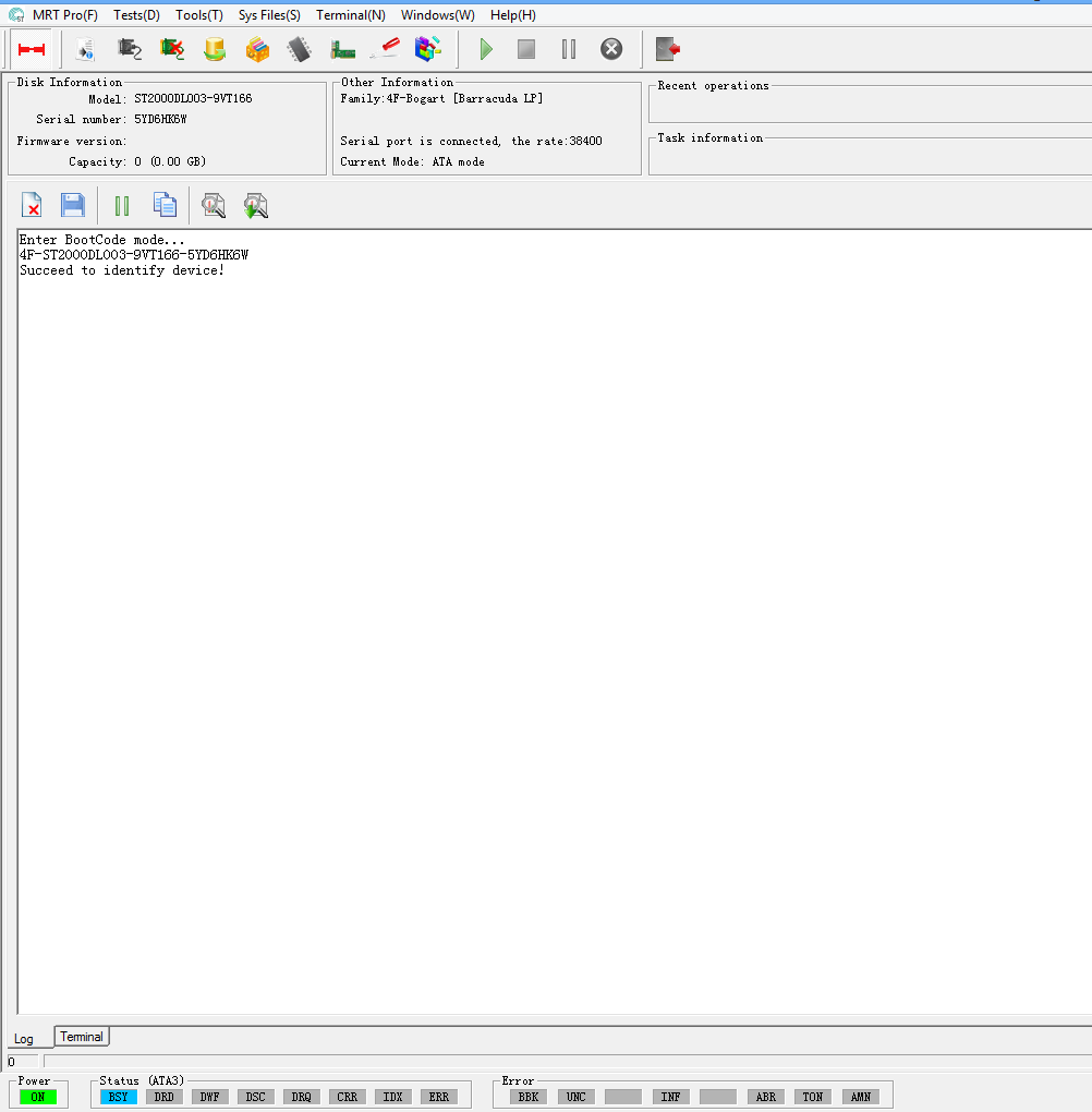

PCB without HDA gives ready state. (Tried with Donor PCB + Patient ROM)
PCB with HDA gives busy mode.
By entering Bootcode mode, Model & Serial Visible with 0.00 GB and no terminal access.
Any suggestions?

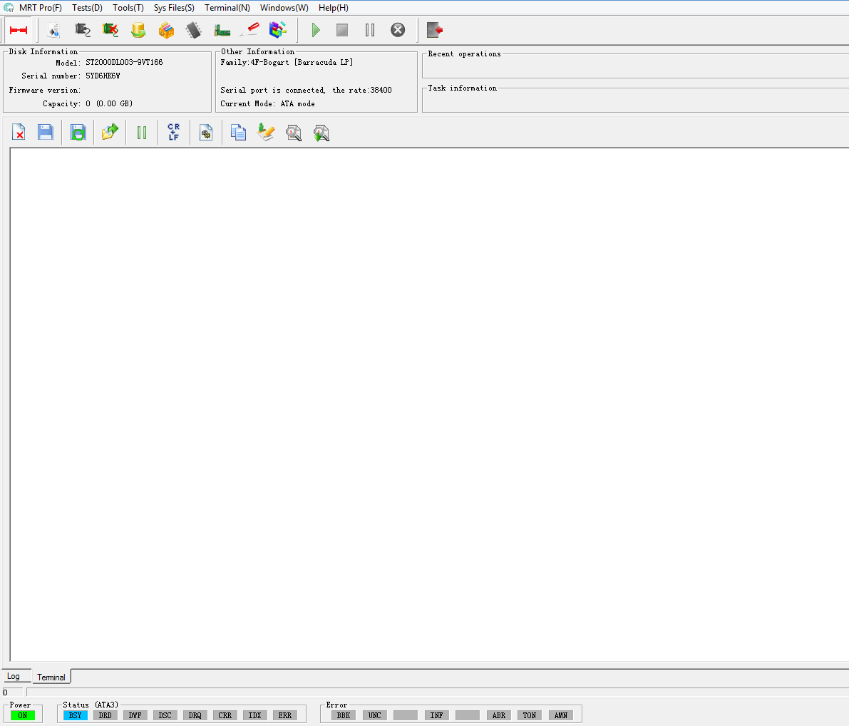

Terminal is total blank. No single output

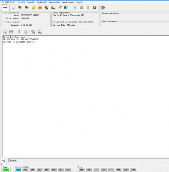

No Spin, No Terminal, Busy Status.
Not able to read system Files as well.

It enters directly into BootCode mode??
Is the ROM original?

Yes ROM is original, Busy State so, only can enter bootcode mode.
