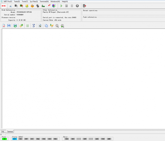

 Post subject: ST2000DL003 2TB Busy, No Spin, No Terminal
PostPosted: October 6th, 2018, 8:28
Joined: September 10th, 2018, 5:48
Posts: 97
PCB without HDA gives ready state. (Tried with Donor PCB + Patient ROM)
PCB with HDA gives busy mode.
By entering Bootcode mode, Model & Serial Visible with 0.00 GB and no terminal access.
Any suggestions?
 Post subject: Re: ST2000DL003 2TB Busy, No Spin, No Terminal
PostPosted: October 6th, 2018, 9:01
You can start by posting the terminal output you're getting when the drive starts up.
 Post subject: Re: ST2000DL003 2TB Busy, No Spin, No Terminal
PostPosted: October 8th, 2018, 3:05
Joined: September 10th, 2018, 5:48
Posts: 97
Terminal is total blank. No single output
 Post subject: Re: ST2000DL003 2TB Busy, No Spin, No Terminal
PostPosted: October 8th, 2018, 4:13
Joined: September 10th, 2018, 5:48
Posts: 97
No Spin, No Terminal, Busy Status.
Not able to read system Files as well.
123.PNG [ 41.01 KiB | Viewed 10014 times ]
122.PNG [ 44.06 KiB | Viewed 10014 times ]
 Post subject: Re: ST2000DL003 2TB Busy, No Spin, No Terminal
PostPosted: October 8th, 2018, 9:03
Joined: July 12th, 2010, 4:38
Posts: 1455
It enters directly into BootCode mode??
Is the ROM original?
ACELab partner
 Post subject: Re: ST2000DL003 2TB Busy, No Spin, No Terminal
PostPosted: October 8th, 2018, 9:31
Joined: September 10th, 2018, 5:48
Posts: 97
Yes ROM is original, Busy State so, only can enter bootcode mode.
Still Pending!!!
Users browsing this forum: No registered users and 103 guests
cron
